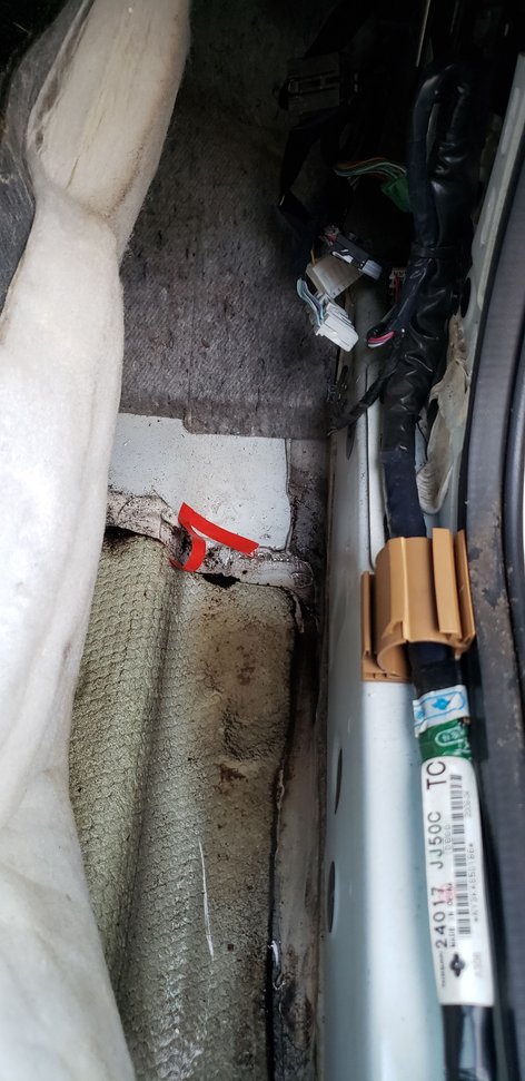

All of the systems being gauges not working, car jerks in in all gears. Starts jerking aT 2500rpm. The car has a really rough hesitation battery drain. I had taken out the ecu and noticed some dry white stuff on the ecu as it looks like water had gotten to it. I lifted up the passenger carpet and it was a puddle of water under there.

I have good news and bad news for you:
• Good news: Your ECU is fine!
• Bad news: Your BCM (body control module) may be damaged from getting wet. (sunroof drain leak)
