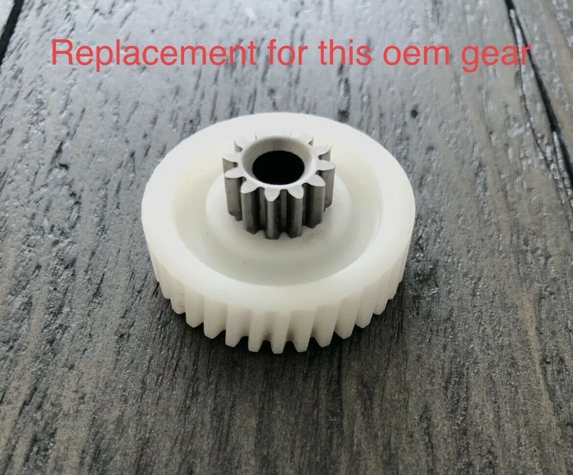

09-15 G37/Q60 Flapper Motor Gears Reverse-Engineered (updated)
Hello guys. I reverse-engineered those flapper motor gears, tested them with more than 100 cycles and now have them for sale. UPDATED: Now they made out of special material, which is way stronger than OEM plastic gears and almost as strong as metal ones. (early models were made of carbon fiber reinforced plastics)
It is a better option than metal gear because if anything go wrong and flap will meet something on its way - there is still a weak point which might break, BUT will save all other parts of this extremely expensive assembly! For reference purposes I'll post complete assemblies part numbers here: 79913-JJ50A, 79913-JJ50B

Nice but, i think that you need to advise that this gear model will fit only on 2009 to 2011 models... if you don't provide the small metal gear. Supplier change the design on 2012 and later models.
So, it wont fit on 2012/2015.

I like the new material even better than the metal gears that Guy has developed. But I agree with Guy that you need to provide the toothed gear on it at the same time in order to support all of the models. In fact I would be as concerned about the longevity of this gear when inserting that metal driver. If you look at the failure mechanism it is in the attachment of the small gear to the larger driver. When a flap hits something unexpectedly there is not any torques shutoff and the gears keep trying to move. The failure point is when the motor keeps turning and the flap is stuck causes this center area to deform. I first thought Guys design was going to be noisy with metal to metal at the worm gear but it has been rock solid. I think the only way to improve would be to figure a way to belt drive this so the belt would slip and not tear the teeth out.

I totaly agree with you, those plastic/carbon gears will probably do the job. And i personaly don't have the knowledge about carbon/plastic printing process to confirm that they will fail for sure somedays. The + is that they certainly cost way less to produce than the metal ones. My concern is related to heat, especially in the southern states where the temperature is very hot almost all year long. But, for sure, they are probably better than the oem cheap plastic gears!
the first drawing of dranik182 was made only for previous models but...seem's he recently design a new one for 2012 and later models..That's very good!
