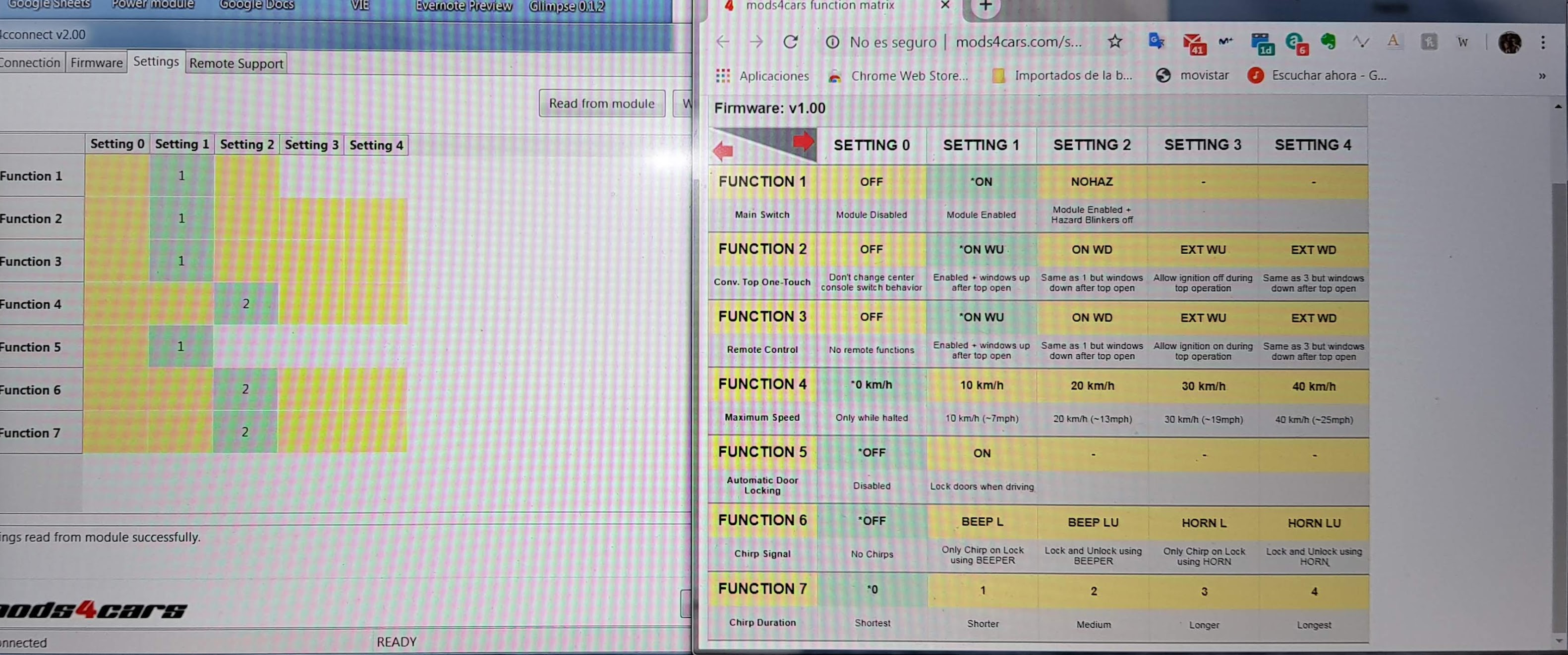

Hi again, I seem to have an issue with my module. Top does never close from remote and windows up require three presses instead of 2. I already opened a ticket with mods4cars. Let's see if it is only SW (or misuse) and I do not need to remove everything again!
Old May 21, 2020 | 09:44 AM
DrCooke's Avatar
DrCooke
Joined: Feb 2020
Posts: 18
OK now. First of all, mods4cars seem to have a helluva customer support. I received answer to my ticket on the same day with some suggestions. I tried them and sent a video back and again they answered immediately asking for a remote session. Funny enough, the guy who reached seemed German, but he was in the US (past midnight for him). We arranged a whatsapp call while I connected my laptop to the module so he could see its guts. He was giving me instructions and checking what was happening. To cut a long story short, everything seemed to be OK, but he told me that for some reason, the "lock" button on our remotes has a high lag compared to the "unlock" button so actually you need a much slower pressing of the button when closing the top (nearly two seconds between clicks). For that reason, even though the car was receiving three signals and actually there were audible clicks in the system, only two were counted. And that only happens with the "lock" button "unlock" has a faster response. He also recommended what Skitzo said. Always start from unlocked. Else, the system might have gone to sleep mode and lock button won't wake it up.

Yea, it seems so. I only need to a.- have it always in unlocked before starting, like u said and b.- have more time between clicks when closing compared to opening. It seems to work so far, though I have not tested much as I do not want to kill the battery and I cannot move the car in these days
