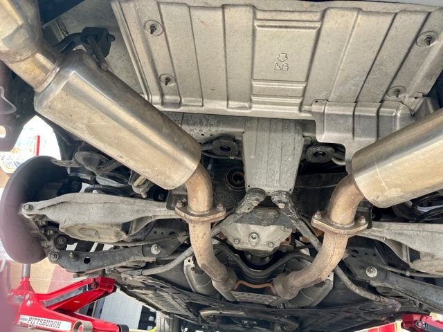

The G came with BC racing Coils, these wheels that are kind of growing on me and an axle back exhaust that's burning the rear bumper.
Not sure if because cheap exhaust or Horrible installation but looks like probably both.
I'm looking for that to be the first thing to go soon as i can scrap up funds for a decent exhaust, hoping i can make the Invidia Q300 Sedan Exhaust fit along with ISR HFCs and some headers..... but i might just stop at the HFCs.

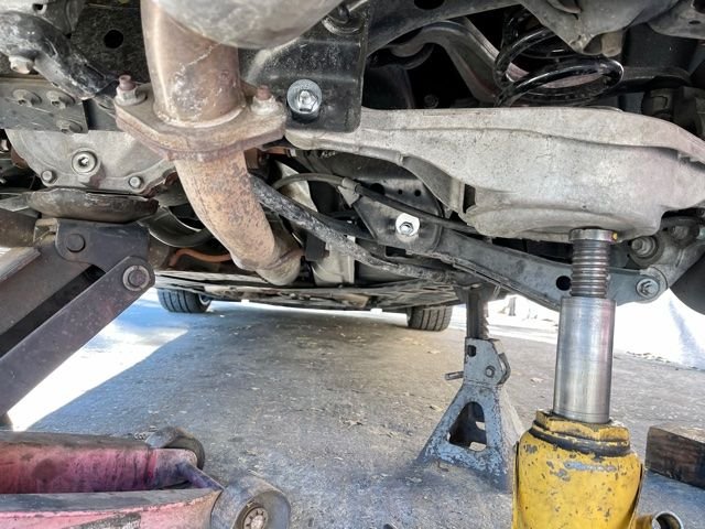

So I figured out I had stock bolts and finally got around to correcting the suspension on my G37 vert that’s lowered on BC coils. Convertible G37s have a different rear suspension set up than coupes and sedans which don’t give us access to any rear adjustable arms. My rear toe and camber was never able to be corrected so I was going through tires fast with that horrible inner wear. The only solution offered on the market for this issue are the SPC 350z/G35 rear camber/toe alignment bolts and they’ve worked out perfectly. 👍🏼
stock bolts
unbolted
comparison
SPC bolted
I removed that tab sticking out on the subframe in case I wanna run more aggressive tires in the future.

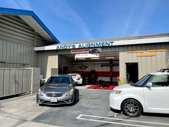

Shout out to Andy’s Alignment located in Burbank, California. They have lowered friendly alignments at an unbeatable rate for sure.
in spec now
best experience ever

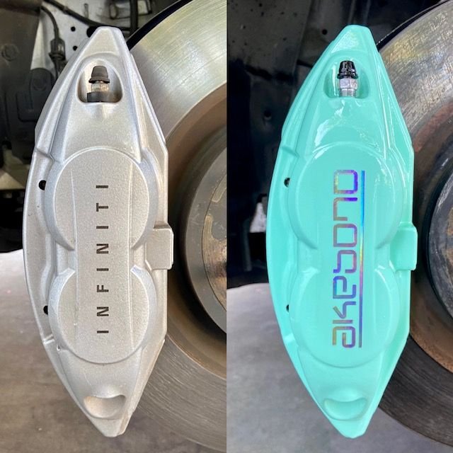

Also got around to getting the brakes painted to match the soul function strut bar I'm impatiently waiting on.

That's an interesting choice of the caliper paint color - definitely stands out.

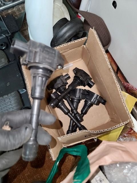

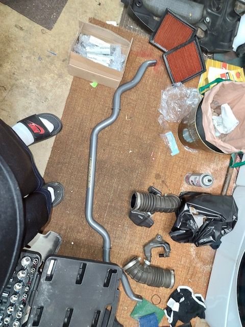

Maintenance work on this thing.

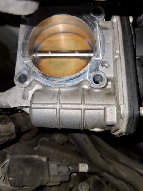

Replaced air filter cleaned MAF sensors and throttle bodies which were crazy dirty.
Replaced ignition coils and spark plugs.
Ignition coils had visible differences but worked out.
The middle coil on the passenger side had oil and the driver side mid and back coil had some oil too so I guess gasket changes coming soon. No oil on spark plugs though, they all looked visibly well.

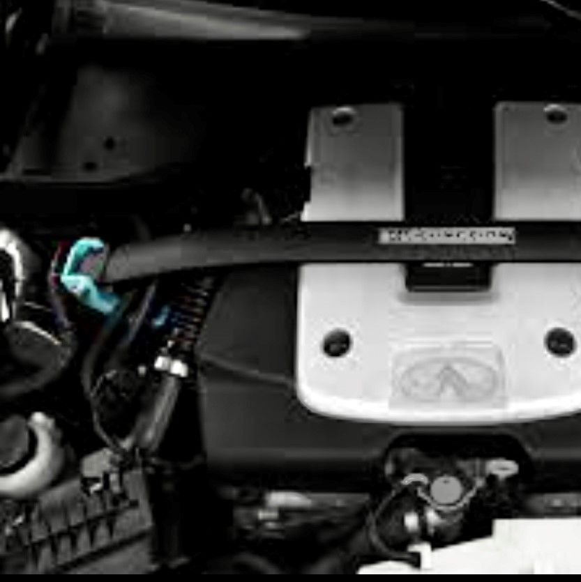

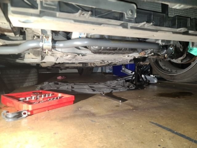

I was also able to add a hotchkis front sway bar to stiffen up the front a bit more.
Then topped the night off with the aluminum heat shield from Z speed. The zerk fittings and shield seemed like a tight fit but hopefully not. 🤷🏻‍♂️
