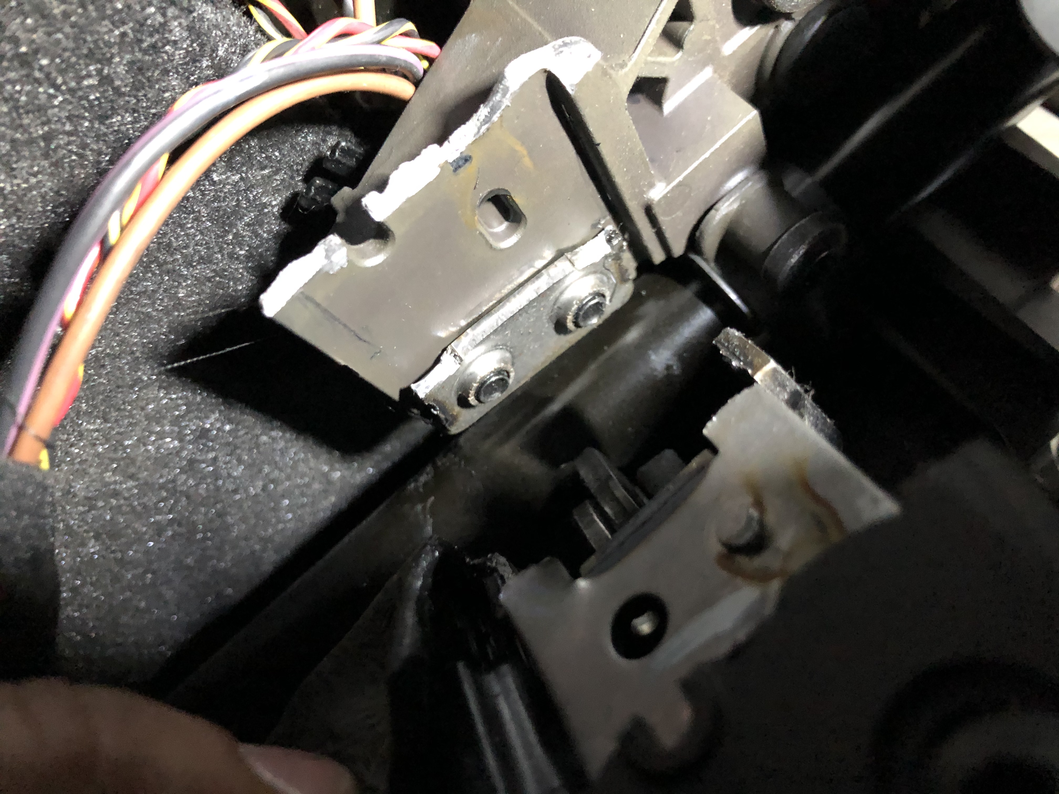

Broken Convertible Aluminium Bracket
Hi guys!
I need your help..
I replaced the plastic gears with Guy’s metal gears and now the flaps work great, but my convertible is still not working.
We realized a aluminium bracket broke when the convertible top got stuck. Is anyone familiar with that part or know the part number/ name so I can search for it? A video and photos of the broken part is below.
Thank you!
Linda
I’ve searched these numbers but nothing comes up.

Old Mar 19, 2021 | 03:30 PM
  #55

Old Mar 19, 2021 | 03:36 PM
  #56
n559br's Avatar
n559br
Joined: Dec 2020
Posts: 94
Likes: 42
That looks like part of the parcel shelf.
Old Mar 20, 2021 | 11:07 AM
  #57
kiseliok's Avatar
kiseliok
G37 Community Team
iTrader: (11)
Joined: Aug 2016
Posts: 1,122
Likes: 169
From: Charlotte, NC
I'm thinking it's part of the parcel shelf - 79910-JJ51A.
https://www.infinitipartsdeal.com/pa...agram=737_A005
If that's the case, that's a pricey part and I wouldn't even know where to start to replace it. :|
Old Mar 20, 2021 | 02:46 PM
  #58
LindaG37's Avatar
LindaG37
Joined: Jan 2021
Posts: 9
Thanks for your response guys!
@teahead I will try to get a better photo of where the bracket is located
@n559br Yes, it’s part of that assembly
@kiseliok Yes, it’s part of the parcel shelf, but I was hoping it would be a case like the gears where I don’t have to replace the entire assembly. I looked at the link you sent and am trying to determine the exact part number

Old Mar 21, 2021 | 09:41 PM
  #59
teahead's Avatar
teahead
Joined: Feb 2019
Posts: 464
Likes: 63
Video not working for me.
Post it on youtube and paste the link here.
This it?
https://www.ebay.com/itm/WILL-NOT-SH...temCondition=4
Please start a new thread in the convertible section so not to muddy the info here on flapper breakage.
