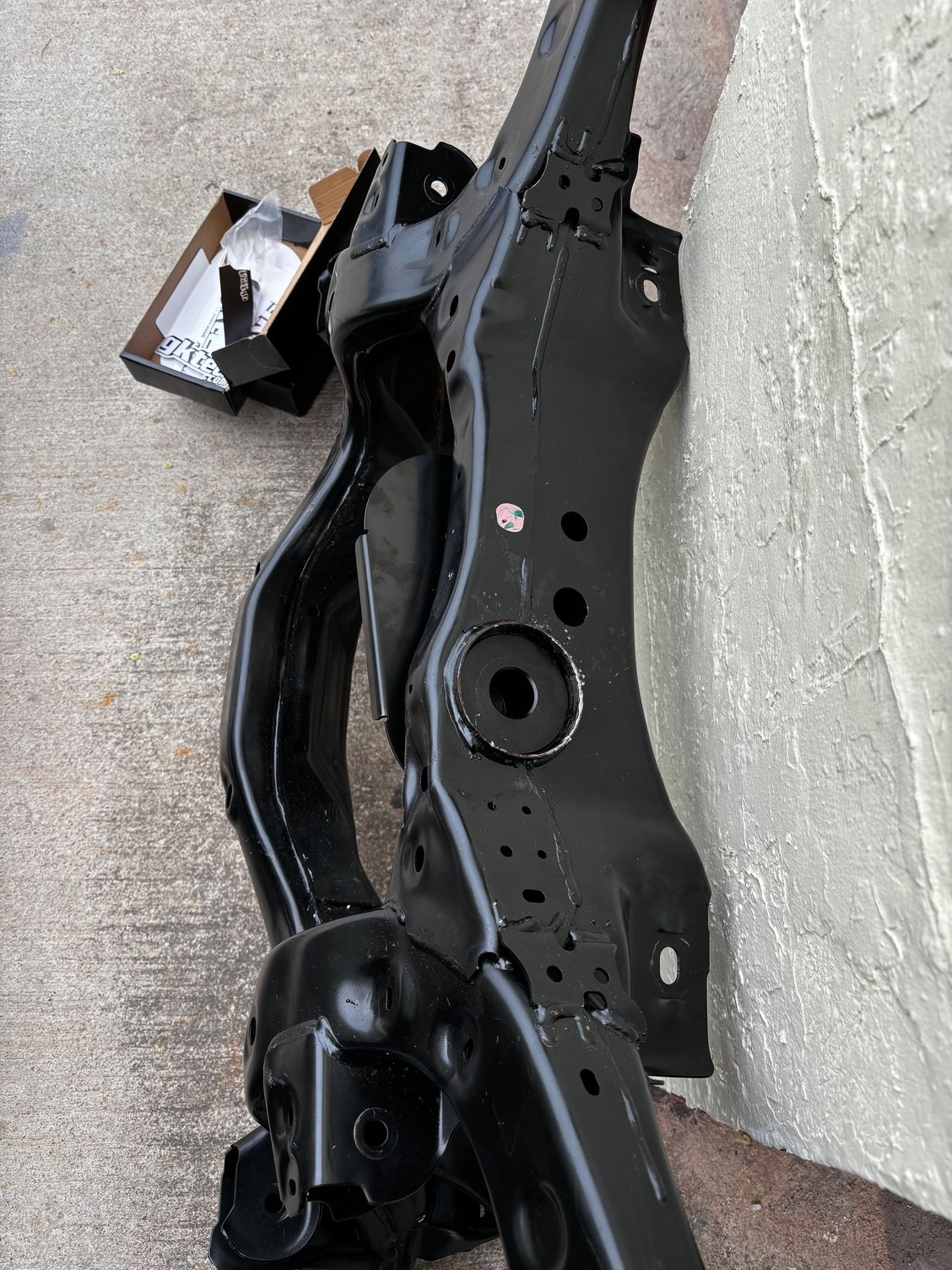

Subframe is out
I figured switching out my urethane diff bushing for a solid one would be the best thing to do to help even out the load on the new cover, and it turns out this I what is recommended by GKTECH.

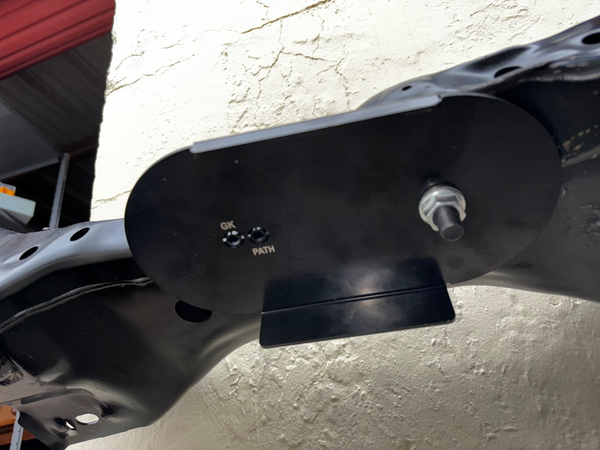

Guide set up
the guide bolts up nicely and I didn’t have any issues with it rotating. Getting it level was a bit of a challenge though.

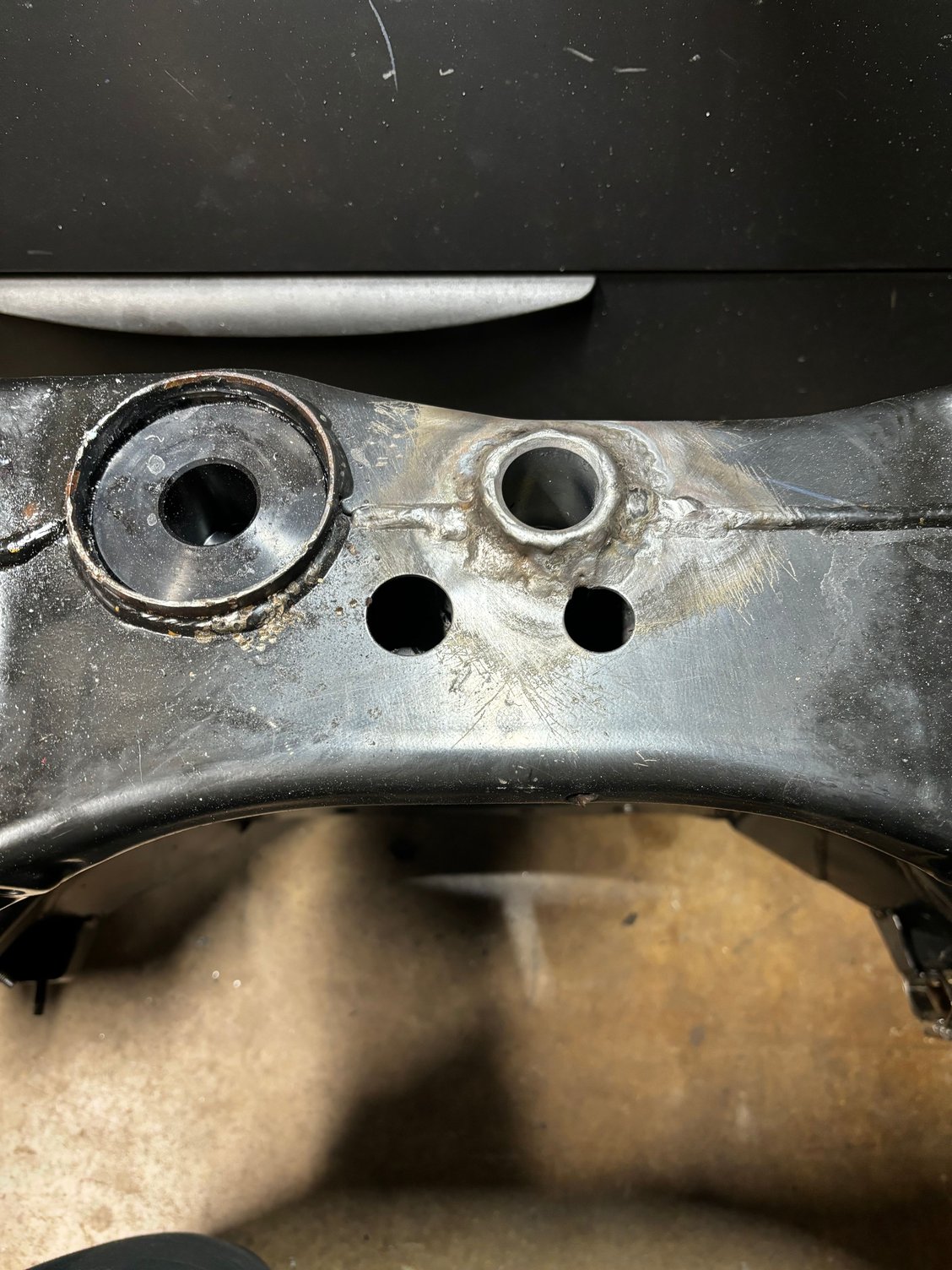

GKtech recommends a 44mm hole saw but the bushing measures about 42.5mm
Second bushing welded in. Pay no attention to my welds.

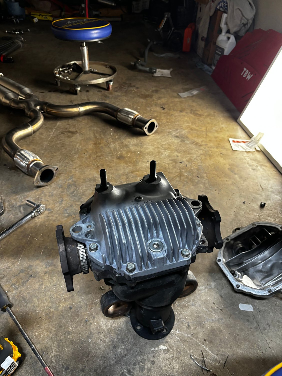

Diff cover and studs swapped
The new cover bolted up without any issues. The studs that were originally on it are M14’s but the nut is too large to fit into most of the aftermarket bushing options for these cars, so I swapped them with GKTECH’s conversion studs.

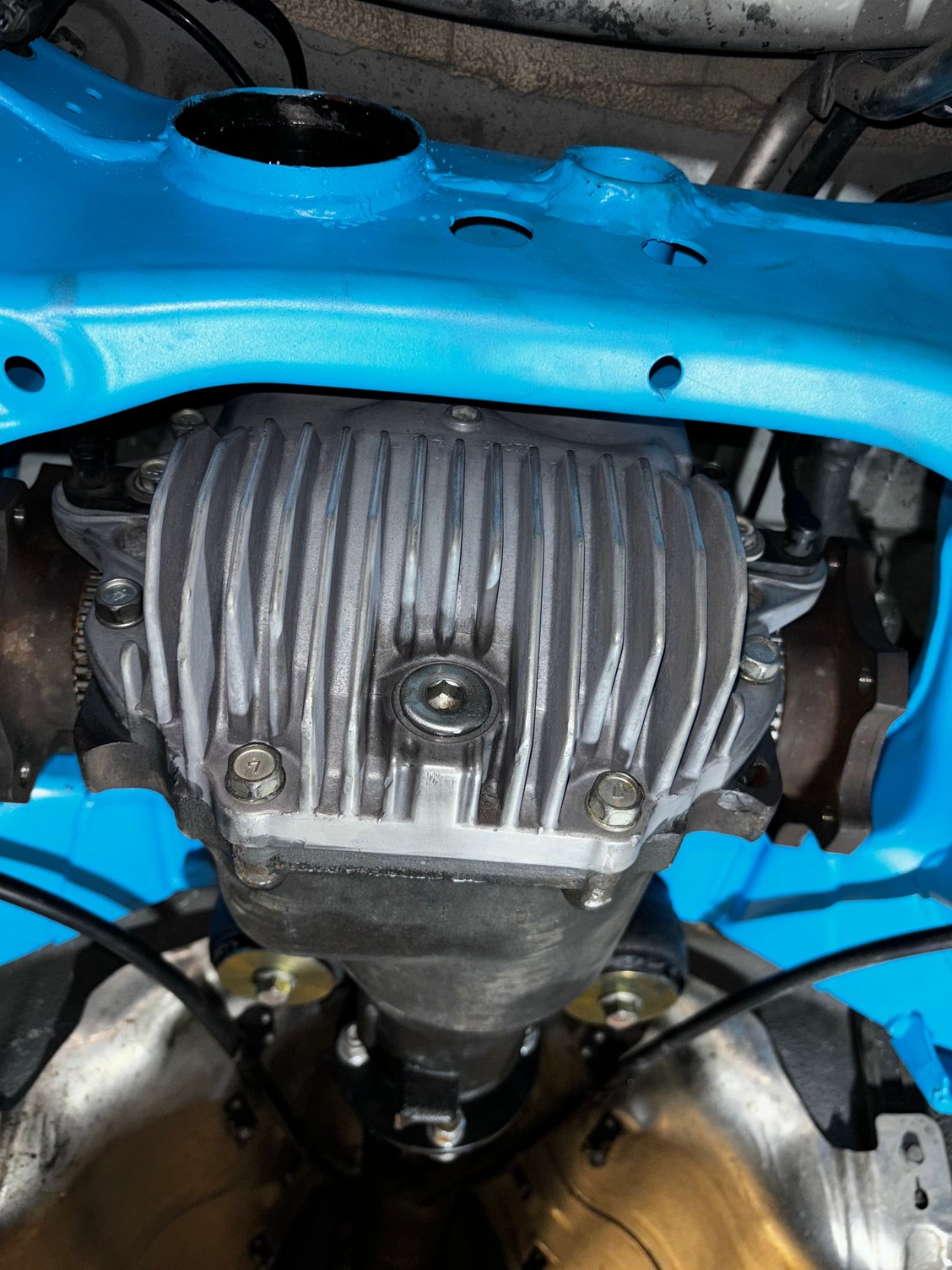

Subframe is now blue

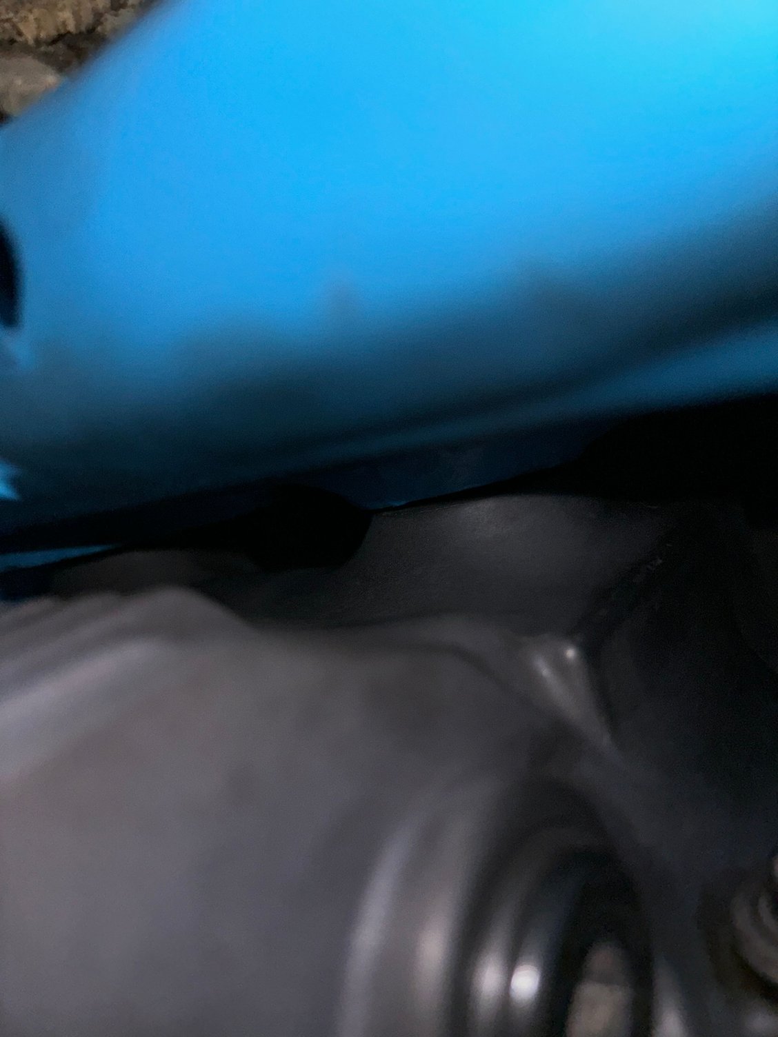

I’m super happy with how it turned out. Aside from the blue subframe it looks factory and has cooling fins beefier than the ones on the R200 Nismo cover. The conversion studs have a larger diameter shoulder than the stock G37 one so I had to bore the differential bushings to 16.5mm and about 10mm deep.
Clearance between studs and bushings

As an extra addition one of our Australian members discovered that ANY finned diff cover will not work unless is properly ducted.
By adding a "scooper plate" he was able to channel some of the incoming air from the bottom to cool these fins. Dropped about 10 degrees overall by doing so.
