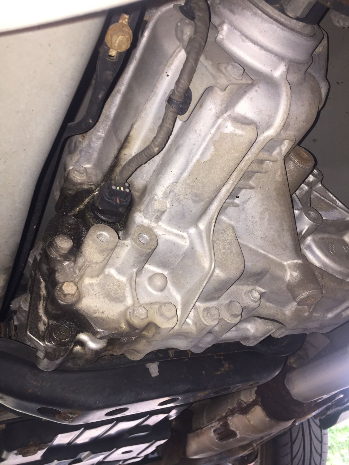

Hey all here's an update. It's dry now somehow... You can see the sensor pictured here and there are no lines for cooling near it, just some sort of bracket type thing or maybe a shift linkage of sorts. Not sure if that means there's no fluid in there or what! But I think this is the torque converter, not the transmission?? Anybody have some insight?

I did not realize you had a G37X- AWD- car!!! That said, I am 99.9% sure that your "mystery connector" is for the AWD SOLENOID. This solenoid controls the electronic coupling of your AWD system. According to the FSM, if this fails you have to replace the entire coupling.
Personally, I would leave it alone. Unless fluid is gushing out, or you have other symptoms, leave it be. Maybe some of our AWD members will have other input.

That is the transfer unit.
It is bolted to the rear of the transmission and provides drive to the front differential, then the front wheels.
To my eye, the leak looks to be above the electrical connector.
If it isn't dripping, I wouldn't worry it. Just check the level:
