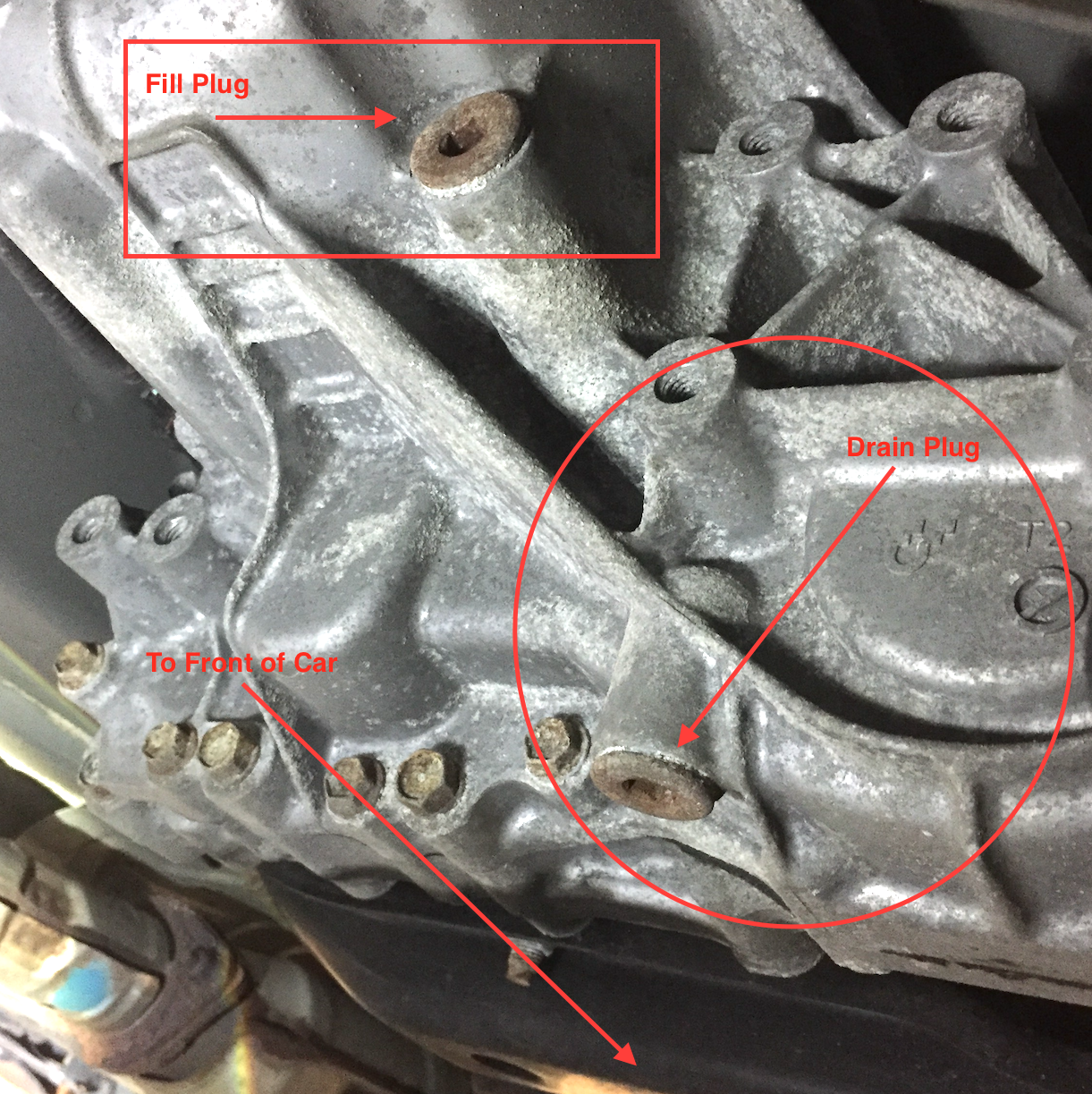

Good morning all.
I am planning to change out my transfer case fluid on my 2012 G37xS Coupe.
I searched in the DIY for pictures on how a transfer case looks like and where it is located. I only found pictures for a sedan.
I looked under my car and found what I think is the transfer case fill bolt and drain plug on the passenger side.
I have attached two pictures of what I saw. Can someone look at my pictures and help me confirmed that I did indeed identify the transfer case, fill bolt and drain plug correctly?
It is the first time I will be doing this job on my own and I want to make sure I don't screw anything up.
Thank you all in advance.
Attached Thumbnails Transfer Case Confirmation-1.png   Transfer Case Confirmation-2.png

You have successfully located the transfer case and identified the drian and fill ports. Be sure to use the correct hex size and get it fully seated so not to strip out the hex inserts (they look a little rusty, thats the only reason I say this). Good luck! Should be quick and easy!
Thank you!
