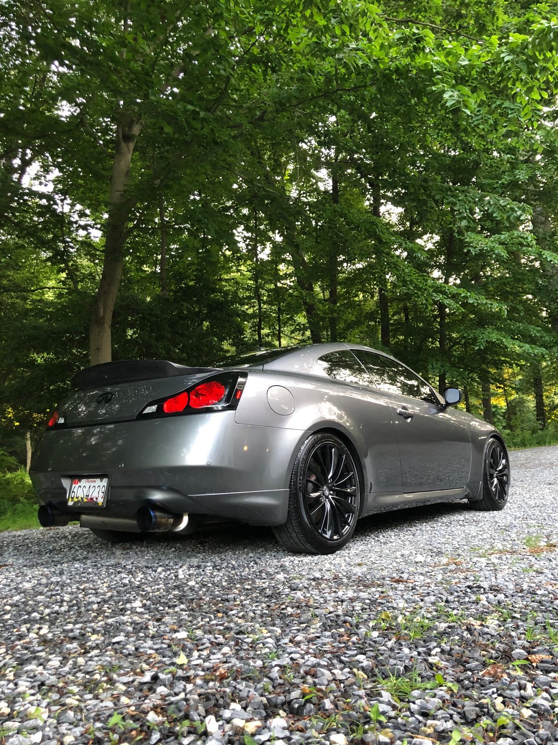

My G

Nice tails btw lol, I have the sames ones from OnEightyNYC.
