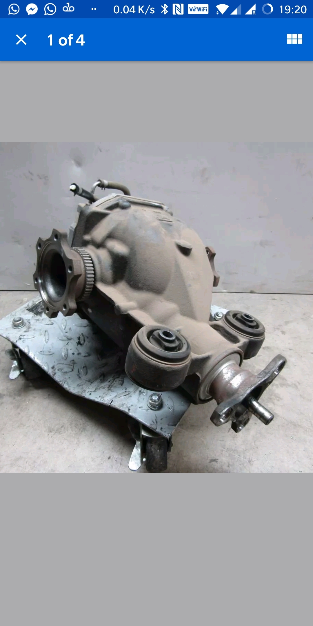

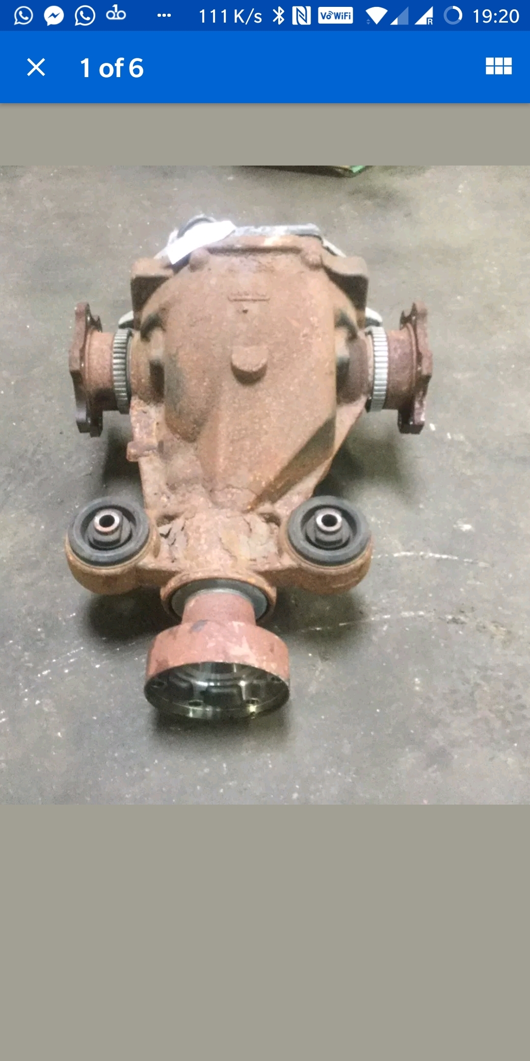

Interesting a thread of diffs comes up. I've been trying to search for the terminologies used when talking about these in addition to the diffs themselves, I guess the mobile application isn't that great.
Can someone explain what the difference is between these 2 diffs and how do I know which fits my application? I have a 13 xS
Attached Thumbnails VLSD 3.692 swap into a 2012 G37XS SEDAN open diff-screenshot_20190127-192004.jpg   VLSD 3.692 swap into a 2012 G37XS SEDAN open diff-screenshot_20190127-192041.jpg

The right picture shows the OE model from a G37 AWD model, identifiable from the input flange type.
The left picture shows the 3 bolt pattern from the 3.692 RWD diffe carrier available on different 350z, g35s and 2008 G37S RWD.
Id recommend strongly to deal with a professional shop who will be competent enough to proceed to the flange swap. Its not just a bolt out/bolt in operation. Measuremewnts and cutting of the pinion shaft to the proper lenght needs to be performed. Then crush washer preload/tightening to specified torque needs to be done also.
Ah ok good stuff so all AWD models are like the right picture? So why exactly are people converting them? Is it normally from awd to rwd or the bolt to the awd type flange?
Just to clarify for anyone reading this, AFAIK, the one on the left is not necessarily from a 3.692 RWD on a 350z, g35s and 2008 G37S RWD...the 3 bolt flange also comes on 3.357 ratio pumpkins and the non S models (i.e open diffs) ...the S models (with the LSD) also have the letters "KG" in paint on the body of the pumpkin..i.e. you can't tell just by looking at the pinion flange whats inside with those ones..(on the other hand the awd (X and XS) all use the the pinion flange on the right, i.e. the 6 bolt so thats spot on)
