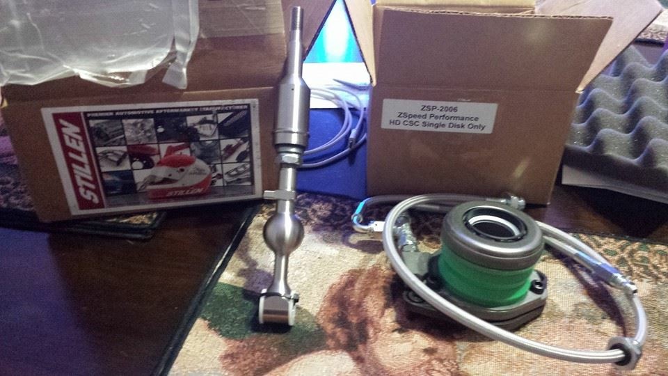

Old Feb 18, 2016 | 11:27 PM
Juju0817's Avatar
Juju0817
Joined: Dec 2012
Posts: 79
Are these cheap parts? Lol not a giken twin disk but works

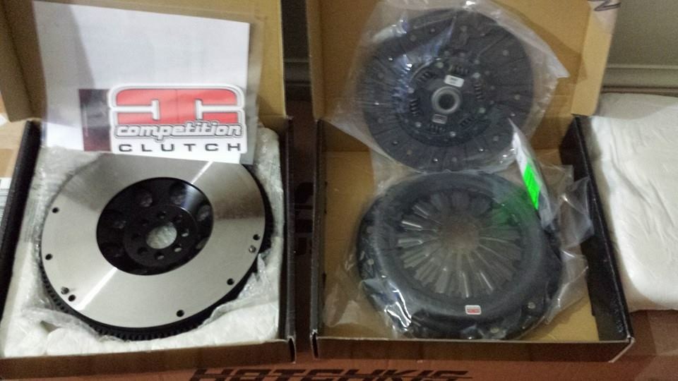

Old Feb 18, 2016 | 11:29 PM
  #21
Juju0817's Avatar
Juju0817
Joined: Dec 2012
Posts: 79
Heres the clutch kit and flywheel
Old Feb 18, 2016 | 11:30 PM
  #22
Juju0817's Avatar
Juju0817
Joined: Dec 2012
Posts: 79
And i used motul 5.1 fluid
