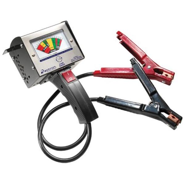

A 2008 with only 10k miles, that would trip the alarm bells for me. Try a volt meter or better yet, get a battery tester (good thing to have anyhow) that shows charging voltage, standby voltage and battery health under load. I got mine at Sears.
http://www.sears.com/actron-cp7614-1...6&blockType=G6

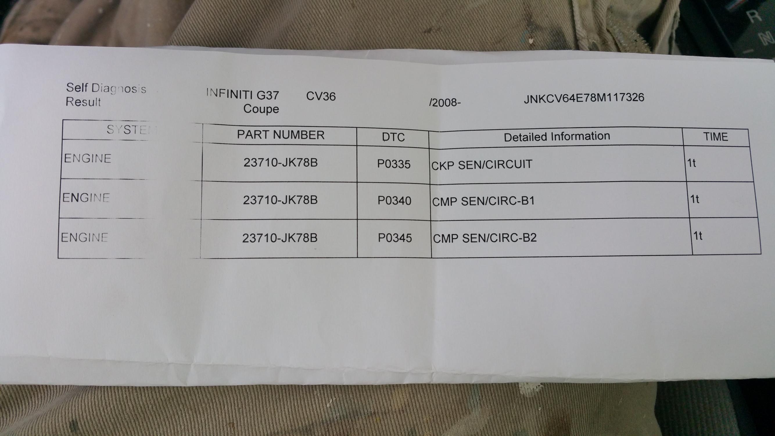

So the car was taken to the dealer and found out that it is in fact throwing codes it's throwing both cam bank codes and crank shaft. Spoke to the technician working on the car and he's guessing the car coulda jumped timing and skipped a tooth .. that the 37 motor are know for that.
Still not a confirmed diagnoses but that all he has as of right now.

Well update on this problem. The car did in fact did jump timing. So Nissan requested my warranty for a new engine to be installed..
