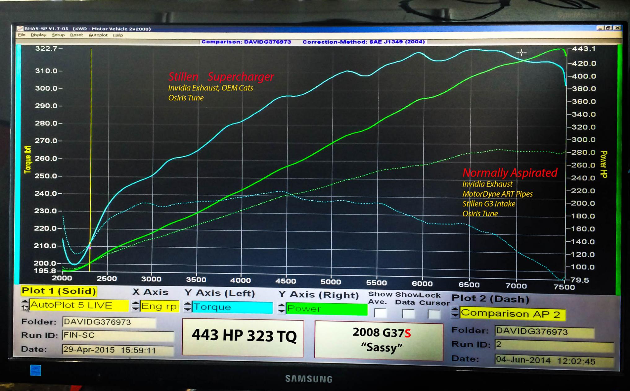

SC Build Complete
Just a quick update... finally got my build completed and even though I had a whole lot of issues I am very happy with the end product. I took some screen shots of the dyno after the final tune and am pleasantly surprised with the performance of the car. Peak power was 443HP and torque of 323. Those numbers are a huge improvement over my previous NA numbers (284HP and 243TQ).
I have a bit of a low end bog, but the high end performance is very impressive. I think the real story here is the TQ curve and the difference between NA and SC is huge.

Looks like the "Par" Numbers for the kit great work, Just dont mod the kit for more WHP leave it and be happy
OH Just change the heat exchanger. The Stillen one is not any good, Frozen Boost on is WAY better,

Thanks for the tip on the intercooler. I was wondering if the Stillen one was any good... it looks small. I am pretty happy with the the way the car is performing right now so I'm going to leave it alone. My gas mileage is way better than when it was NA. I can't figure that one out, but i'm not complaining. Did you find any way to resolve the rough transition when you come off boost? It is a bit nerve wracking when you are cornering and back off the gas a little and there is this huge "adjustment".
