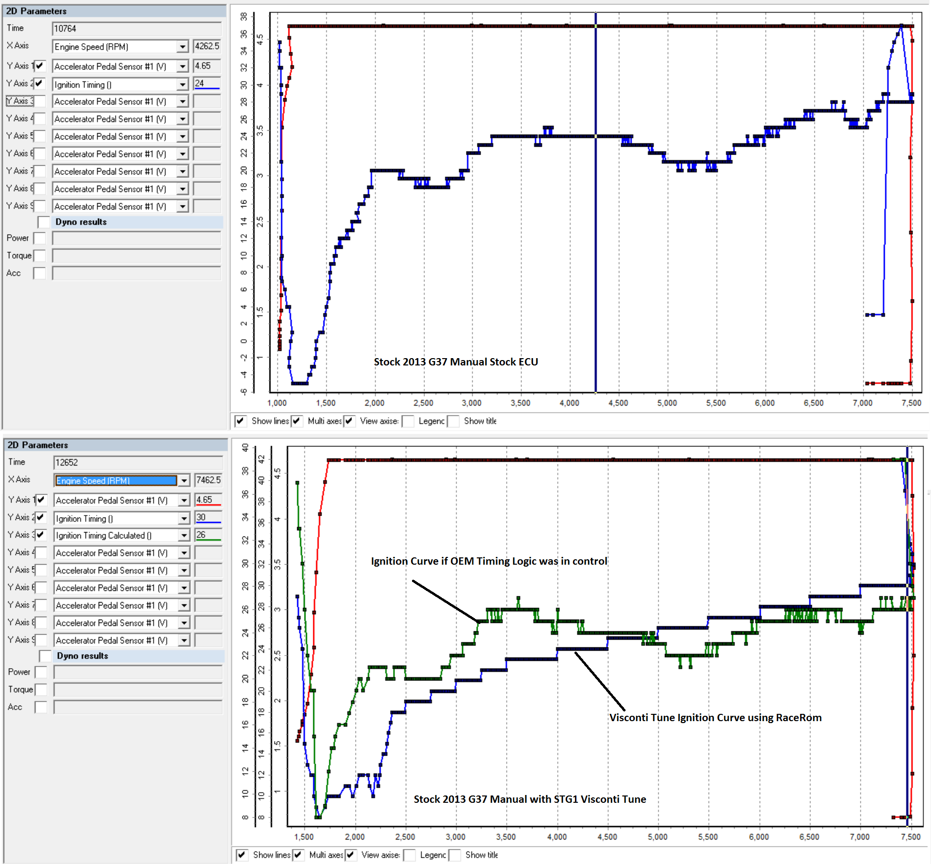

The improvement isn't from just the fueling adjustment it's from the timing control we have with the EcuTek.
I really wish we had EcuTek back when I was first working on Coops car.
Take a look at the OEM ignition curve vs the EcuTek tune.
On the Top graph shows the stock ecu ignition curve
On the bottom is two curves, what the factory ecu is commanding for ignition timing and what EcuTek is actually outputting.
The point of this is the OEM ignition tables have not been changed yet runs ignition timing on almost each pull. The OEM Timing Logic is just inconsistent - having a for ever changing ignition curve is not good for making consistent power especially on forced induction cars!
