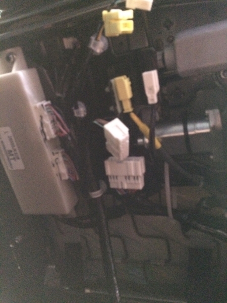

There's 4 14mm bolts holding it to the floor, one at each corner. Once unbolted there are several wiring harnesses underneath clipped in to control various electronics. Press the retaining clip and pull them loose. No two are the same so it's impossible to put them back together wrong.
Is there a trick to removing the white wire clips without breaking them...ive got the seat unbolted and the wiring harnesses unclipped but can't figure out how these white clips come loose:

Not sure what that pic is of. Take a wider angle pic to show what you're unclipping. I didn't take anything loose from the bottom of the cushion. I didn't have any need to.

Maybe a different design between the coupe and sedan or model years. the wire that snakes up from the floor definitely goes through 3 of these white clips:

I see now. I don't remember any wires being clipped in like that on my '08, unless I'm just forgetting about it. The best way to remove them is by using a 2 flat screwdrivers on opposite sides and and doing your best to pry them out without damage. Maybe a small prying tool that's notched in the center would work well too.
Even if you were to break them, they're under the seat out of sight and inaccessible and unlikely that that wire hanging down would hurt anything.

yeah agreed I'm going to try to work them out and if they break just re secure them with zip ties when i reinstall...thanks BB
