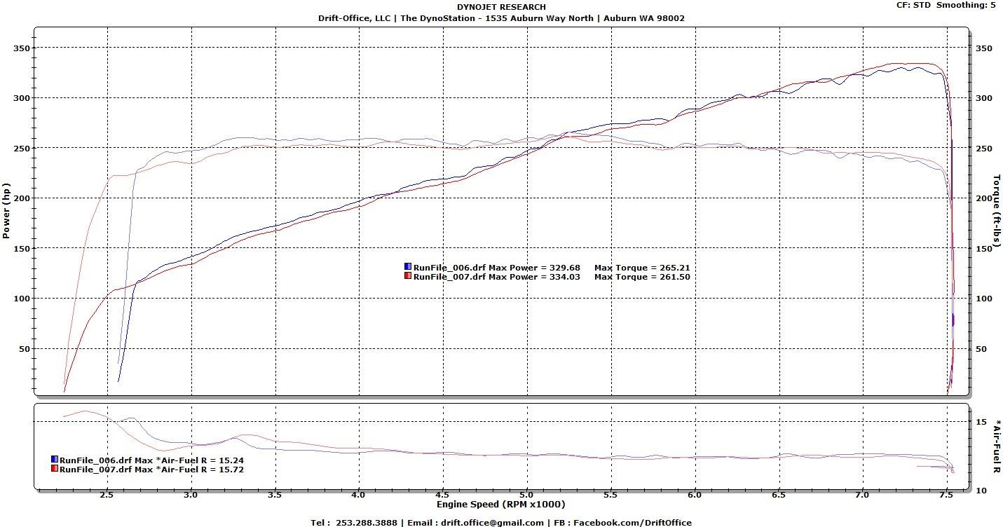

I also had the pleasure to put my car on the Dyno hence the triple digits . Comparing to my last Dyno looks like torque was transferred to the wheels better. Hers the vid.
5th gear run.
Anymore questions feel free to ask. Again let me get some good amount of seat time to actually write up a thorough review.

What were the dyno numbers before and after?

Something I’ve done prior to the DS is sending a false signal to my knock sensor so I wasn’t able to get correct numbers. I know this because i dynoed my car back in December after all my poly mounts and baffled oil pan to make sure the engine was healthy still. We did several runs where my engine would pull timing up top and some runs it was fine. Idk if anyone else has experience this but I would like to know if I’m able to fix it as well. Also note I have month and half old gas, I took some damage to my mid pipes when my OEM DS blew. At the time of the first dyno i had brand new filters on the Gen 3’s and new spark plugs. Lots of variables but still I think it’s making decent power.
Before obviously
After. 4th gear looks to have gained some TQ.

Sorry if this is redundant but was curious what mods are different between dyno runs? That’s great numbers you made. Is it just the driveshaft that’s different?

Supporting power mods yes... but i didn’t have my poly mounts and subframe incerts and baffled oil pan on the first Dyno graph. I think the vibrations are sending a false knock signal unless it’s coming from my clutch.
