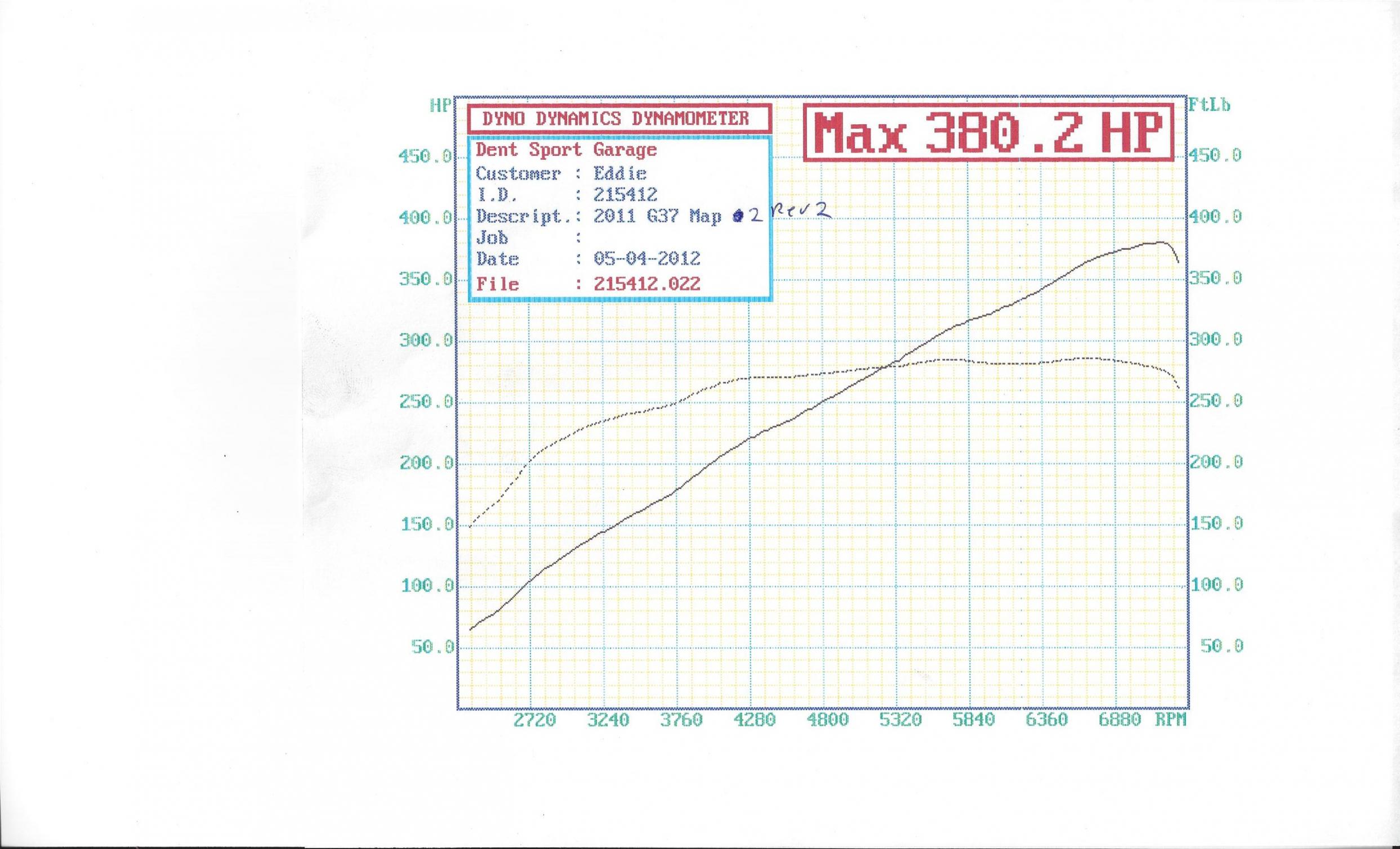

My numbers
I was wondering if I added a exhaust system (cat back) would I see any real gains. Also this was on a Mustang dyno.

I hope you FI.. LOL Or super inflated, HAHAH, you a cat back you shoud see another 10-15 WHP, see my sig,, 7spd auto and AWD Mustang dyno also.
