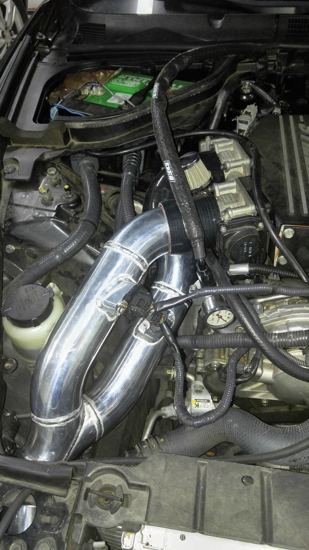

Here is one idea though. Instead of replacing the pulley, you can remove the whole inlet boot and install a larger filter directly to the volute of the supercharger unit (Unfortunately you have to remove the whole unit to do so). This will actually net you about 3 psi more. There's a Q50 who has done this and he's sitting at 500whp. Although it's still unsafe due to temps, he's still running 'fine'.

Thanks for the information - I would have to see some pics of the inlet boot removal/replace, not quite sure I am visualizing it.

You can find all the info you need here: Topgunz - air to air upgrade - Nissan 370Z Forum. You will need to get Top a message and let him know you are interested. He's finishing up on a few kits right now (including mine), so there may be some lead time if you want one.
The first pic shows what the intake boot looks like from the kit out of the box. This is a pipe that splits into two intake heads. If you remove this then you can just add a larger filter as shown in the second pic, which is directly mounted on the supercharger without the extra piping.

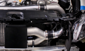

For those who are interested in what the kit pretty much looks like: That y-pipe is art and I hope it fits in our bay without modification. Piping is aluminum btw, so any fabbing will need to be TIG welded. Let's just hope we won't need any.

No $hit, the dual intake actually reduced flow? Seems like an easy mod, though with extra 3 psi, I would think its the pulley OR that, both would probably end in tears. Thanks for the pics!!
Thanks for the info on the 370 thread, I will register over there now. Definitely would love to hear about how your build/tune goes man , keep us posted!
