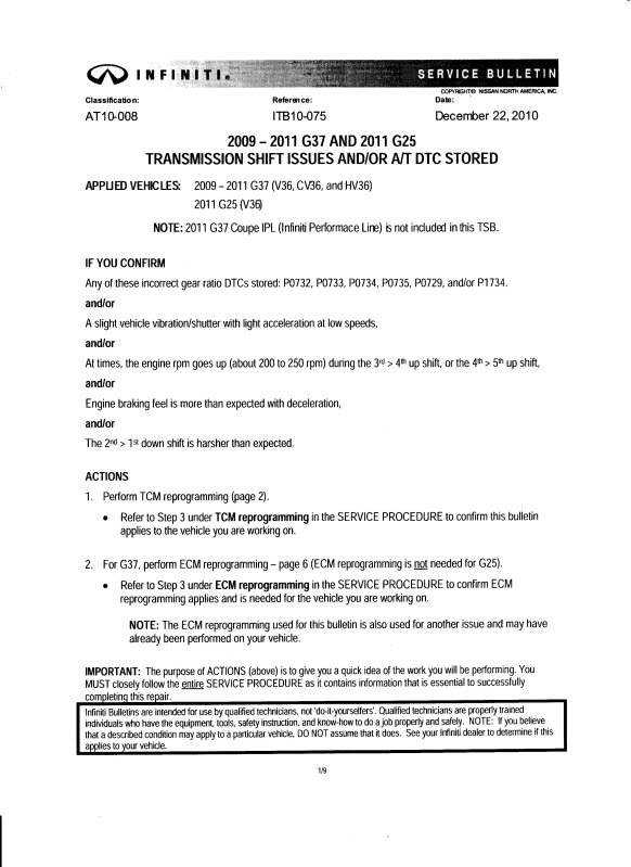

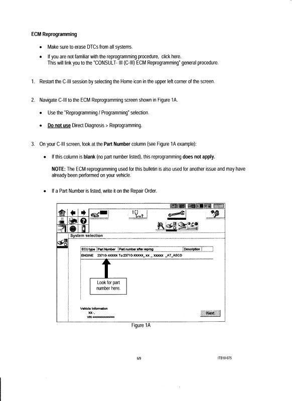

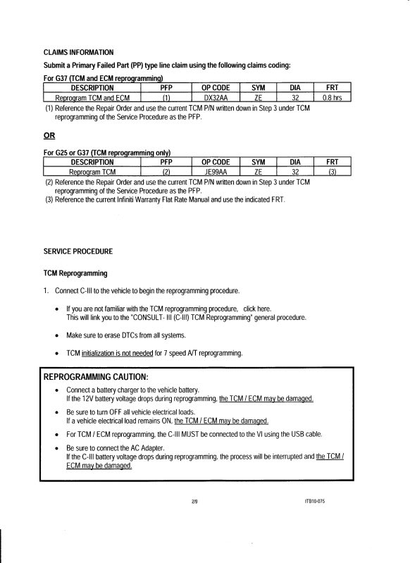

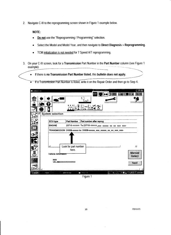

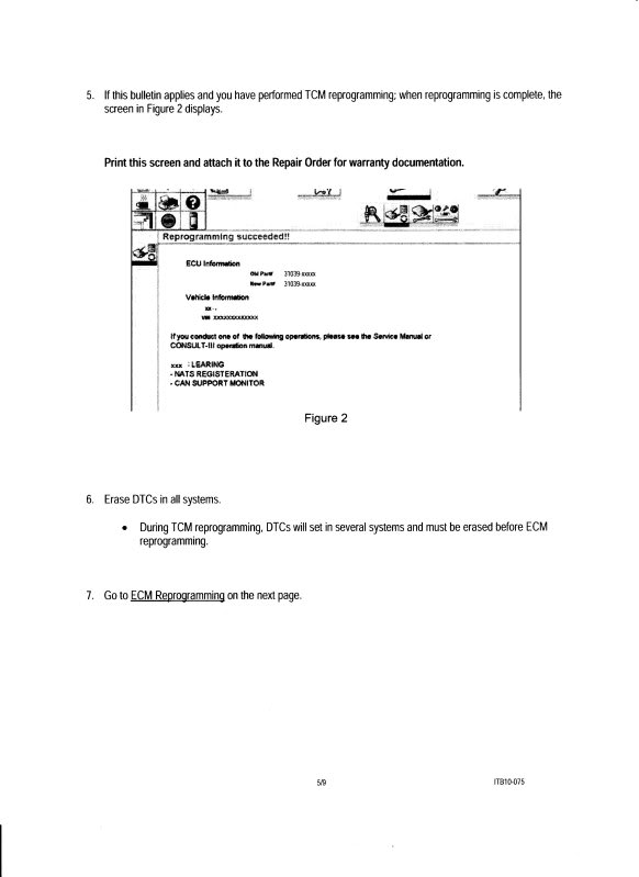

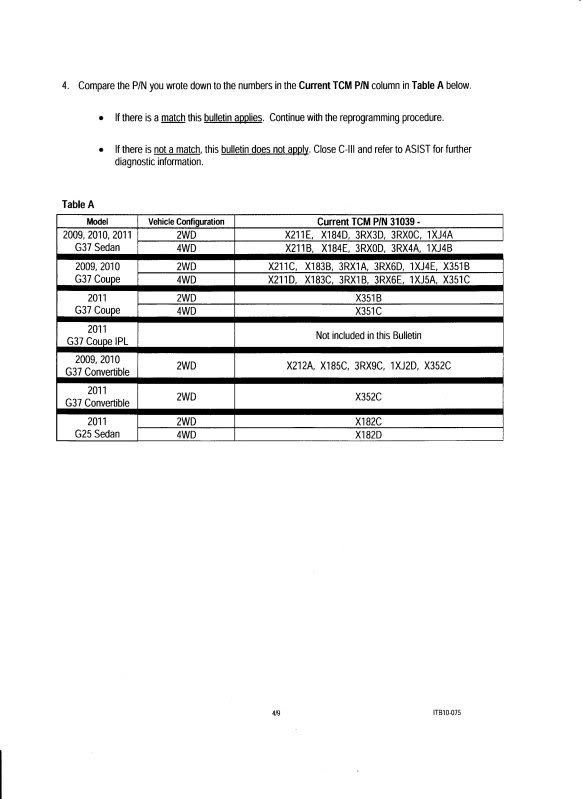

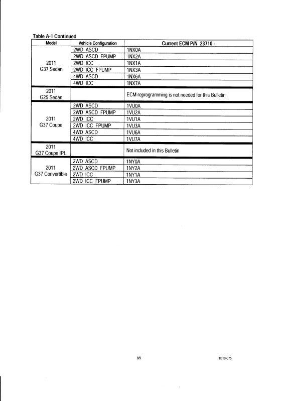

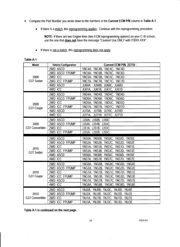

Went to the dealer today for the reflash and I got bad news. The consult III that they use to check the cars computer did not display a transmission part number and therefore this bulletin didn't apply to my car. The bulletin is for 2009-2011 G37 and 2011 G25 trans issues, so I figured my 2010 would apply. I found out later that the dealer had issues with there consult III and they are waiting for an update, so maybe when they get the update I can get the reflash. But I was so dissappointed that I couldn't get the reflash.
I was able to get my hands on a copy of the service bulletin and I'll post it as soon as I can scan it in.
Old Jan 14, 2011 | 03:19 PM
  #190
MaluG37's Avatar
MaluG37
Joined: Oct 2010
Posts: 139
From: NJ

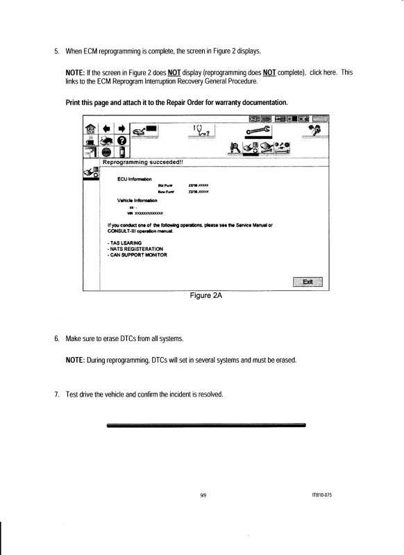

ITB10-075 Service Bulletin
Everyone
Attached is a copy of the service bulletin for the 7AT issues. I haven't been able to get this update since the Transmission Part Number was not displayed on the Consult III when connected to my car as shown on page 3.
