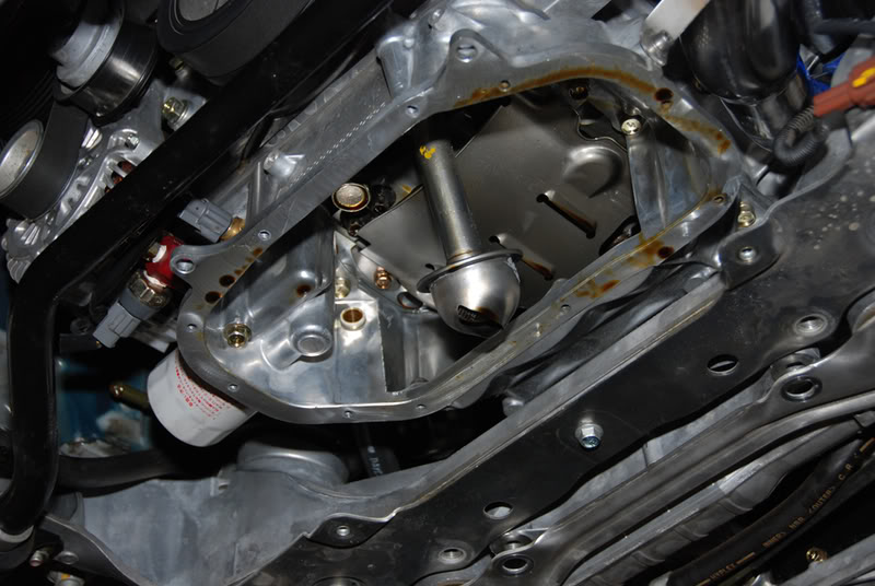

Originally Posted by Greggski
Wondering if you are going to have to tap the oil pan for the return - or does the kit use a spacer? Also, do you know where the oil feed is coming from?
Thanks for the write up! Gives others the confidence to give it try maybe..
You tap the oil pan for the return. If you tap into a spacer, you're going to get oil backed up in the turbo, which would cause you to burn oil.
The oil feed is coming from the oil distributor near the oil filter.
You can see the passenger side oil return in this picture. It is the brass fitting near the top of the flat surface (where the camera flash is reflected).
