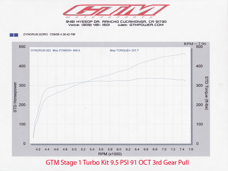

great work george! gives us auto guys some hope heh. some ?s...
any reason the torque is so low compared to the hp? are you trying to protect the stock motor or transmission possibly?
what else besides a valve body upgrade would you recommend for autos?
why not the 3" gtm exhaust since you recommend that for turbo setups?

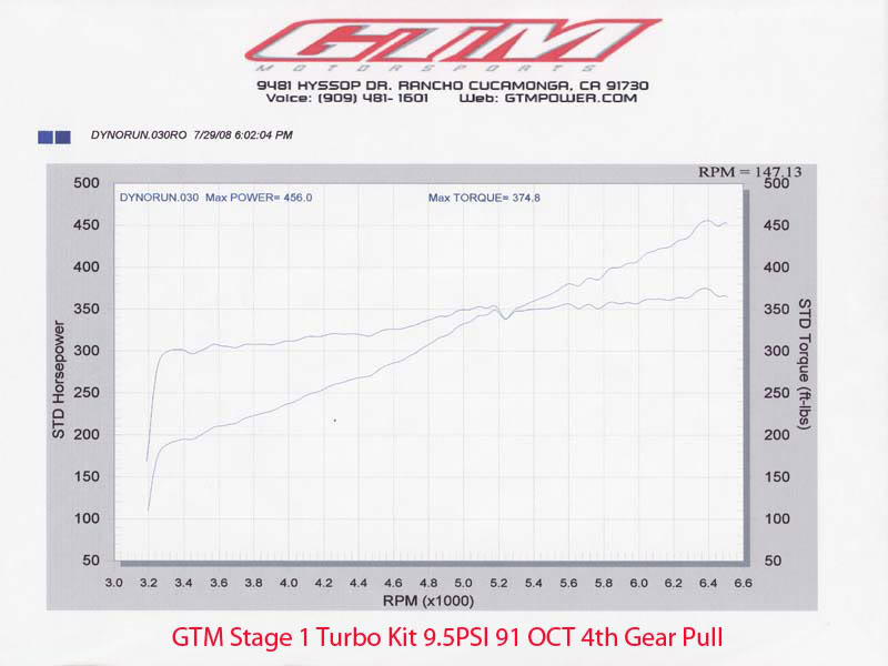

I would also recommend a trans cooler, Now as as far as the torque numbers , All the dyno runs were made in third gear, With the same psi in a fourth gear run we will be able to pick up anther 50 foot found of torque which will put the numbers in the normal range for this type of engine .
blow is dyno graph for a G35 Automatic HR engine , note the torque Numbers difference between 3rd and 4th gear with the same psi .
And finally this car was tuned for maximum safety and reliability we can easily run another 4 degrees of timing witch will make a huge improvement
Hope this help
Sam
