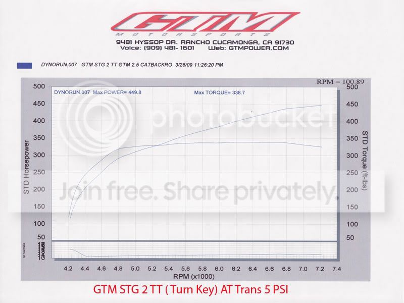

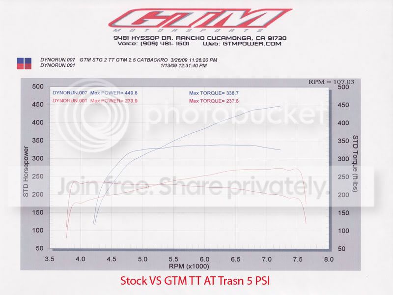

Overall The RE5R01A Trans is a stout unit. With a minimum upgrades like the valve body mod and the a trans cooler, You should expect a good service life out of it, Even with a twin turbo set up, The key is to perform the valve upgrade as soon as or before installing the TT set up .
Below is a dyno graph for a G37 we are currently finishing up, It has our stage 2 turn key kit turbo kit ,Stage 1 valve body upgrade and our 2.5" GTM spec exhaust , The car made 455 whp @ 5psi effortlessly ...
Sam
Sam
Gt motorsports
WOW great results there, its good to know that it could be done with small modifications!

Those are some BADASSS numbers for a 5AT. REMEMBER GUYS, 5AT #s will be lower than 6MT. Its the 5AT vs 6MT difference. I'll let Sam explain that if anyone is curious.
