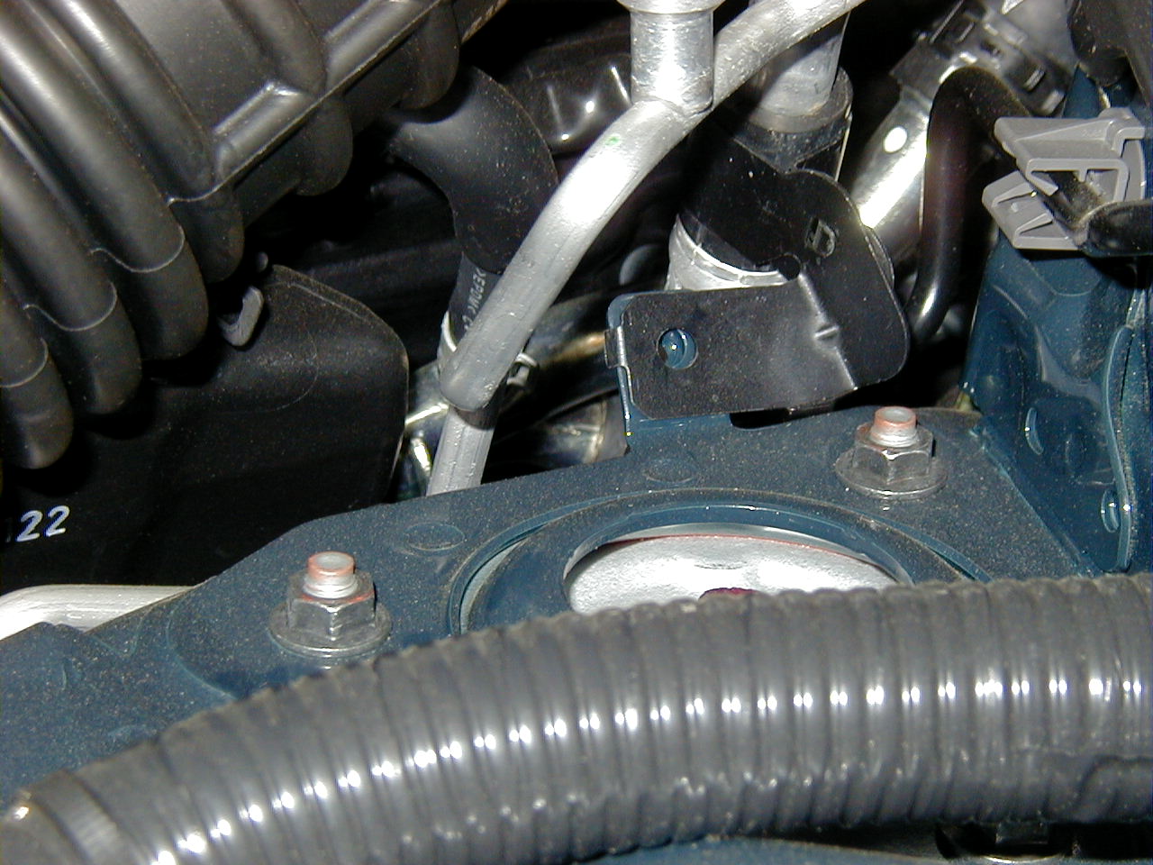

I've attached a picture I just took of where it looks like you're talking about near my A/C lines and the intake.. there's a bracket there.. but no bolt in it..
Yours doesn't have a bolt?? Mine did...does.
