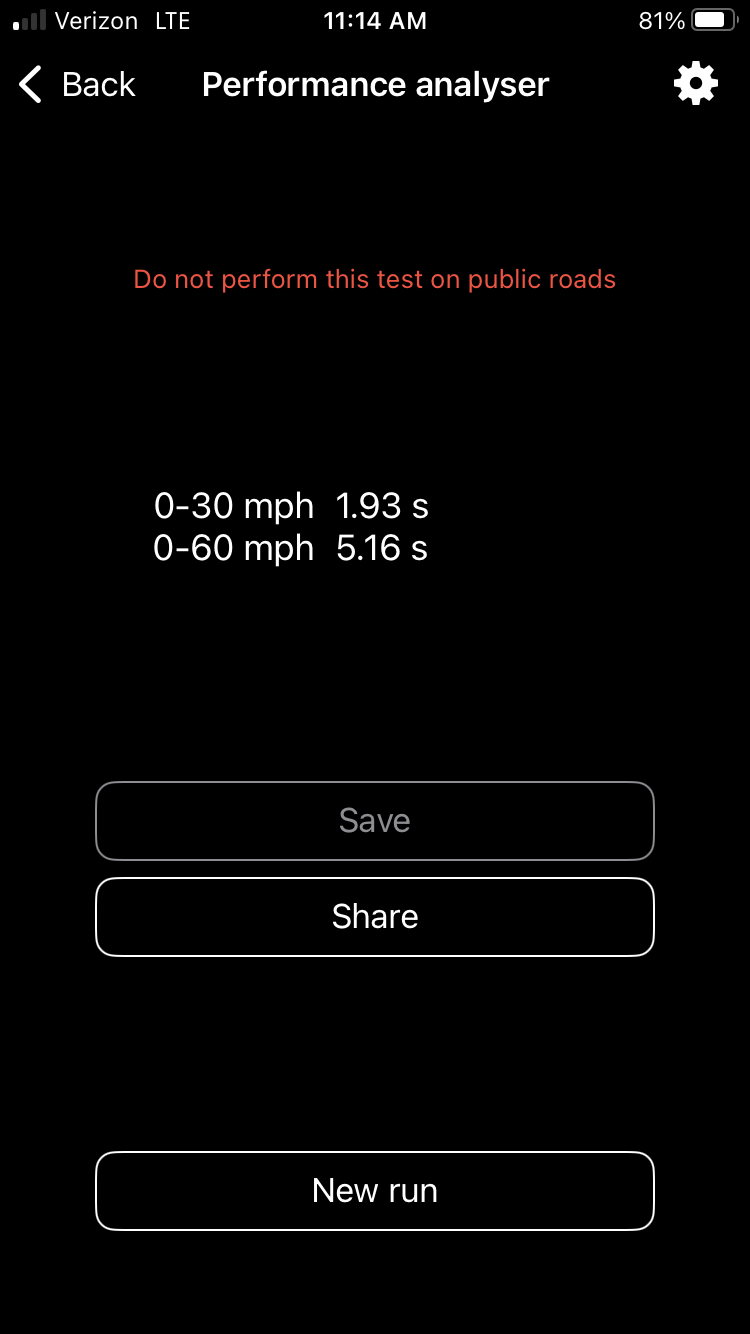

Anyone here have experience with the Z1 remote tune? I hade mine tuned by them. It is slower than the stock tune. I tested it multiple times and multiple different locations, ran the z1 tune, then flashed to the stock tune and did some runs. I'm talking at the drag strip, dragy app, and the ecuteck performance analyzer. Oh and also a whole other car with the Z1 tune. Same day, same road/track but the stock tune file vs the final Z1 tune file. On two different g37x sedans. What we found was the z1 tune was a friggin second slower than the stock tune no matter where and what we did. My 0-60 is 6 seconds on all three records with the z1 tune. Flashed back to the stock tune and boom, I run 5.2 or around there every time. Same exact situation with my friends car just slightly different numbers. Drag strip My car does a 14.3 LOL.... And both our cars have less than 60k miles on them. I'm not trying to be the guy was the fastest NA g37 or go to the drag strip every weekend but something doesn't seem right. What do you guys think? Am I just over thinking this? Emailing Z1 today.

Tuner said it most like was bad gas and the ecm pulled the ignition timing.
Getting somewhere now tho, just did some pulls/data logs with a new map and the car felt much better.

Update
Car feels a lot better, got the tune figured out. My 0-60 after getting the new map. A lot better than 6 seconds lol. I found I was shifting way too late with the 35HR manifold because it brings the peak down to 6800-7000 rpm. So I started shifting much earlier and it was faster. Also on 19 inch wheels and I believe my speedometer is a little off because of that so take that into account.
