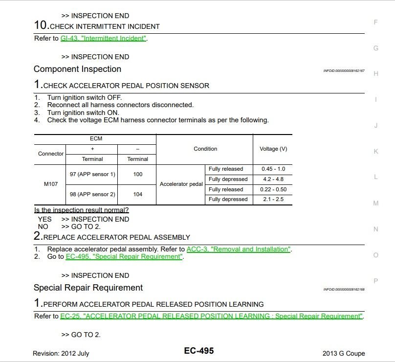

I experience the acceleration problem too sometimes. I have tried 2 pedals. One that came with my car and one I got off ebay used. Both of them read the same voltage for 1 and 2 accelerator sensor. Maybe we can get someone to chime in who doesn't experience acceleration hesitation on what their readings are. The research I did and my 03 maxima shows opposite values are correct. I have yet to look at any other infiniti or nissan vehicle data from another car to tell. The tech in your above picture states opposite values are correct. I guess the question is are the voltages supposed to be scaled opposite on these cars or are they supposed to read the same. If they are indeed supposed to read opposite then it looks like one of the sensors has failed in our pedals.

Ok I did some more research. The tech is talking about your throttle position sensor which is located on your throttle body. A new one will fix that. The accelerator pedal issue is still weird to me though. The service manual states that 1 and 2 pedal sensors do have different readings sensor 1 around .45v to 4.8v. Sensor 2 ranges .22v to 2.5v. Sensor 1 for me reads .735v to 4.33v. Sensor 2 .68v to 4.46. So according to the SM my pedal is bad. Something else I noticed was I was sitting at .735 but if I shook the pedal around it would bottom back out to .7. So I pulled on the pedal some to stretch it back out and now it sits closer to .7. I'm guessing the pedals get worn or the springs get weak or are weak from the factory, especially all the stomping it gets, then the bottom reading changes so the ECM gets confused sometimes and also if its only reading 1 sensor. I would still like to see some readings from others and learn what theirs says.
