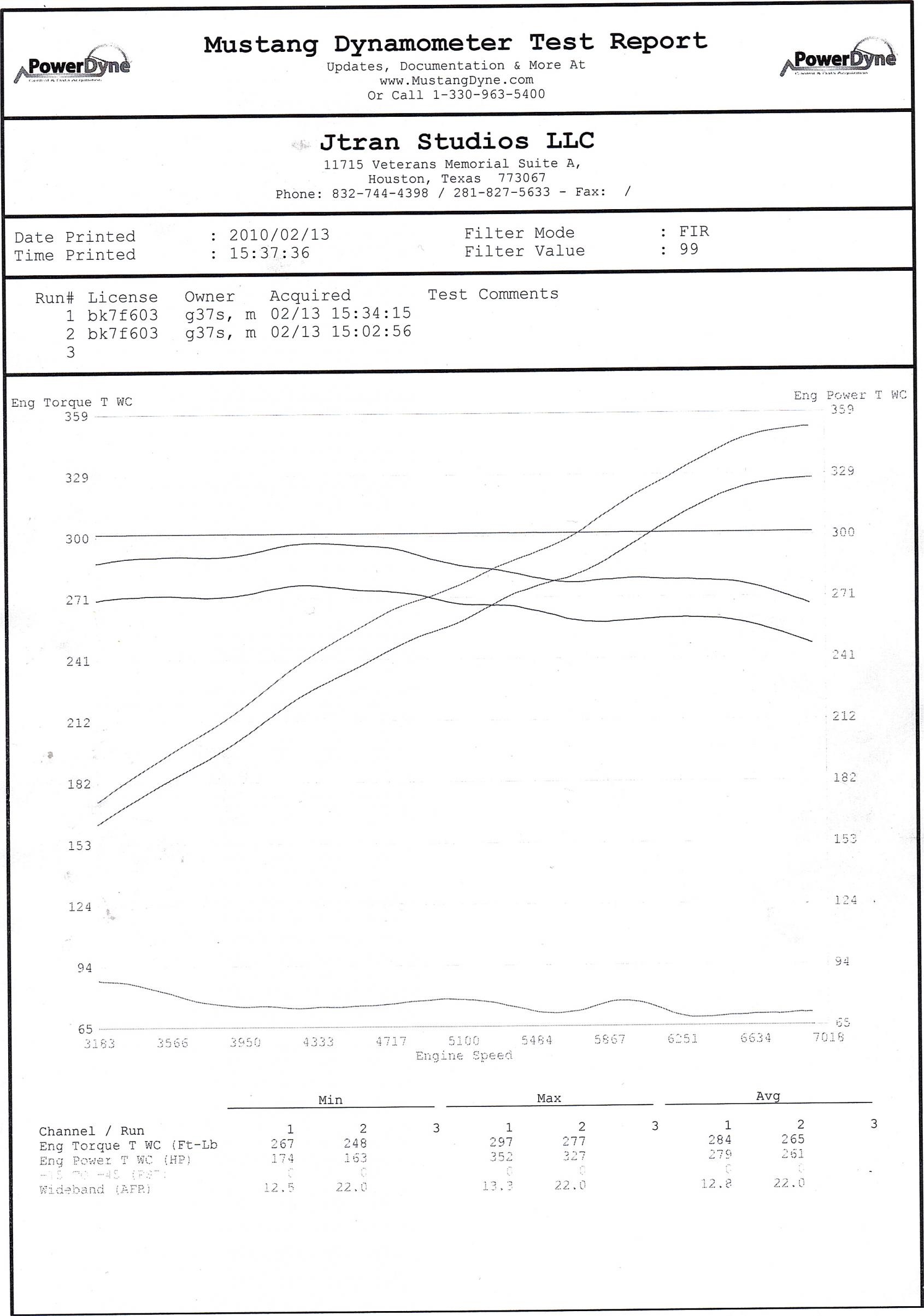

I was late today, but the Jtran family took me in right away. I went in with 246 and let there with a conservative 282 on a Mustang Dyno. Now he did run much better numbers(302), but I want to wait until I get a few more miles on it, before pushing harder.
I would tell anyone in the Houston area to give them a look. I think the customer sevice alone is well worth it, but John the owner makes everything happen and is great to work with.

Here is the Dyno Sheet.
Do you have any MODS knockout or it stock?

Just cold air and exhuast.......The car is much stronger after the tune for sure. Not anything like my Lightning or Cobra, but I am happy as hell. Next is HFC.
