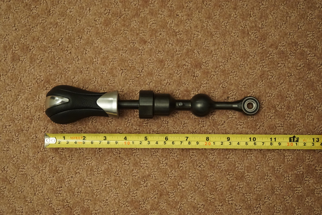

Here's my current setup, for reference.

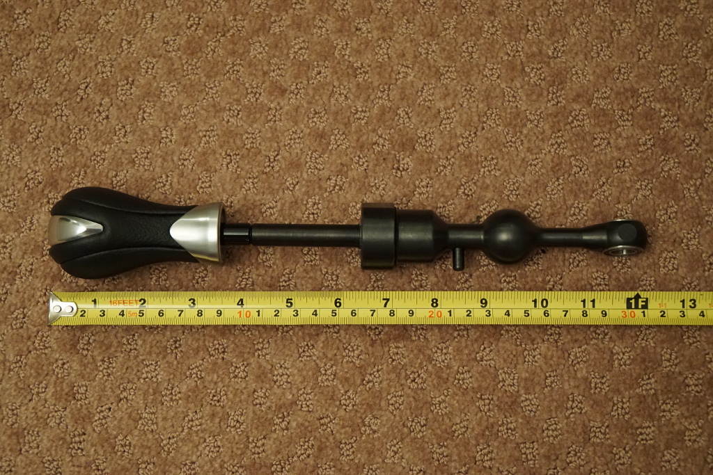

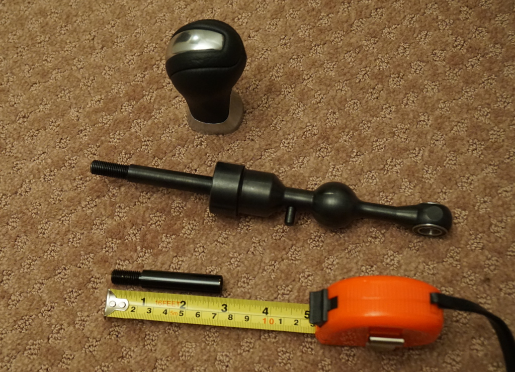

Uhh, it's called "search". There's dozens of these extensions for sale on eBay. Most of them are from China, of course. The one I bought was from a seller in Cali, so it cost a bit more, but I wanted one soon so I could experiment.
It's 3" which is probably too long, but that's the shortest extension I could find and I just wanted to test it out. $25 shipped is a small price to pay to experiment imo.

So it looks to add 2" of total height. Would it be possible to shorten the female end and then re-tap the opening?
I hope it works out for you. You're pretty good at this stuff, Liam.
