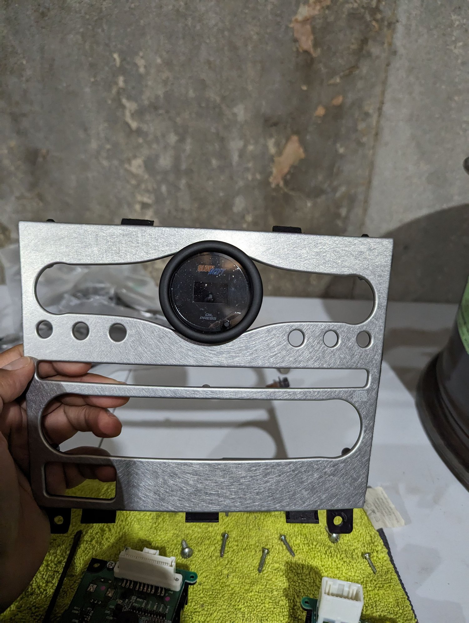

You will notice that there is almost the perfect amount of space for a gauge pod to fit in the middle of the trim as well as sit nicely between the circuit board. I am using a standard 52mm gauge pod for this install. At this point you can try and wedge in the pod where the clock would sit in the trim. As you can see it’s a very tight fit, but this is where the Dremel and file come into play. Slowly and carefully grind away at the top and bottom pars of where the clock would sit. Essentially you want it to be more circular and less oval. It doesn’t take much before you notice that it is easier to press the pod in.
Notice where it drags, you can file it down so it scrapes less in those areas.
Starting to take shape.
Keep test fitting until you can press it in without much difficulty. If you file too much then the pod would just be able to slide in and be loose. I haven’t found a way to make a bracket to hold it in place however I believe you can make one if you are so inclined. Once you are press it into your liking the next step is to cut and trim the black trim around the clock.
This comes off the clock & is very easy to cut and trim. Don’t go too fast or you will melt the plastic. This just takes a lot of test fitting and trimming. For my pod I had to cut and file very close to the lower buttons for it to fit properly. Just makes sure for your pod that you take that into account.
Cut it in half first and then file it back.
How it should look, notice where the cuts ar in relation to the button holes from the clock.

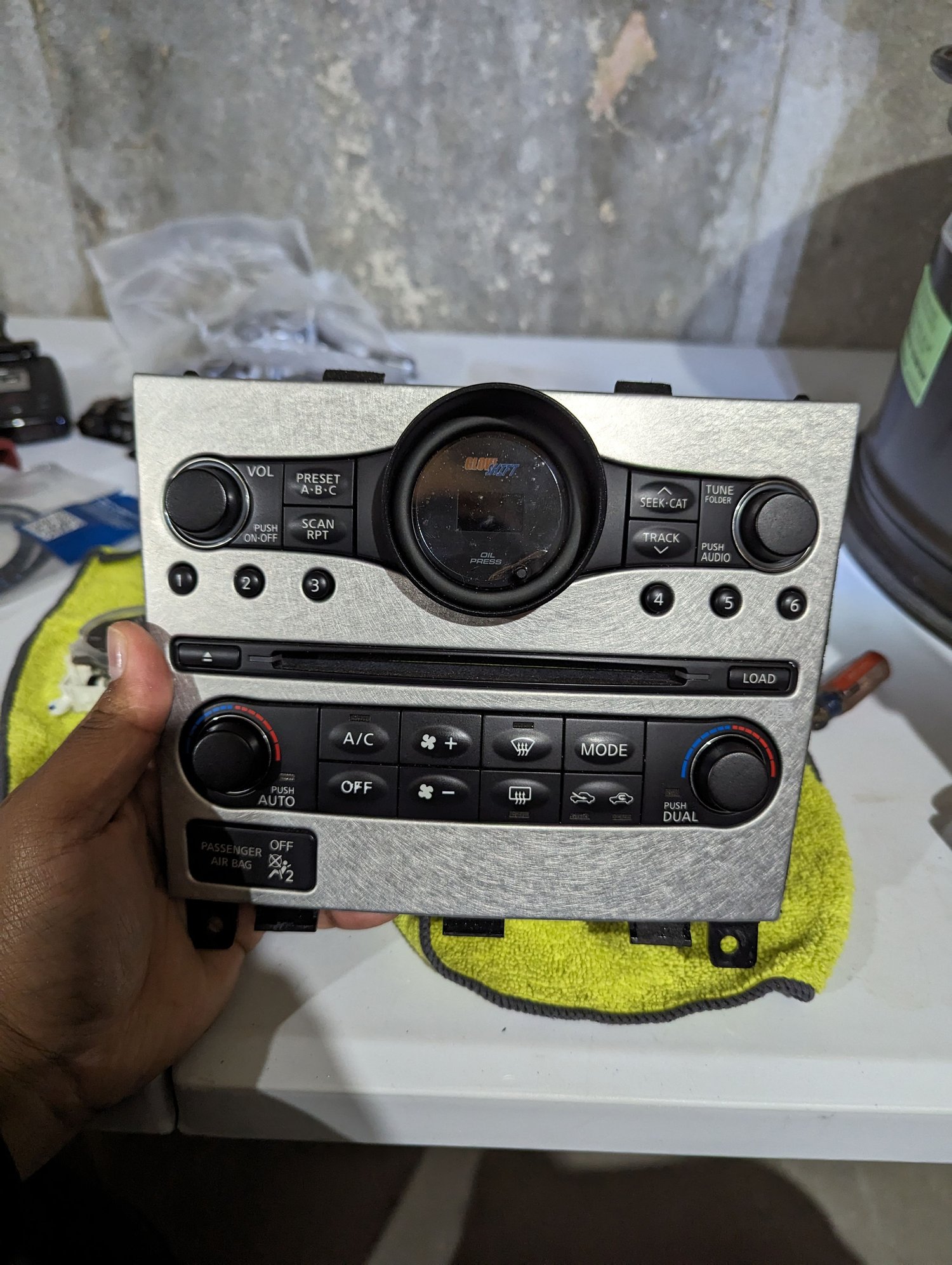

When it’s done you should have been able to fit the pod in, as well as the board and the trim bezel from the clock with no issues. Just go ahead and do the reverse to install back everything in the console.

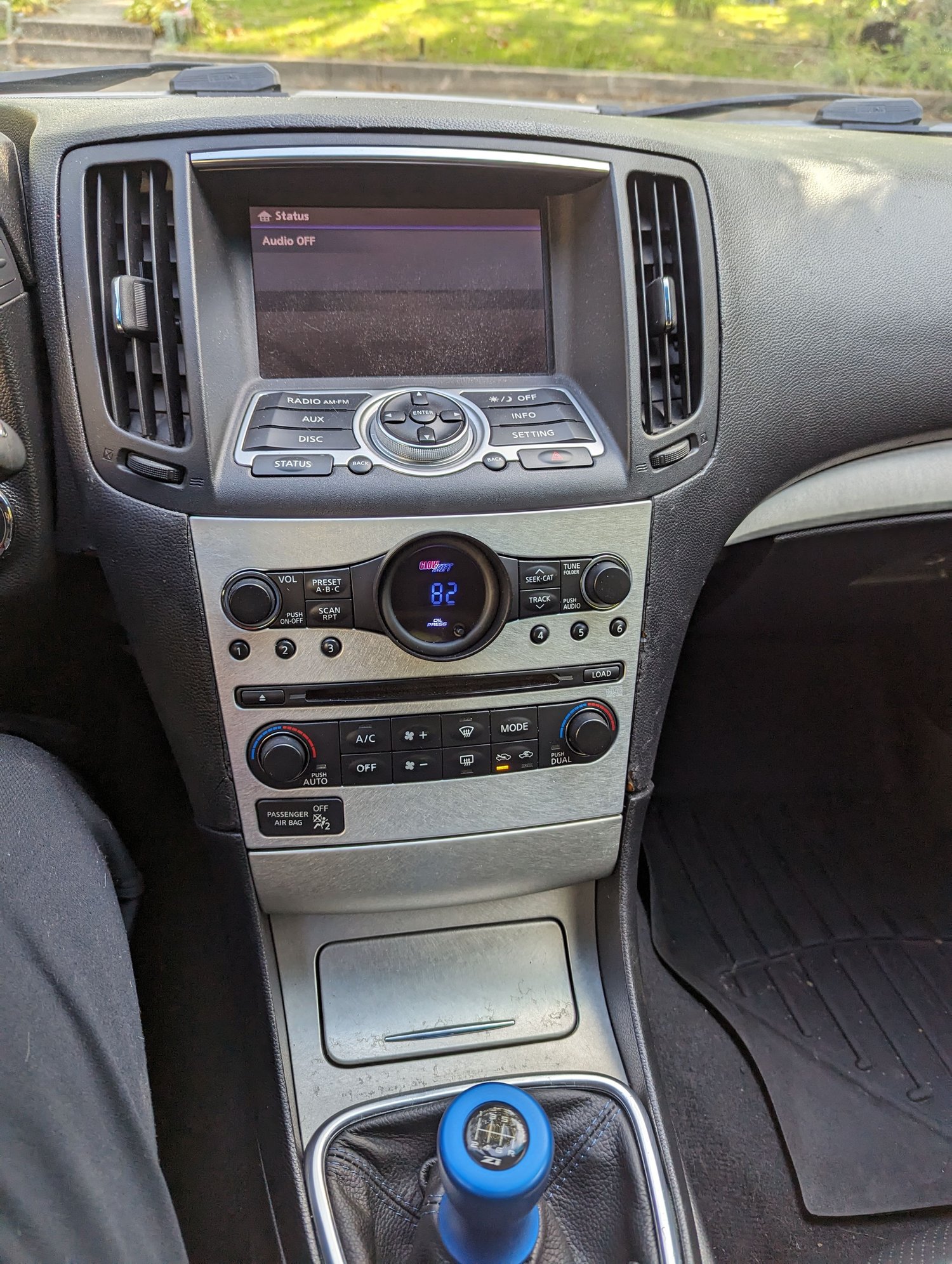

Finished product with hood installed
Back of board. left the install pegs to mount a bracket if I decide to go that route. So far the tension of everything holds it in place.
Final Product. Will upgrade the pod at a future point but for now it works well!
Thats it! You're all done, now go ahead and enjoy your pod placement!
