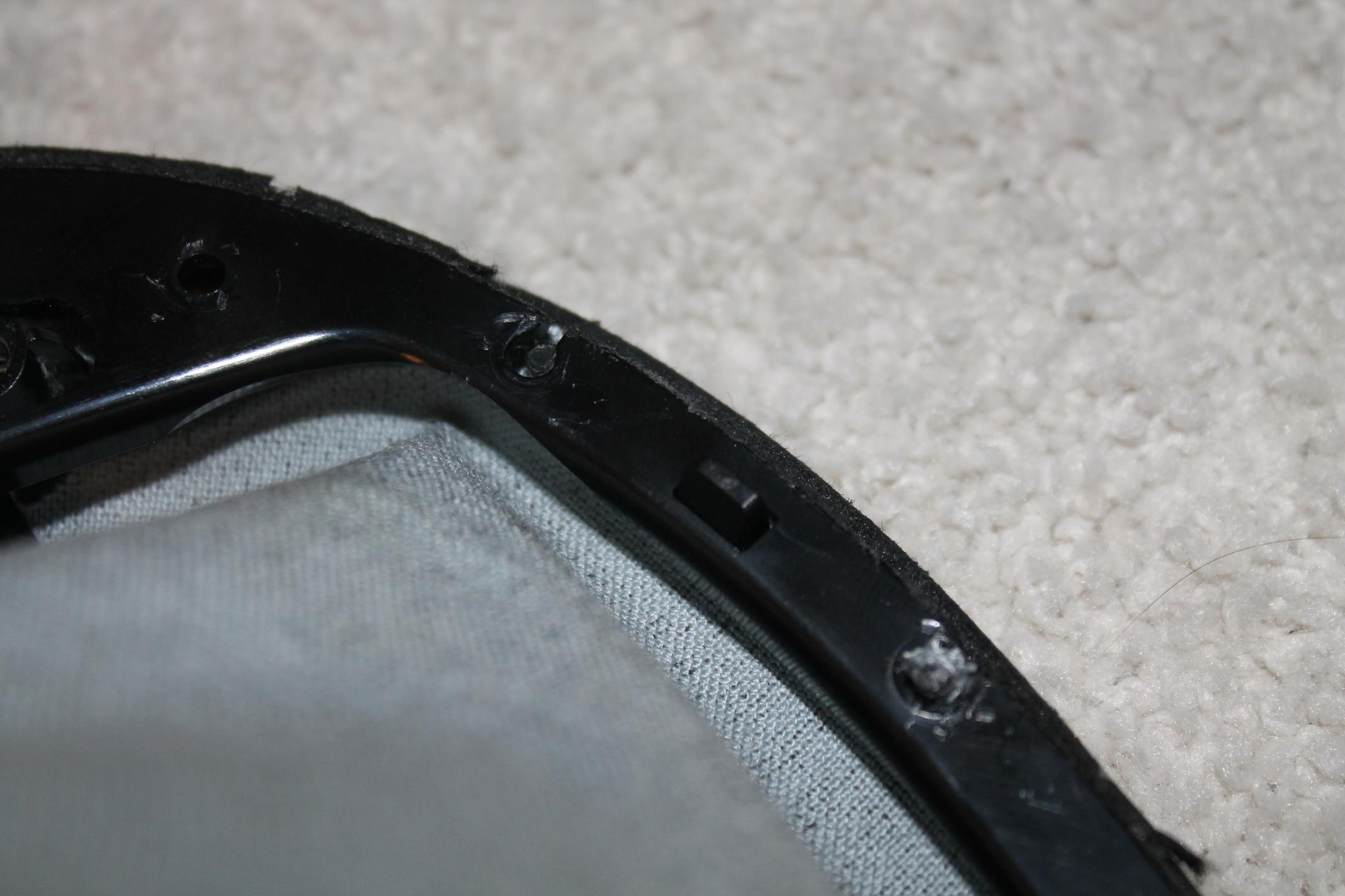

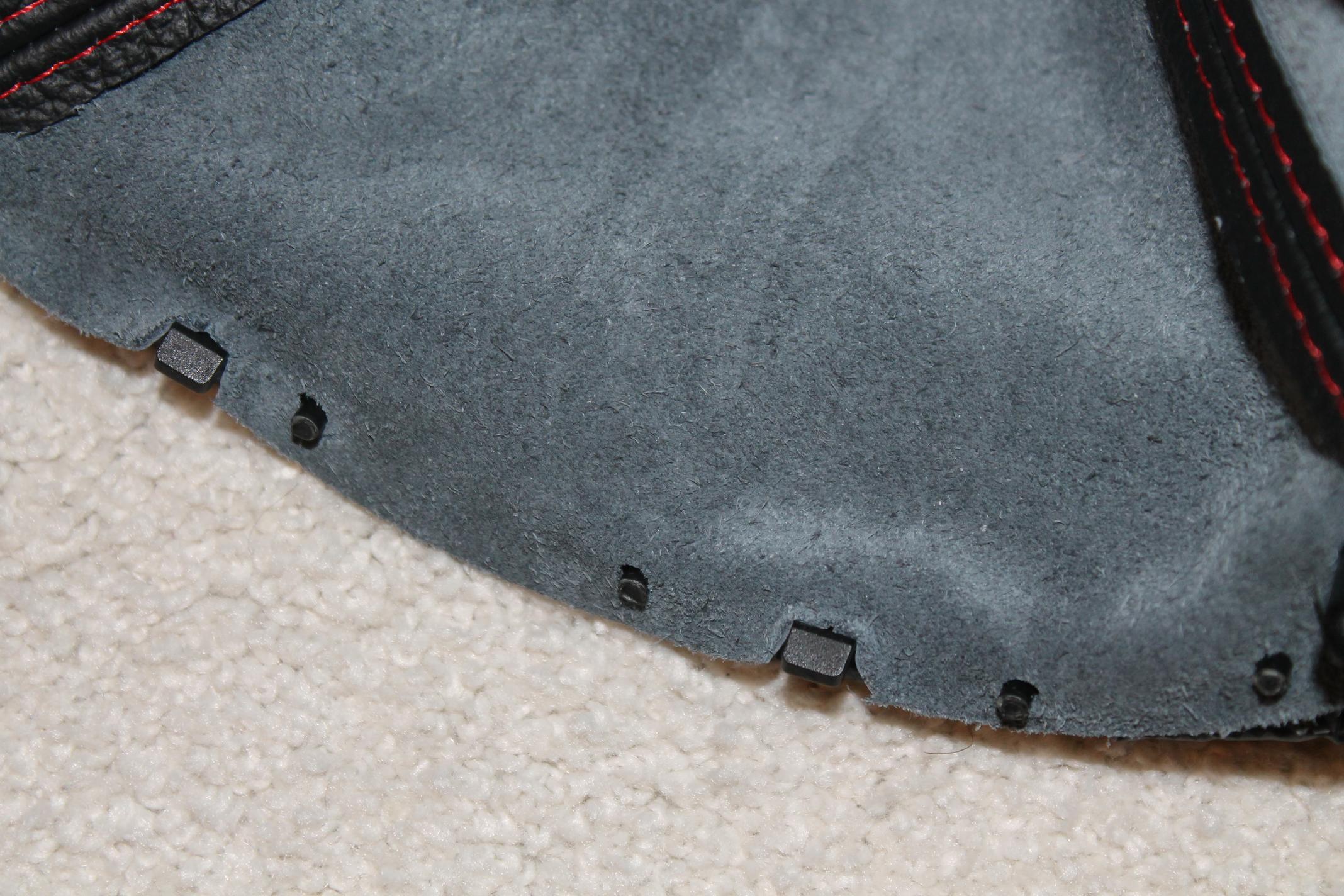

2) Flip it over and pry off the little black circles with a screwdriver. There's a bunch of them.

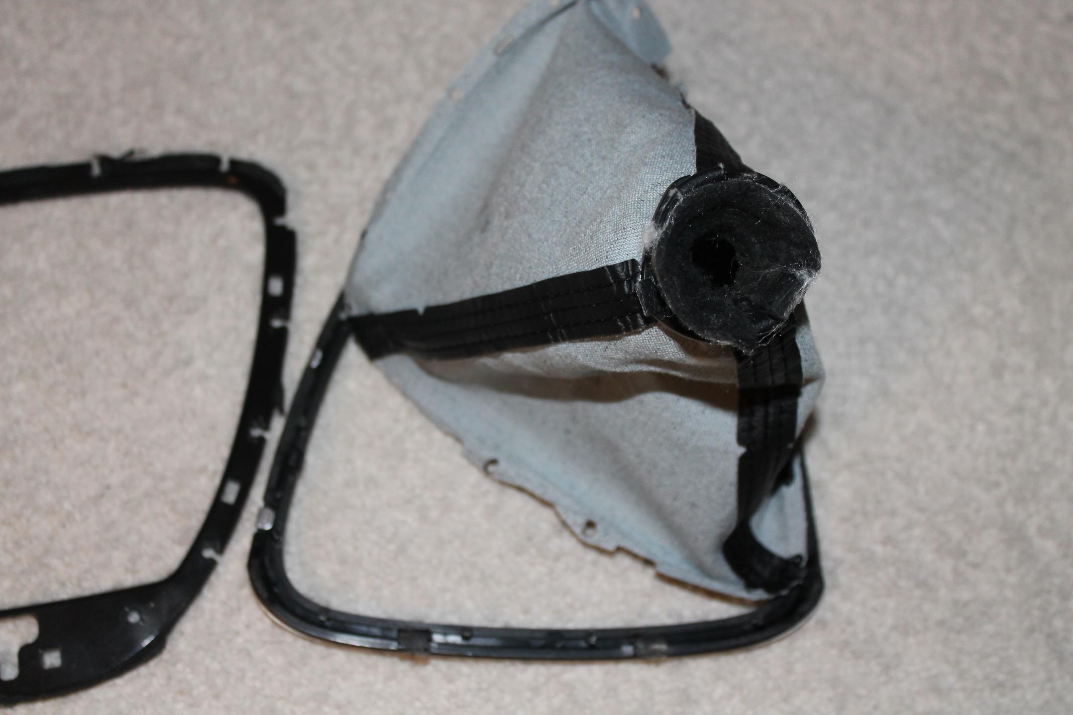

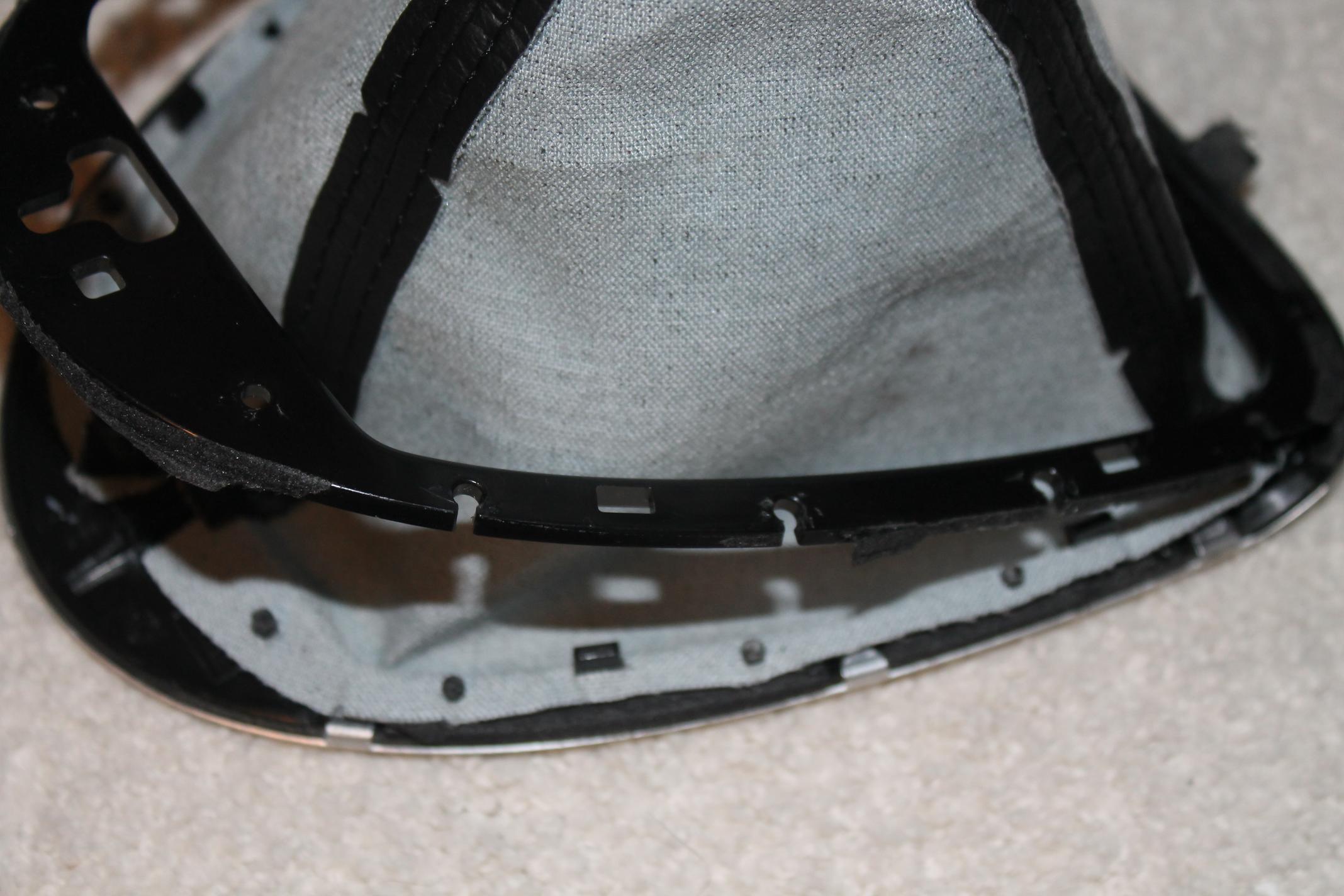

3) Push in the four clips and separate the plastic trim pieces.

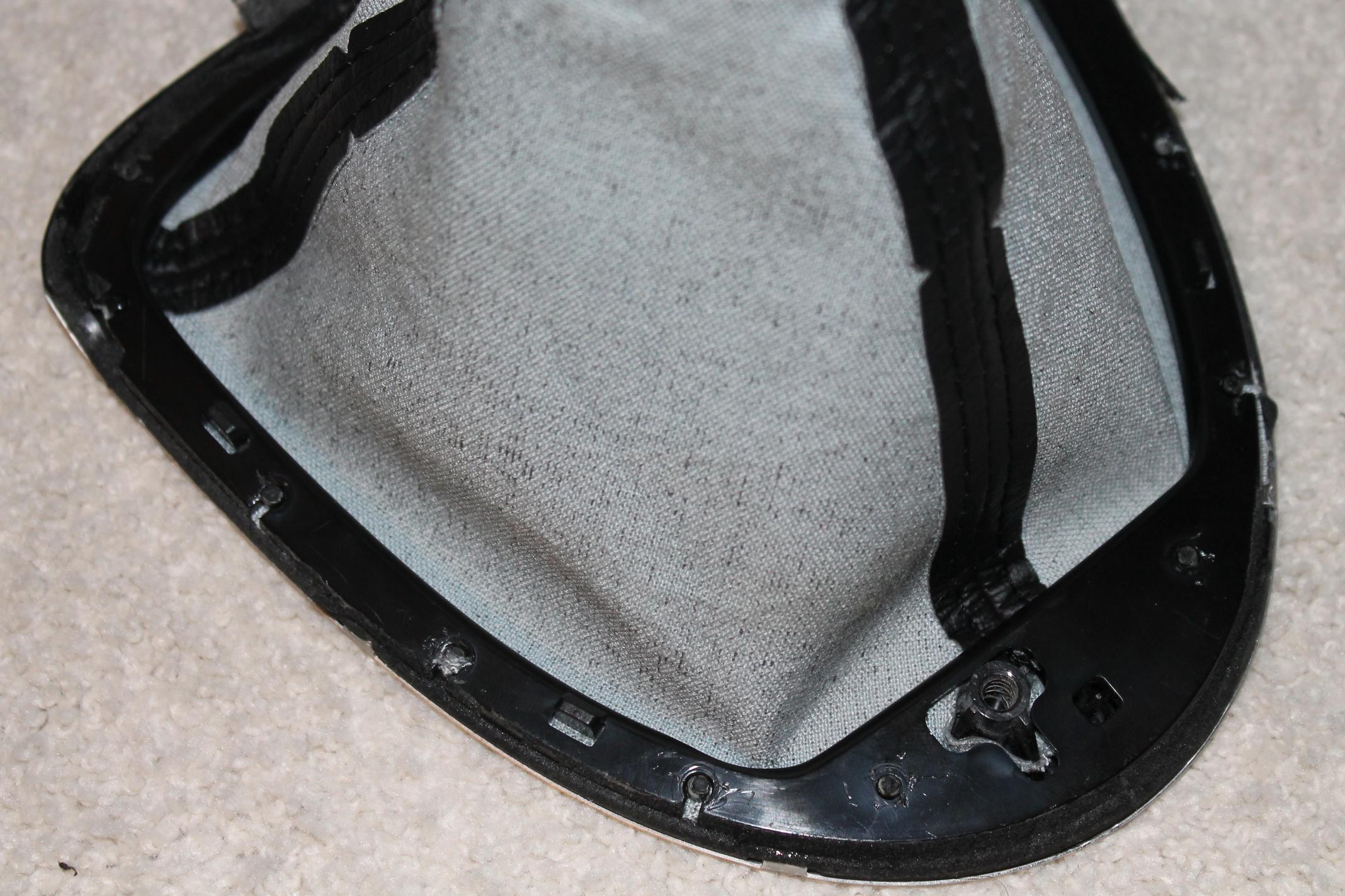

4) Once separated, remove the old boot.

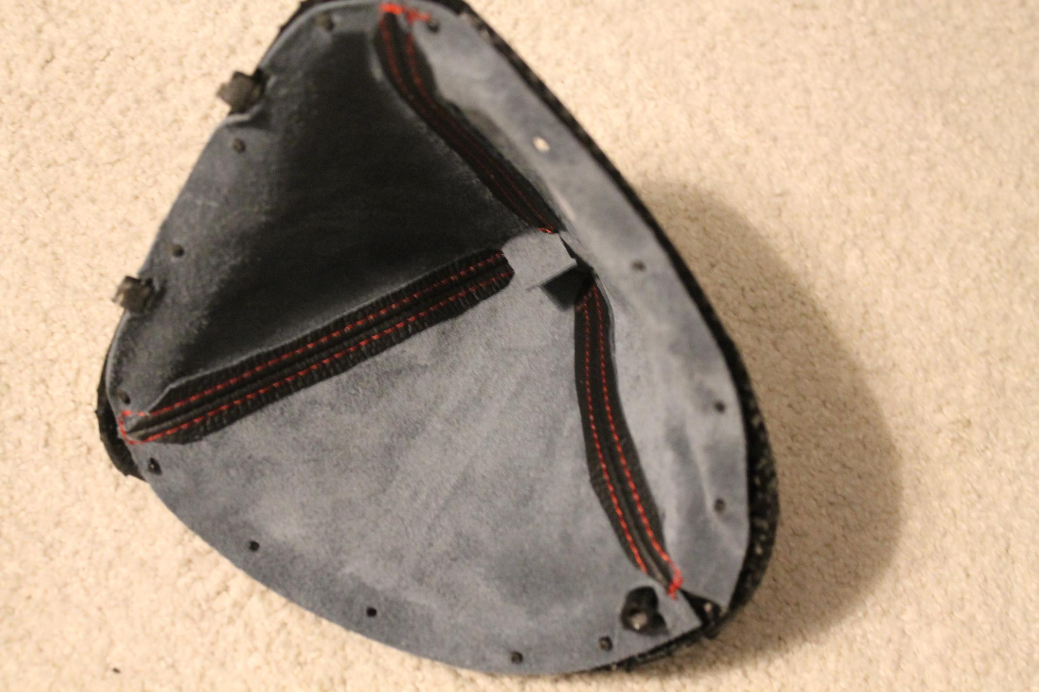

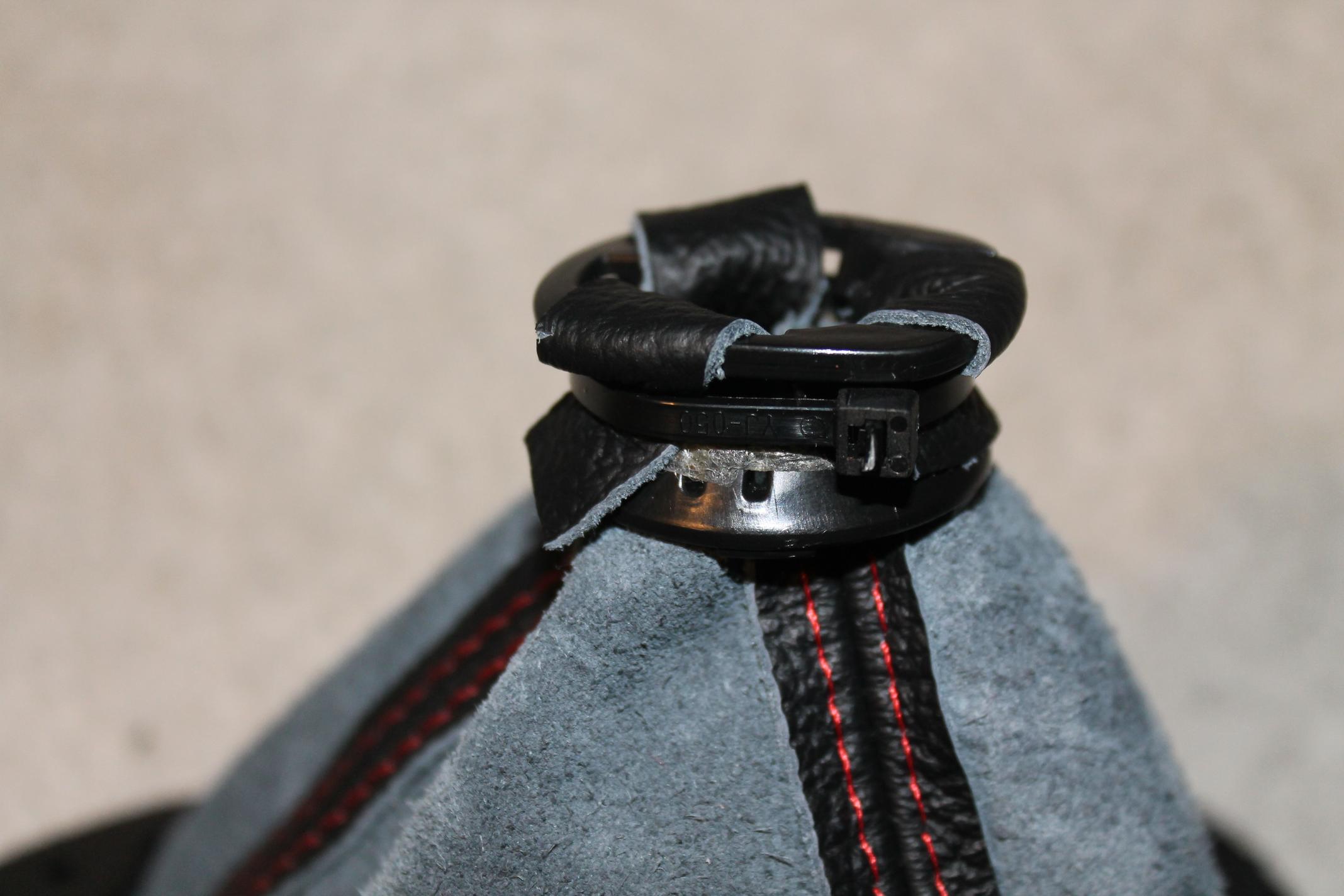

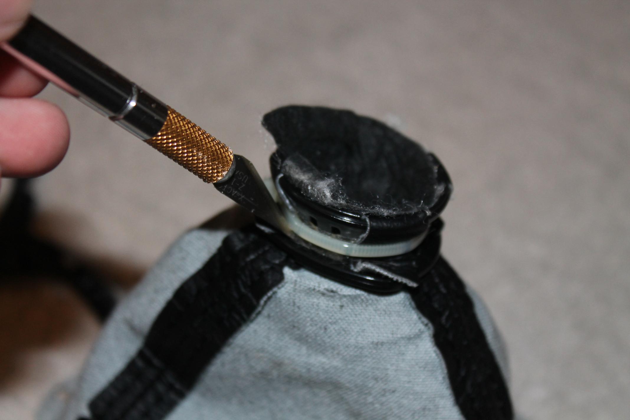

5) With the boot inside out, cut the zip tie that hold the boot retainer to the boot.

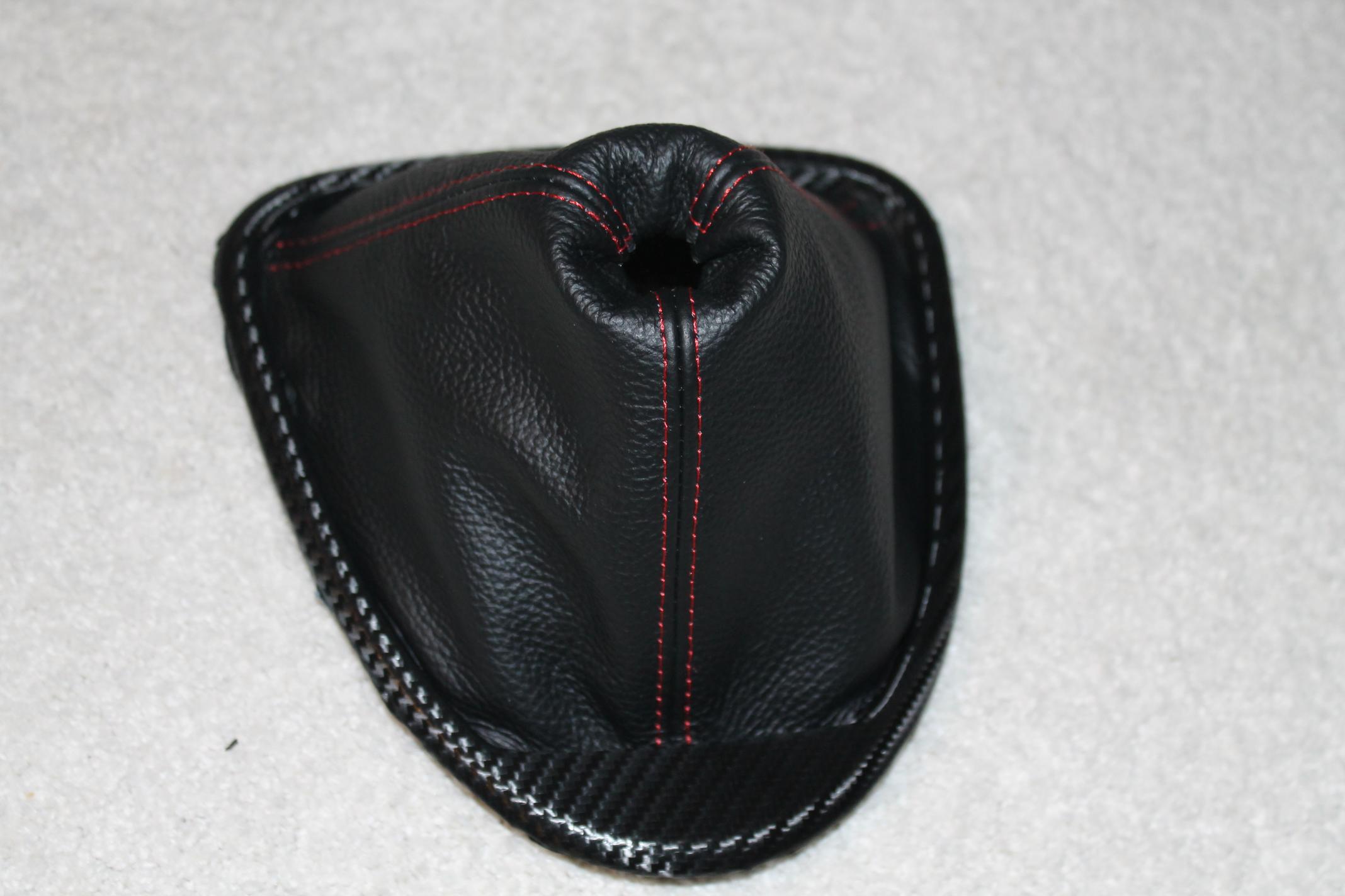

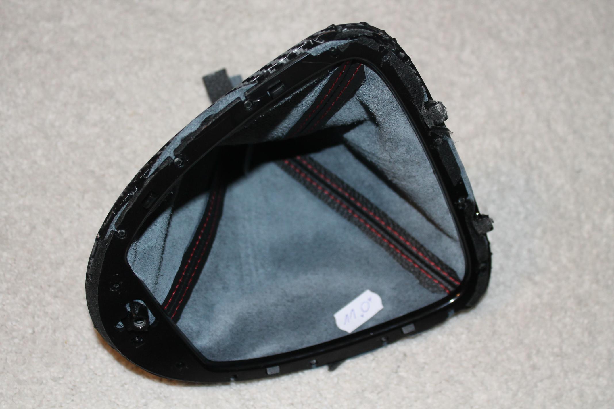

6) If the new boot has the holes pre-cut, align the new boot with the trim holes and guide it on.

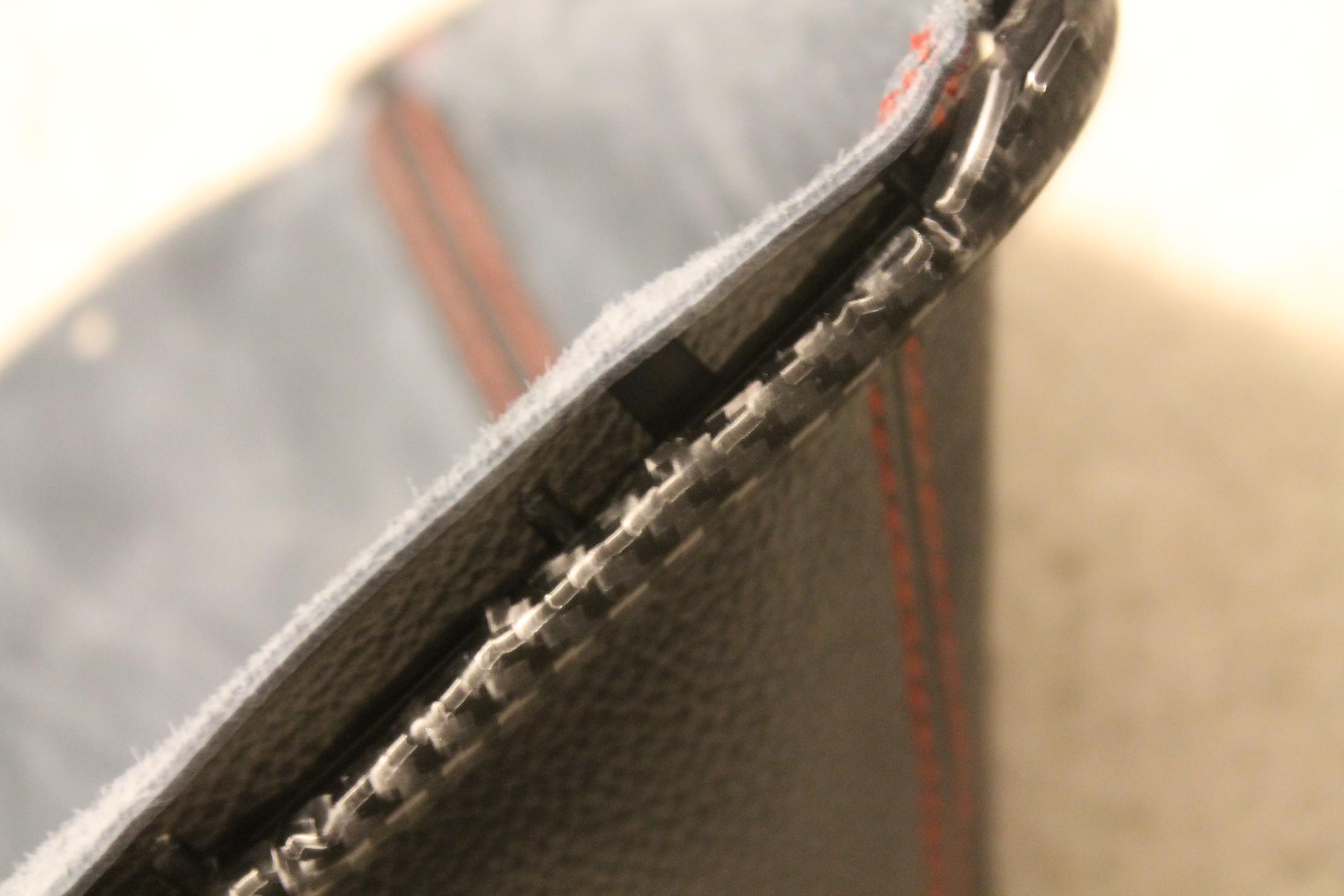

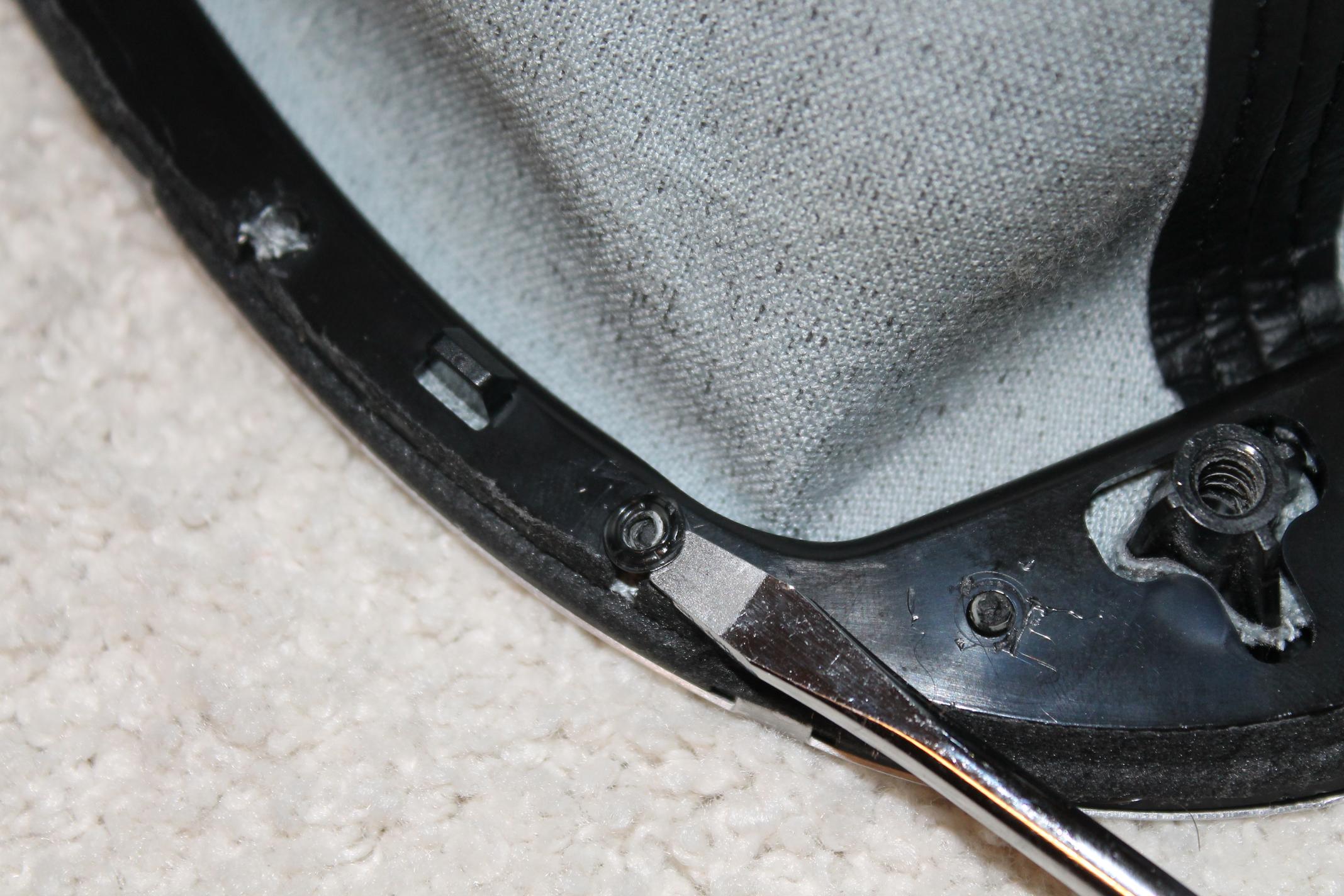

I had to cut holes for the clips
7) Snap the black trim piece over the boot back onto the upper trim piece. Throw out the little circles because they can't be re-used.
