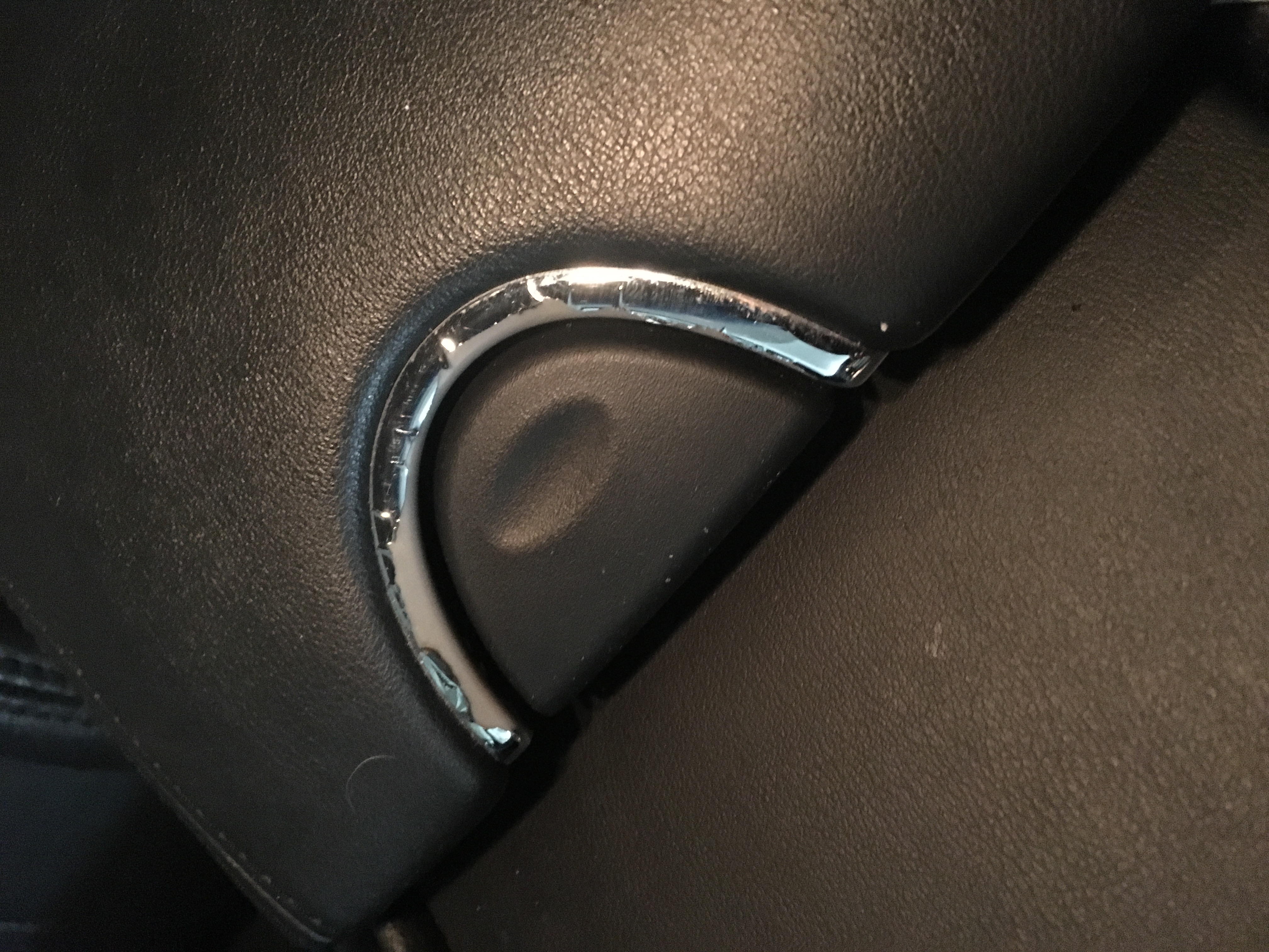

'11 G37x and the chrome trim on the console has started to separate from the plastic leaving sharp edges that I've cut myself on (see attached pic). Any good sources for buying the trim piece without having to buy the whole console? Thx! R

I have the same issue. I was thinking about just sanding it down and either painting or wrapping it.

I'd considered that too. Have you tried to remove it from the armrest by chance? I removed the screws underneath it but it didn't come apart so wasn't sure how it disassembled.

It's pretty easy to remove. I replaced my armrest cover with a Redline Goods cover, so worth it. You just remove the first set of screws and gently pry the plastic apart and it exposes the trim piece to remove. Here are a few pics.
You'll remove all these screws, indicated by the arrow. Remember, gently pry the plastic from the top and it will come off.
The trim is held down by those little screws indicated by the red dots.
