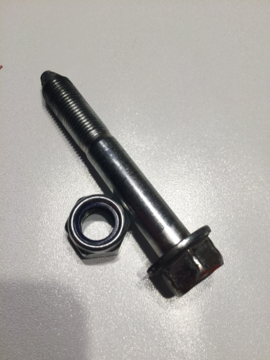

I finally got around to installing my KW’s this weekend and a nut was missing from the box. The nut I am missing is the one that attaches at the base of the rear strut to the axle assembly.
One of the rear struts had this nut zip tied to it and the other did not. of course i had already done the driver side and did not notice the passenger side nut missing until i started doing that side.
I contacted the vendor to see how quick they can get this rectified for me but I am also planning to check home depot or ace tomorrow to see if I can find a suitable alternative.
Does anyone know the specs of this nut? Even if I can just get a stop gap for now so I'm not on my friends lift for a week while I wait for the vendor or KW to help me out.
the nut i am missing is pictured below. the lag bolt is reused from the oem assembly however there is no oem nut that can be reused since it is part of the oem strut itself, and not a separate nut like the KW’s use.

Old Sep 7, 2015 | 12:30 AM
Don't have the specs on that nut but taking that bolt to the store and getting a grade 8 that fits will suffice. I doubt Home Depot would have it. Our local Ace has a great selection of metric grade 8 fasteners however. If you have a Fastenal in town they should have it too, not sure how willing they are selling a single nut though.

Looks like it's an M12x1.25 Was able to find the non-lock variety at Ace. Napa was out of the lock nut in that size also. May have to use this one for now until i can get the lock nut in that size

I was able to find an an all metal lock nut in the correct size. Not able to find much info on the difference between the nylon lock nut vs metal.
Anyone know any issues or watchouts with using and all metal lock nut vs the nylon ones?
You likely have what's called a stover nut. Instead of the threads of the bolt digging into the nylon to create a lock, the threads at the top of the stover nut distort to the bolt to create the lock. For your application there shouldn't be any issues using a stover nut, you'll notice it takes more effort to put on compared to a nylon locking nut though.
Old Sep 7, 2015 | 07:16 PM
This^^^, actually they're more effective than ny-locks. If you want to be extra sure you could always use some loctite.
