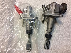

Same CMC?
I bought a new clutch master cylinder from ZSpeed for a 2008 G37. They were very helpful by the way. It looks quite a bit different than the original. See in the picture, there is a large diaphragm or something on the bottom of the original. Does anybody know what it is and whether the replacement I received is equivalent? This extension on the bottom made it extremely difficult to remove. I ended up having to loosen the ABS unit and unbolt the Brake Booster.

I replaced my MC with one from ZSpeed when I replaced my clutch. The biggest difference I could see was that if I had to replace the ZSpeed unit again, it wouldn't be as big a PITA to remove as the stock unit.
