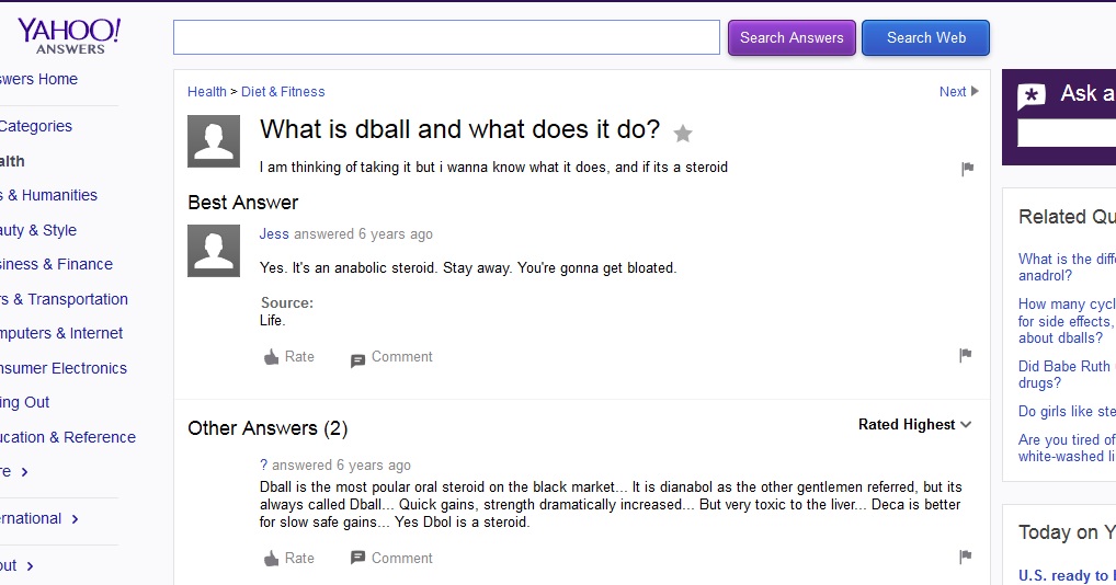

Awesome DIY Conner w/ great details & pics, only thing missing is an explanation of what DBALL is
I had to google it (but I'm old school & out of the loop on such things)
Originally Posted by Presto
Had to Google what a dball is lol
me2
wait, so your car is on steroids?
Dball/dball2 installation diy-xmhbko7.jpg
j/k
Old May 12, 2014 | 02:23 PM
