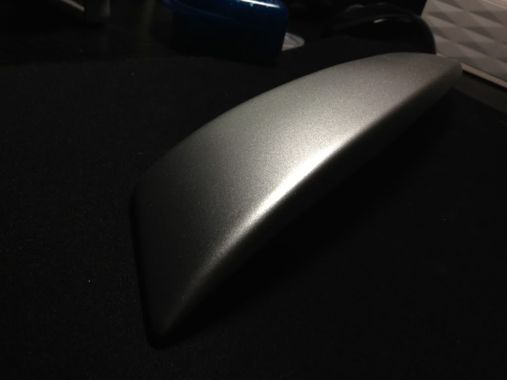

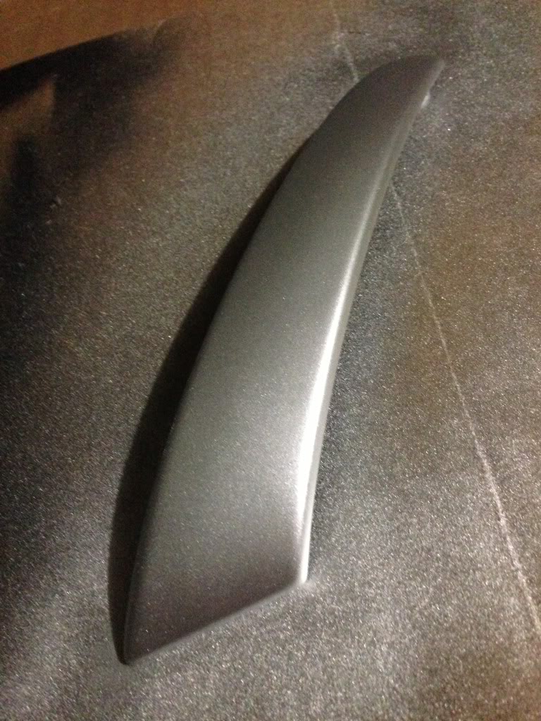

3. Here is a picture before i painted the door trim (after sanding with 100 and 120 grit sand paper)
4. This is the end result (way better than before)
