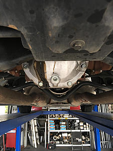

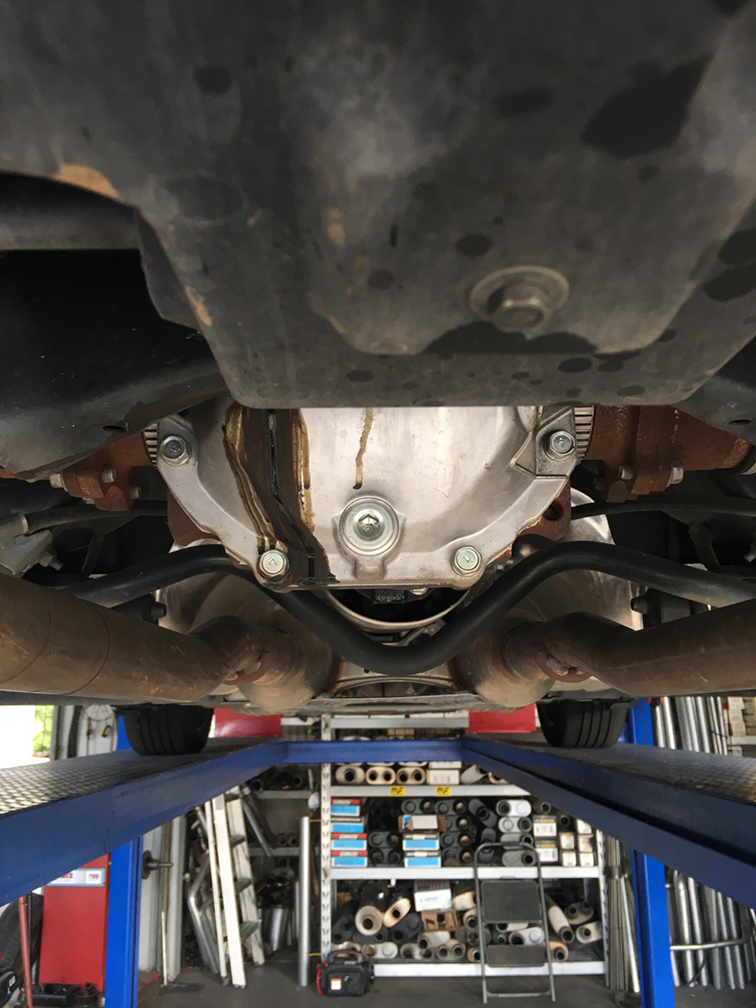

My car was on a lift at a shop last week to discuss exhaust options and I noticed this leakage. After some research, I fear I need to replace the bushings. I'm pretty handy when it comes to minor repairs (suspension, breaks, etc.), but this one looks a bit intimidating. UGH!

You got it man. Just follow the walk through and you'll be golden. Gotta figure, every issue you could possibly run into has been discussed at this point in post #163.

The repair is difficult but not impossible for a DIY'er. Just be prepared and have tools handy for different situations and what helped me through the process was before the job, I ensured I was able to loosen my exhaust bolts. If they're in 'ok' condition but their seized up, have an impact handy to break them loose.
I listed a number of thoughts on the repair on the post above yours. Ask me questions and I'll try to answer them to the best of my ability.
