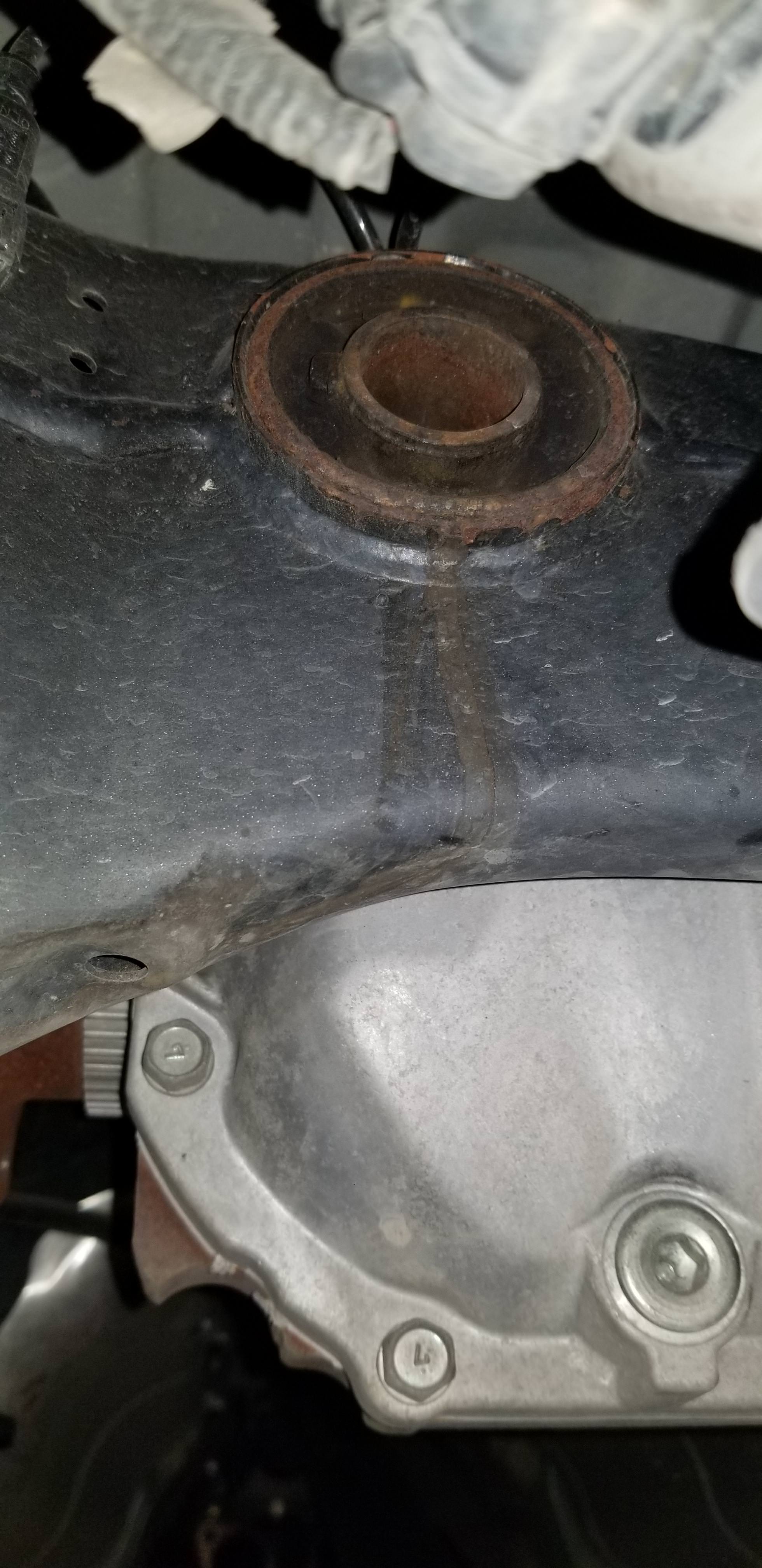

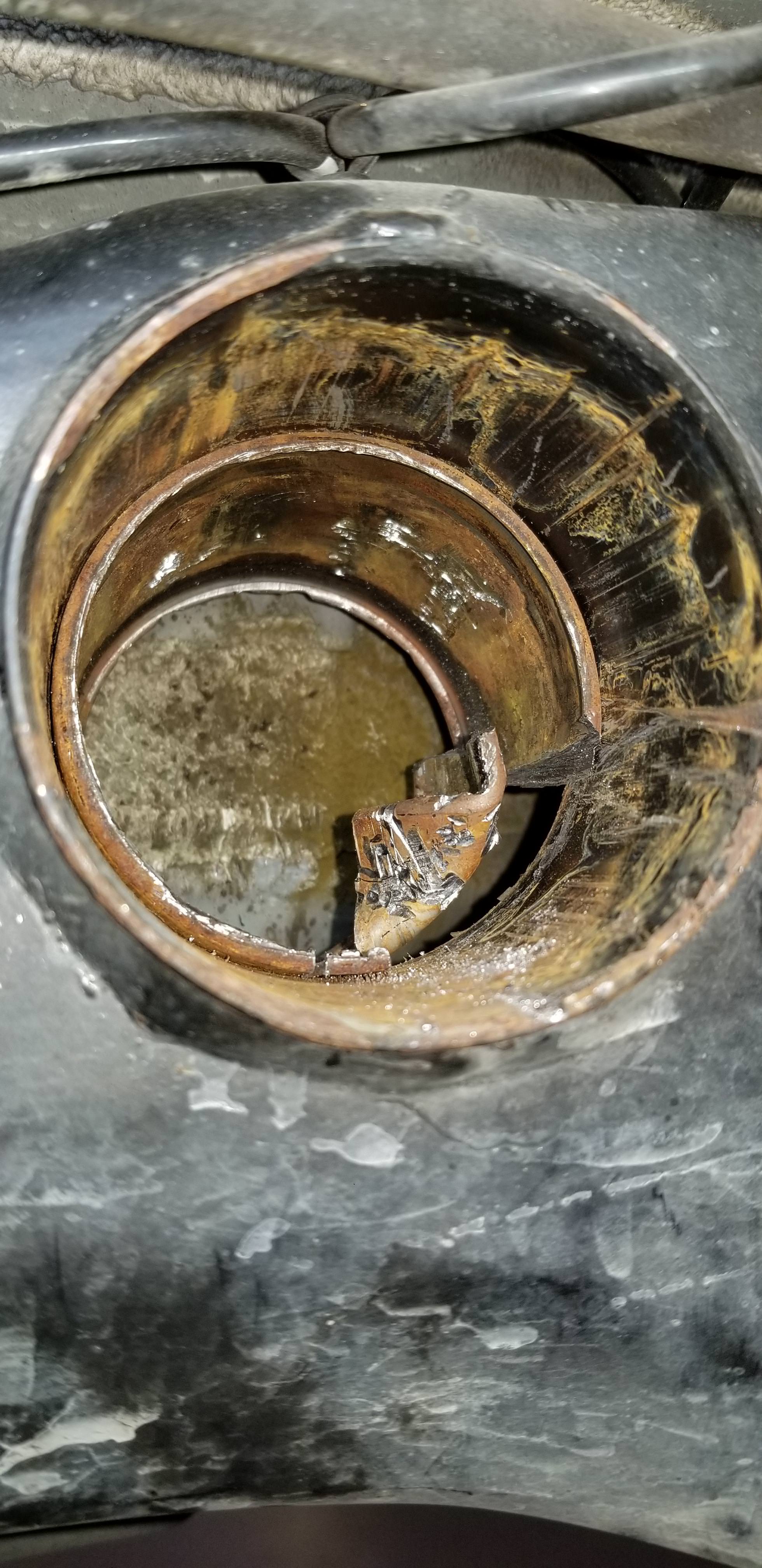

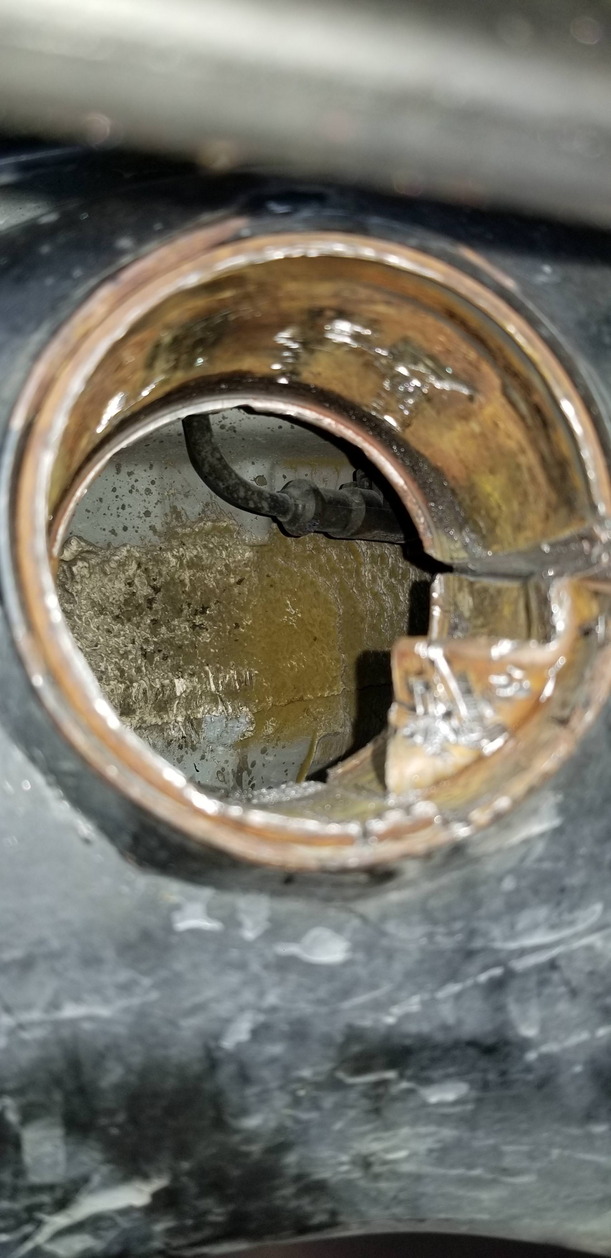

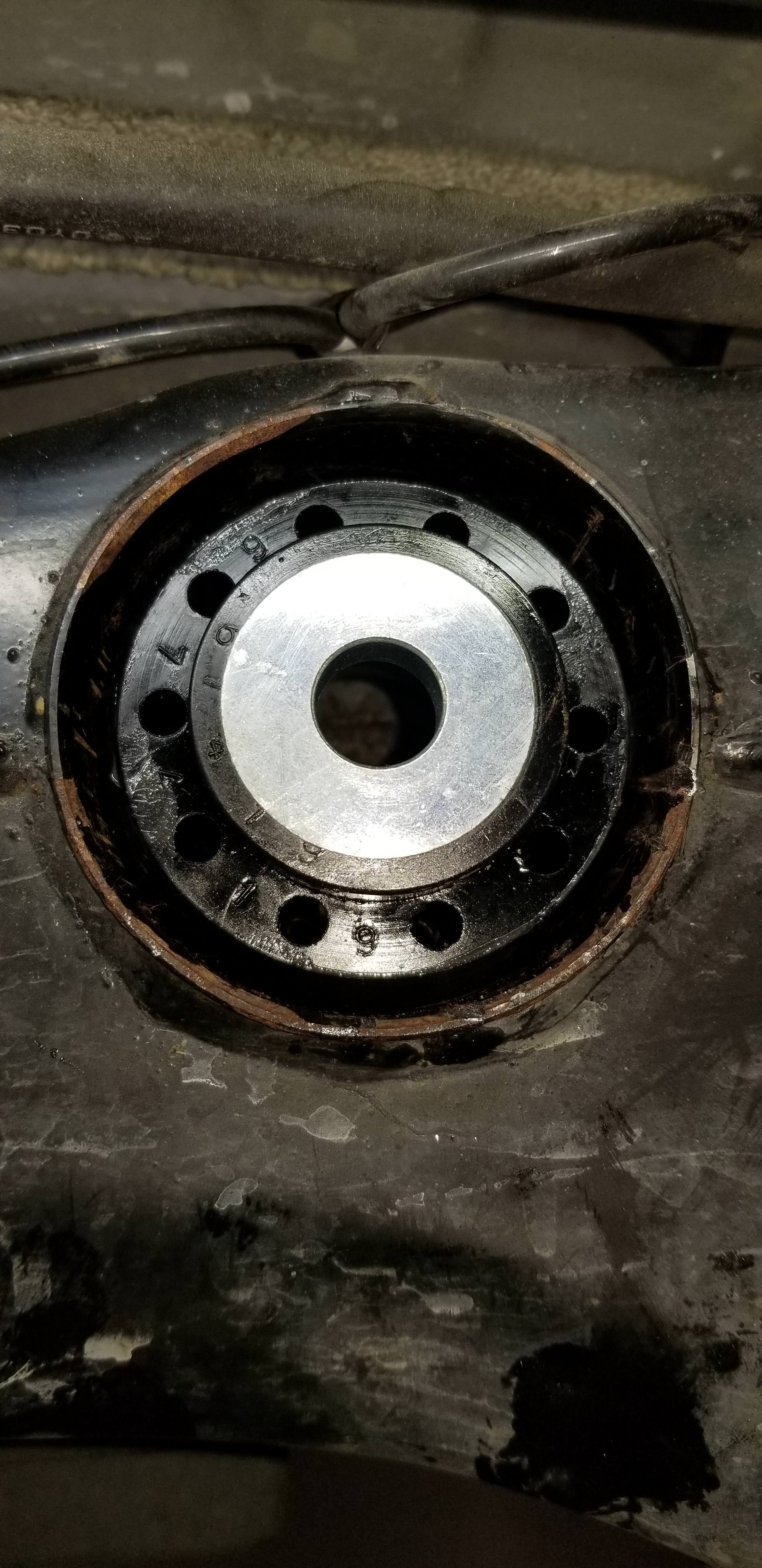

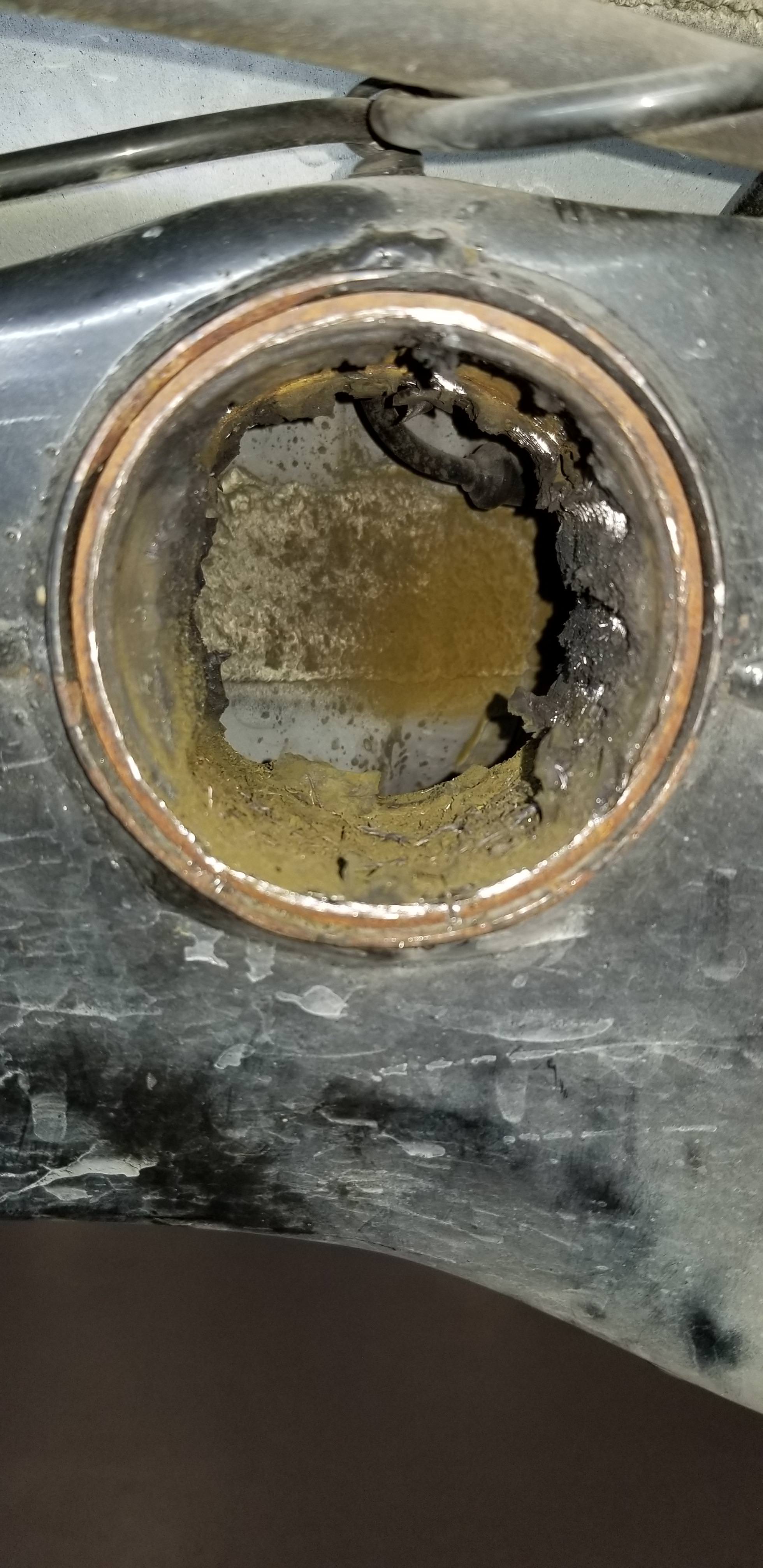

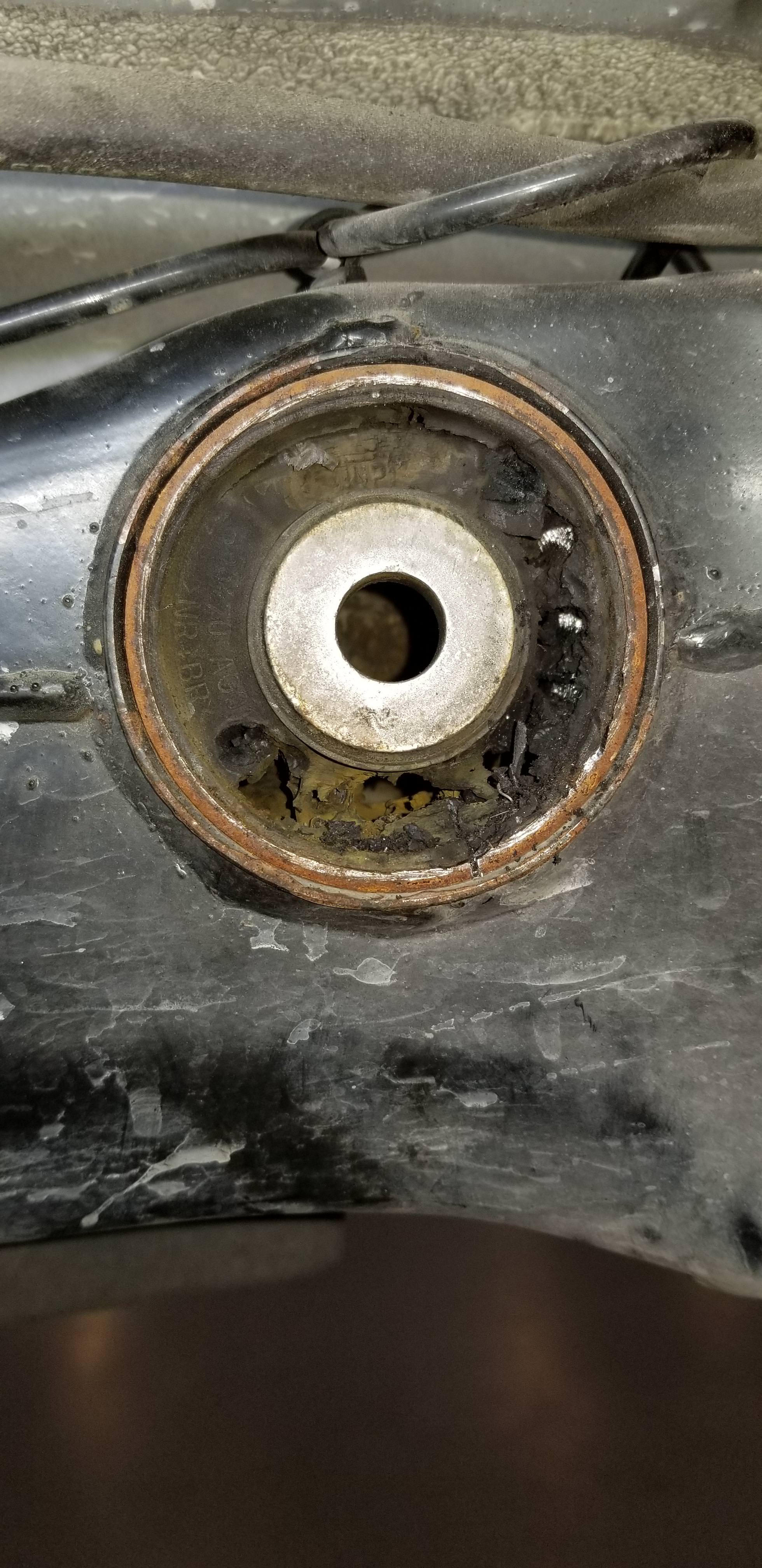

I just installed a 3.692 diff in my 2011 G37S and installed these KDT911 Whiteline bushings while at it.
The 2 "ear" bushings on the differential itself came out easily using a 34MM axle nut socket and a 2.5lb hammer.
OP said he got the rear subframe bushing out in 2 minutes?! This was the most pain in the *** part for me. Between drilling the entire core out and using a sawzall with a old 24T blade it took me maybe 45 minutes. I even had the car up on the lift lol. I blame the blade. It was a old worn out diablo 24T and wouldn't cut for ****.
Whiteline bushing install was easy. I put the Whiteline subframe bushing in a plastic sandwich bag and put it on ice over night. When it was time to install it I lubed it and used my puller and it went in fast and easy.

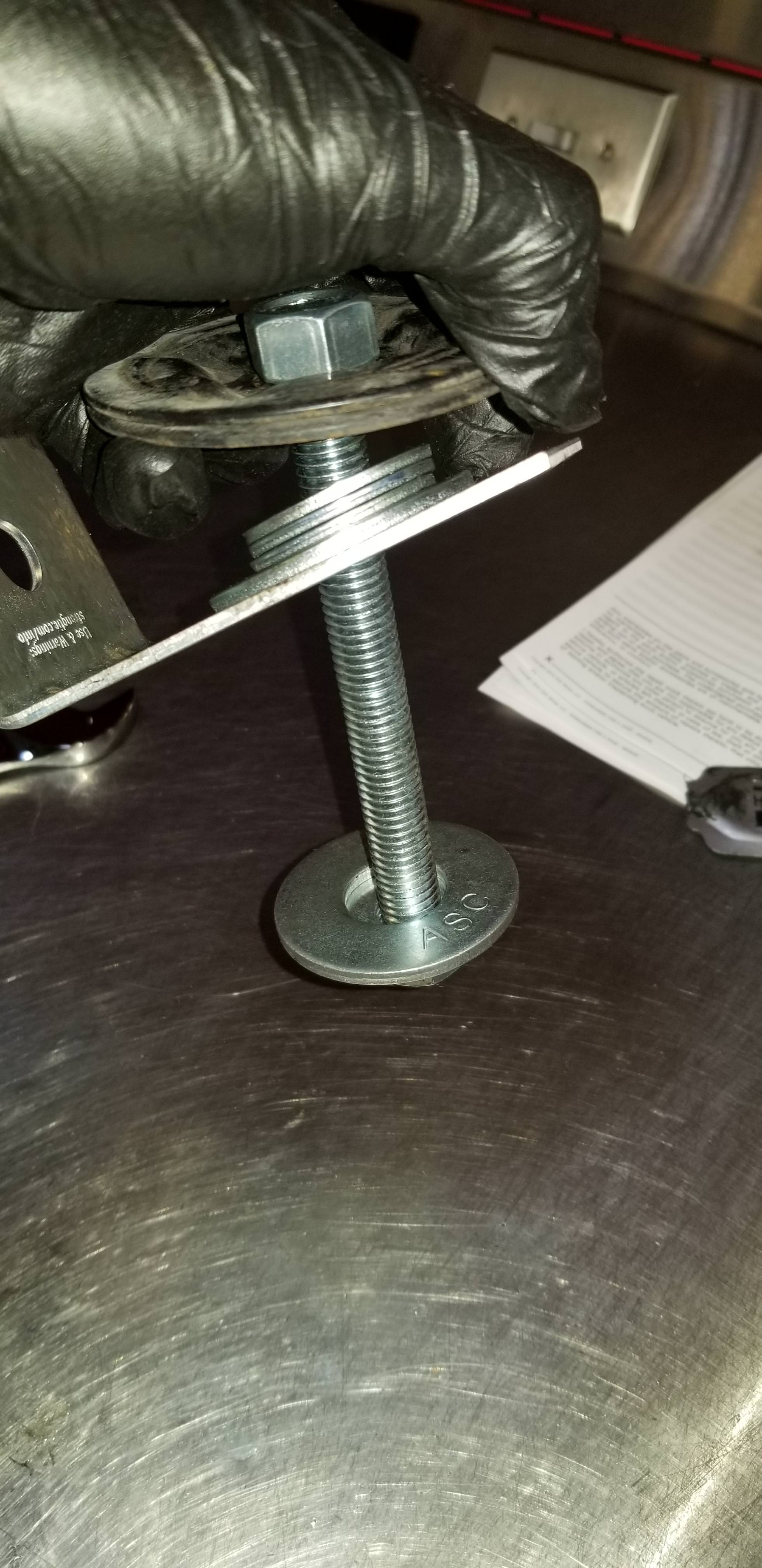

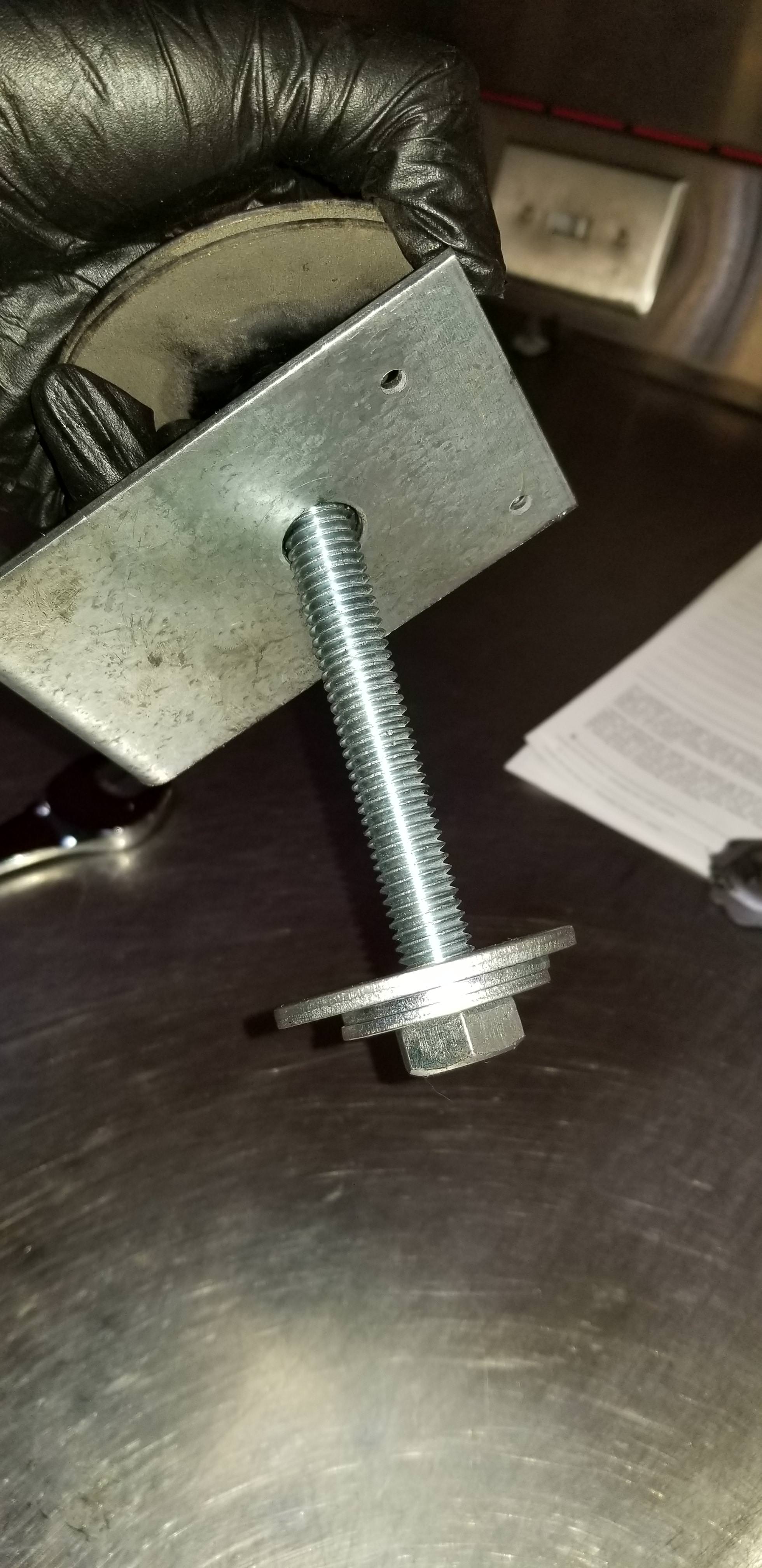

Prior to installing this I watched plenty of videos and read threads on people giving the advice of going to a hardware store and simply buying parts to make your own puller.
Not a single thread made a list of what size washers they used so I'll do someone else a favor and post what I bought.
Home Depot
$3.27 - Frame Anchor - 2in x 4in angle framing anchor (1)
$0.20 - 1/2" Hex nut (1)
$1.21 - 1/2" x 5" Hex bolt (1)
$0.80 - 3/4" washers (2)
$1.00 - 1/2" washers (5)
All these parts ~$6.50 total. Use a 3/4" or 19mm wrench to hold the bolt and the same size socket or ratchet wrench to turn the nut which will pull the bushing into the subframe.
I'll post pictures later on the puller setup and a picture of the receipt.
I bought 5", 6" and 7" hex bolts because I was unsure the length that would be required, but than I ended up just using the 5".
They were about $1.xx each so I figured I would be safe buying numerous lengths.

I forgot to mention I installed the thick bushing up top and did not use the black washers. Thinner bushings on bottom.
No driveline vibration noticed yet. Will report back if things change. Did this @ 75k miles.

Great pics dudes. It's great to see the different types of makeshift bushing presses. I used an iron floor flange as my press and it fit perfectly over the bushing hole.
