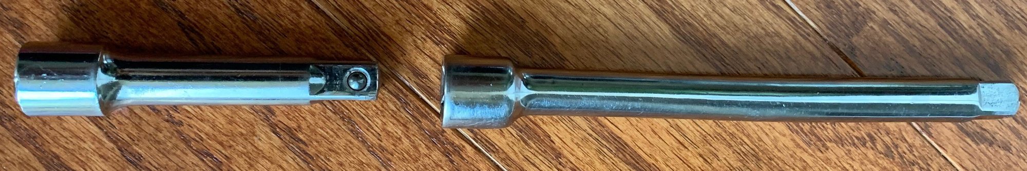

I ended up doing this job back in October. It took 3-4 hours, but I took my time. Next time I'm sure I can do it all in 1.5-2 hours if not less. I wanted to contribute something that really helped me:
As everyone stated, loosening the front differential plugs was initially tough as the sensor is right next to the drain plug. However, there is a much easier way to break it loose without even worrying about the fuel sensor. What I ended up doing was using two 3/8 Inch extenders. 1/2" would be too large, so must be 3/8". The extenders I used is something like this, but I did not use this exact kit as I already have several extenders. You have to combine a medium length extender with the shortest extender to get enough clearance to be able to use a ratchet on the other side. If you were to use two medium length together then it would be too long to be able to squeeze in the ratchet. Doing it this way then one most likely won't even need to use a low profile hex bit either. I was able to break the bolt loose in mere seconds. I tried the vice grips earlier and it was just way too hard. Luckily, a neighbor who is a mechanic saw me struggling and suggested the extender idea.
Another tool that really helped was a 3/8" Ratchet from HF but it extends in length by sliding the handle so if you need more leverage you can get it instantly and can shorten it if in a tight spot. I just needed this one "length adjustable" ratchet for the entire job, I can't seem to find it on their website at the moment to link to unfortunately. I hope they still sell it. I ended up returning the breaker bar since I didn't need it.
Also, it was a pain to obtain the proper Matic J fluid for the Transfer Case. Most Nissan dealers no longer sell/stock Matic J fluid. One Nisan dealer claimed they had it, but once I got there and asked for "Matic J" he gave me Matic S saying it replaces/surpasses Matic J. We went back and fourth and I ended up just buying Matic J from the Infiniti dealer next door. It cost much more at Infiniti but luckily I asked politely and they ended up giving me a significant discount, still cheaper then Amazon, who is the only other place I know that sells Matic J other then Infiniti.
Thanks again for the tutorial and everyone else's input. I enjoyed this project overall and the gears/power delivery feels more smooth and the very occasional hard jerks I would get have vanished as proven by going on the 1500 mile road trip right after the job. As everyone else said the rear differential fluid was absolutely dirty and smelly at 52.5k miles. Also bunch of metal shavings were removed. I kept putting the drain plug in and out until there was no more shavings coming out. Finally, wanted to confirm that the gasket is exact same for the Transfer Case and the Front/Rear Differentials. I ended up re-using most as they were in great condition. I only replaced the drain gaskets for each.
Image below of the two extenders I combined:
Good advice on the two extensions. I too have an "on-the-fly" adjustable length ratchet from HF. It has been very helpful for many jobs that are tight space, then needing more leverage for the next open bolt and not having to switch tools.
I didn't use Infiniti/Nissan gear oil as many people used Amsoil instead. When i went to buy my Amsoil, I saw these and they worked really well as they were flexible bags and fit into the tight spaces and I only had to use the pump on one differential (dont recall which one).
