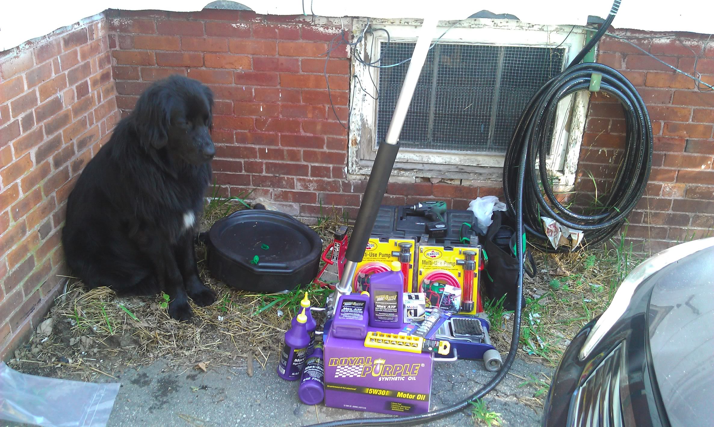

thats my helper on the left, quiet and useless aside from company. assorted tools and stuff. i changed my front, rear diff, transfer case and engine oil that day hence all the stuff.

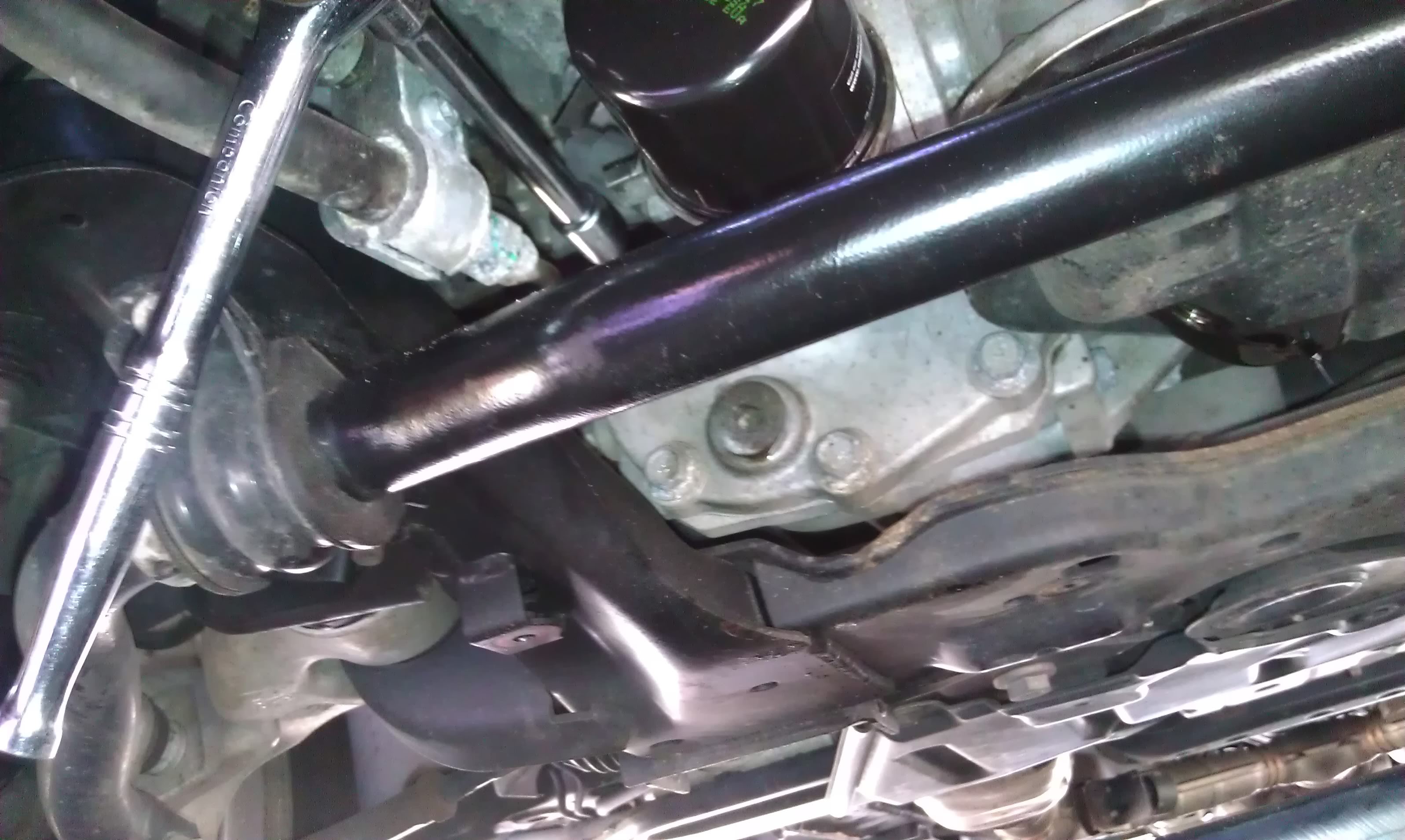

front diff, that's the fill hole where my ratchet is. you have to remove several 10mm bolts to gain access to this area, i took the whole panel out instead of bending it around, sorry for no pic.

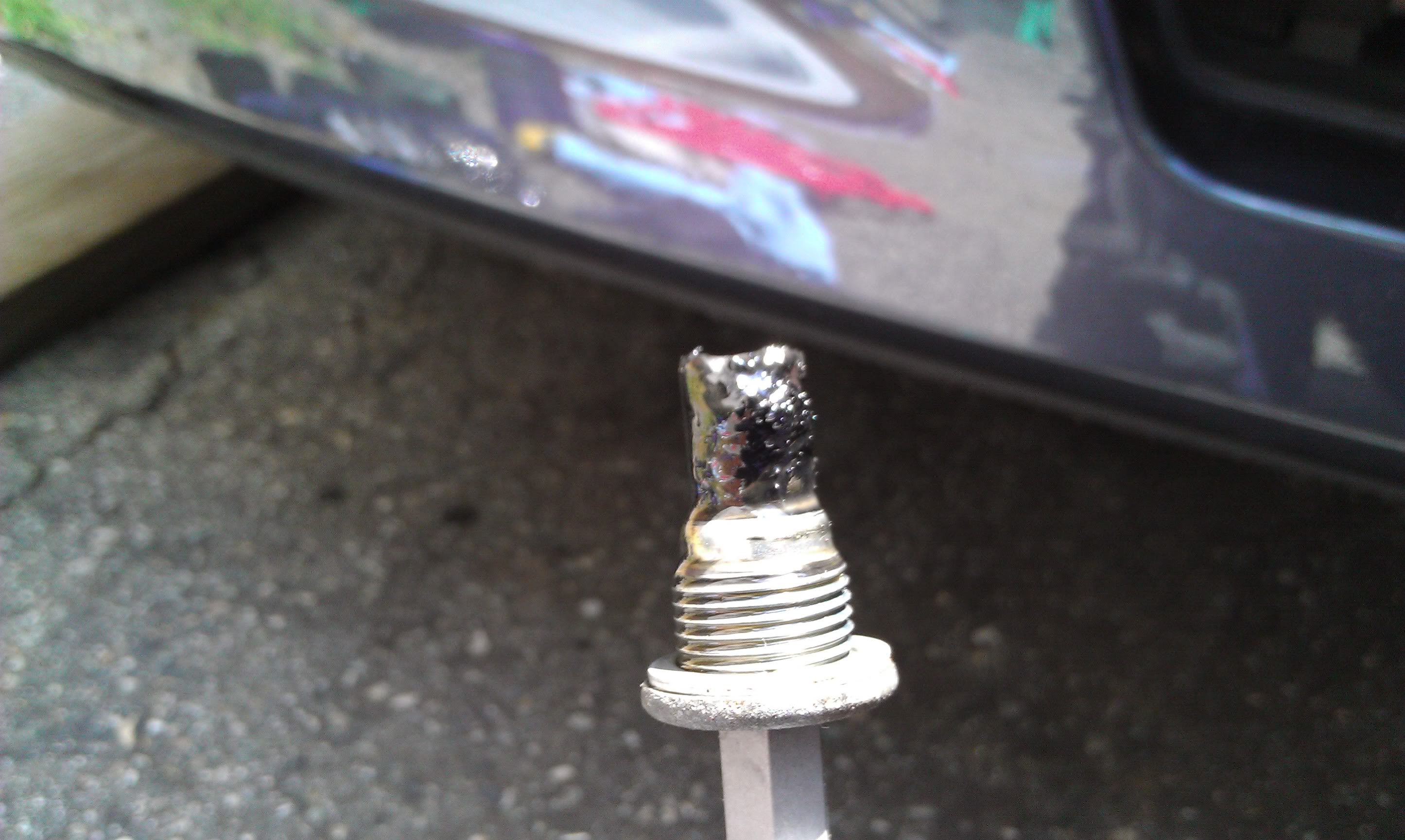

dirty magnetic drain plug, you may want to reinstall the drain plug a few times before refilling the diff to get all the metal shavings out. i did it 3 times before it wasnt picking more out.

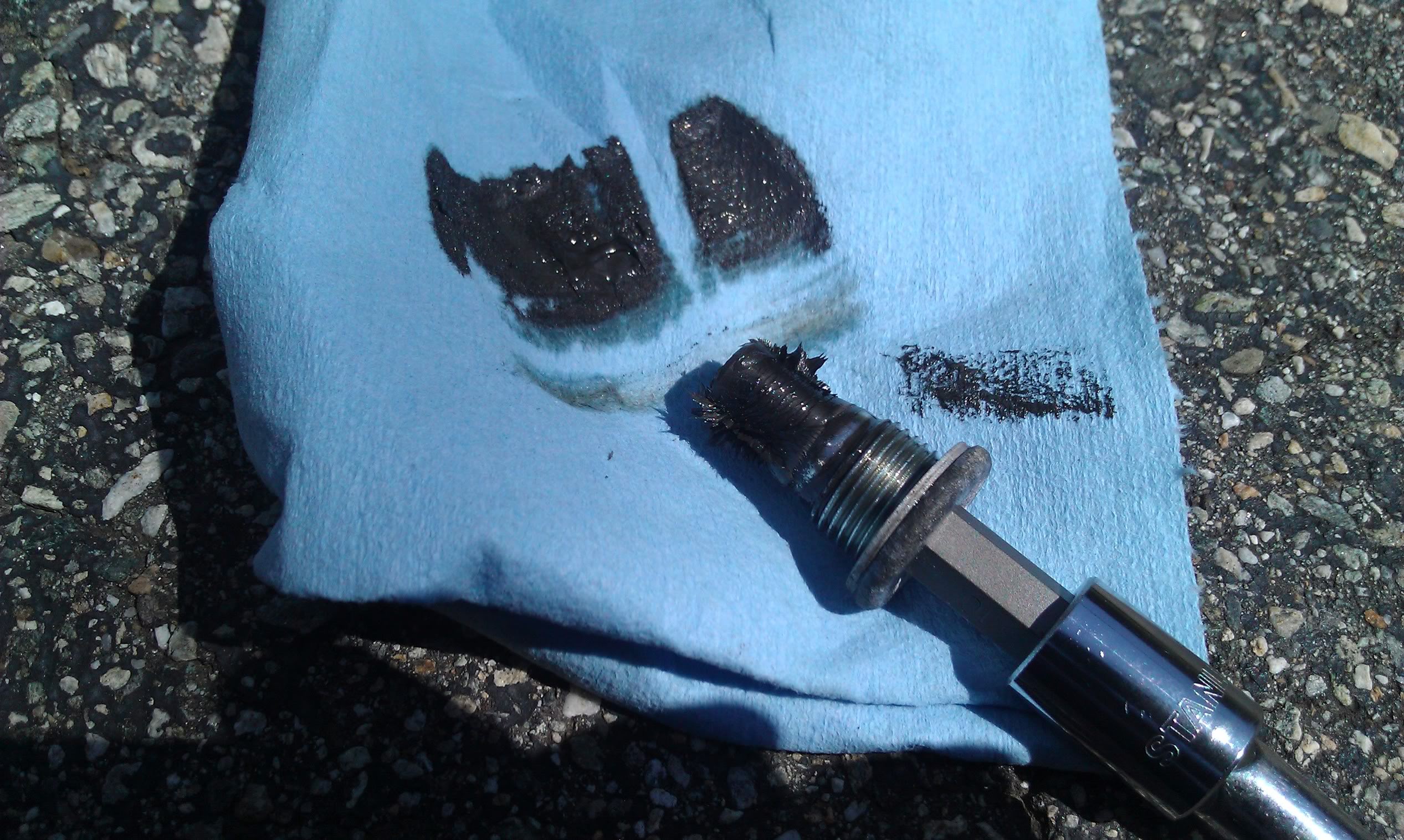

drain plug wasnt too dirty
