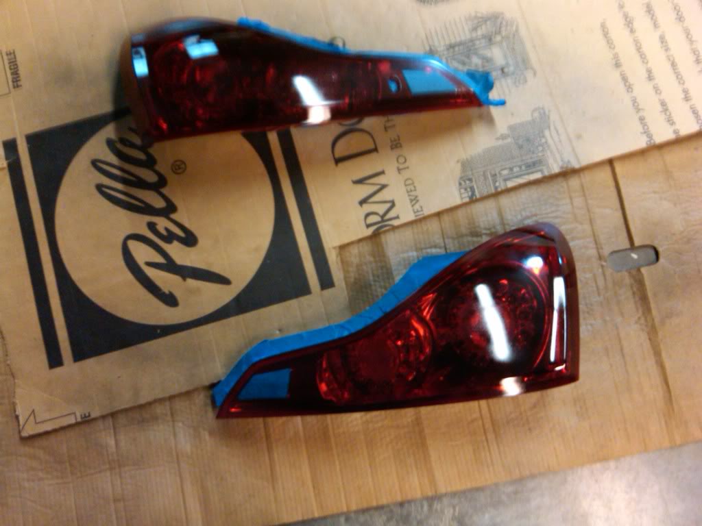

I found this quite easy to do once I got the light out...besides taping off the reverse light...I probably re-did it about 10 times...I'm not satisfied, lol

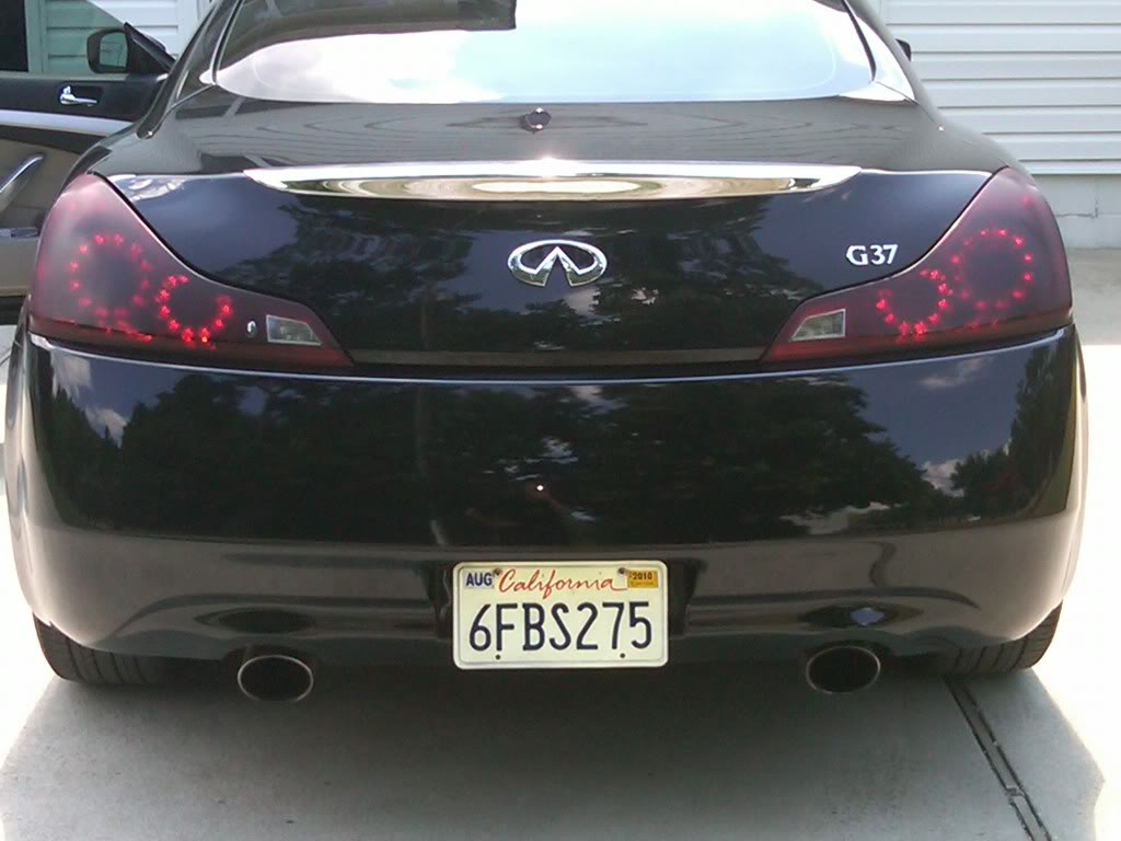

final outcome. thank you for the DIY wakeboardr116!
sexy!
They look great man. Glad I could help.

Ok so this is my first coat....I noticed that I can still see some swirls from when I sanded. That should go away after clear coat, rubbing and finishing right?
Yeah everything should smooth out after you finish the clear coat and wet sand.

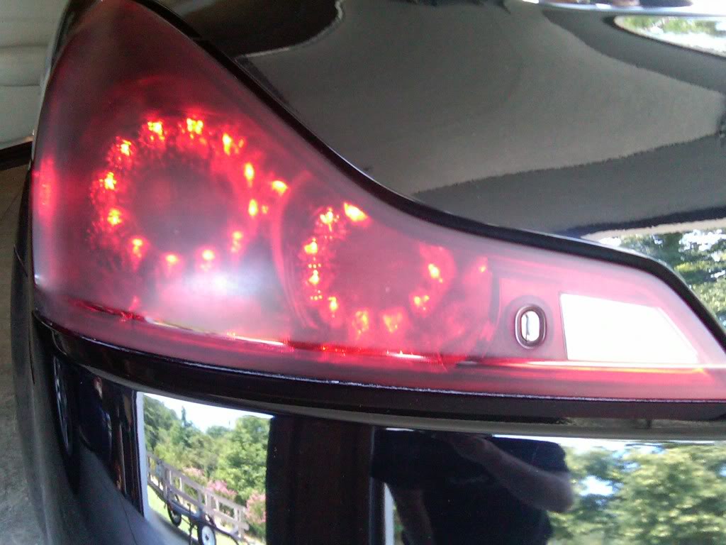

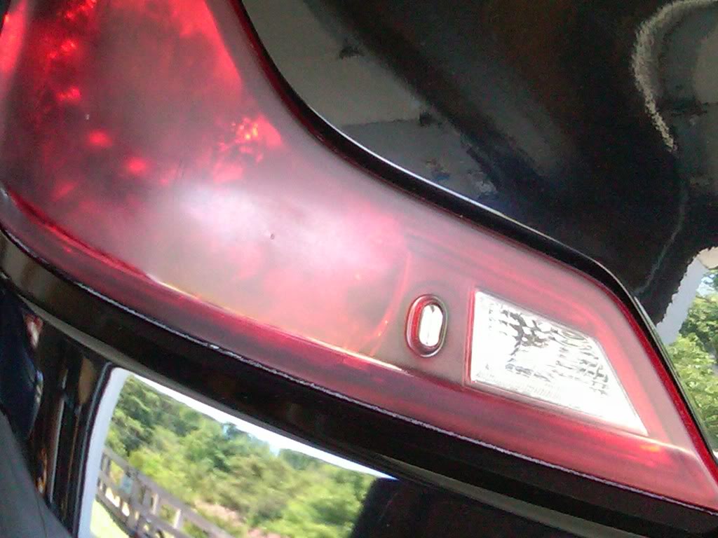

Well...I wet sanded, put them back on my car, buffed with a rubbing compound then buffed with a polishing compound and I don't quite have what you have. They are smooth but not shiny. More like a matte than anything...also when I buffed them the paint came completely off on the curves of the lights...
I followed everything exactly on here...
They were shinier at the beginning than they are now...

rubbing compound to remove scratches&swirls
follow it up with paste wax
should do the trick, which did mine.
time to put 2 hours

Compounding can take a bit...make sure you are using a Random orbital and using a good compound/polish to get everything smoothed out it is super easy to go back and correct any errors with this mod
Old Jul 11, 2010 | 03:30 PM
  #89
Nosnibor's Avatar
Nosnibor
Joined: Feb 2009
Posts: 724
From: 757
Mine is a random 6 inch orbital. I'm using M3 rubbing compound and Turtle Wax Polishing compound. After I saw what happened to the edges I was afraid to press any harder...Does this mean I need to start over?
Old Jul 11, 2010 | 03:49 PM
  #90
hispeed-lowdrag's Avatar
hispeed-lowdrag
Joined: Apr 2009
Posts: 4,190
From: Pensacola Beach, FL
That's really weird that it came off...I used my PC with an orange pad and a fairly aggressive compound and put a good 10-15 lbs of pressure on it...so I doubt it was how hard you were pressing.
I don't know, maybe it wasn't cured or something...did you let it cure overnight before compounding/polishing?
