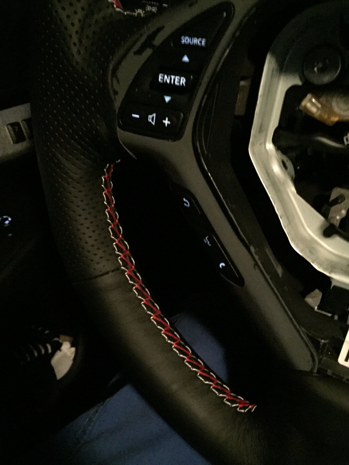

No actually.. My stitching pattern worked well. It is pulled tight and all corners are tight. I used a hair dryer to heat the leather so it would stretch and I pulled it tight before placing the stitch. I'm going to remove the trim to get it to tuck.
I wasn't a fan of the every single stitch so I went with every other.. Defiantly requires more concentration
Now the tape.. I went back and forth on using it. For me I wanted the ability to make the last minute adjustments in case it wasn't fitting properly when I was stitching. I really think that if I hadn't used the hair dryer to heat and stretch the leather it would be a different story. I'm pretty OCD about neatness and fit. I'll get some pics up later today when I get it all tucked

Excuse the blown airbag, but I'm pretty pleased with the results.. I did however use different thread than provided and I noticed some fraying of the red. Time will tell if it will hold up. I probably grabbed the wrong type of thread I guess, I dunno.
But anyways here are some pics after its all tucked in nice and pretty like
