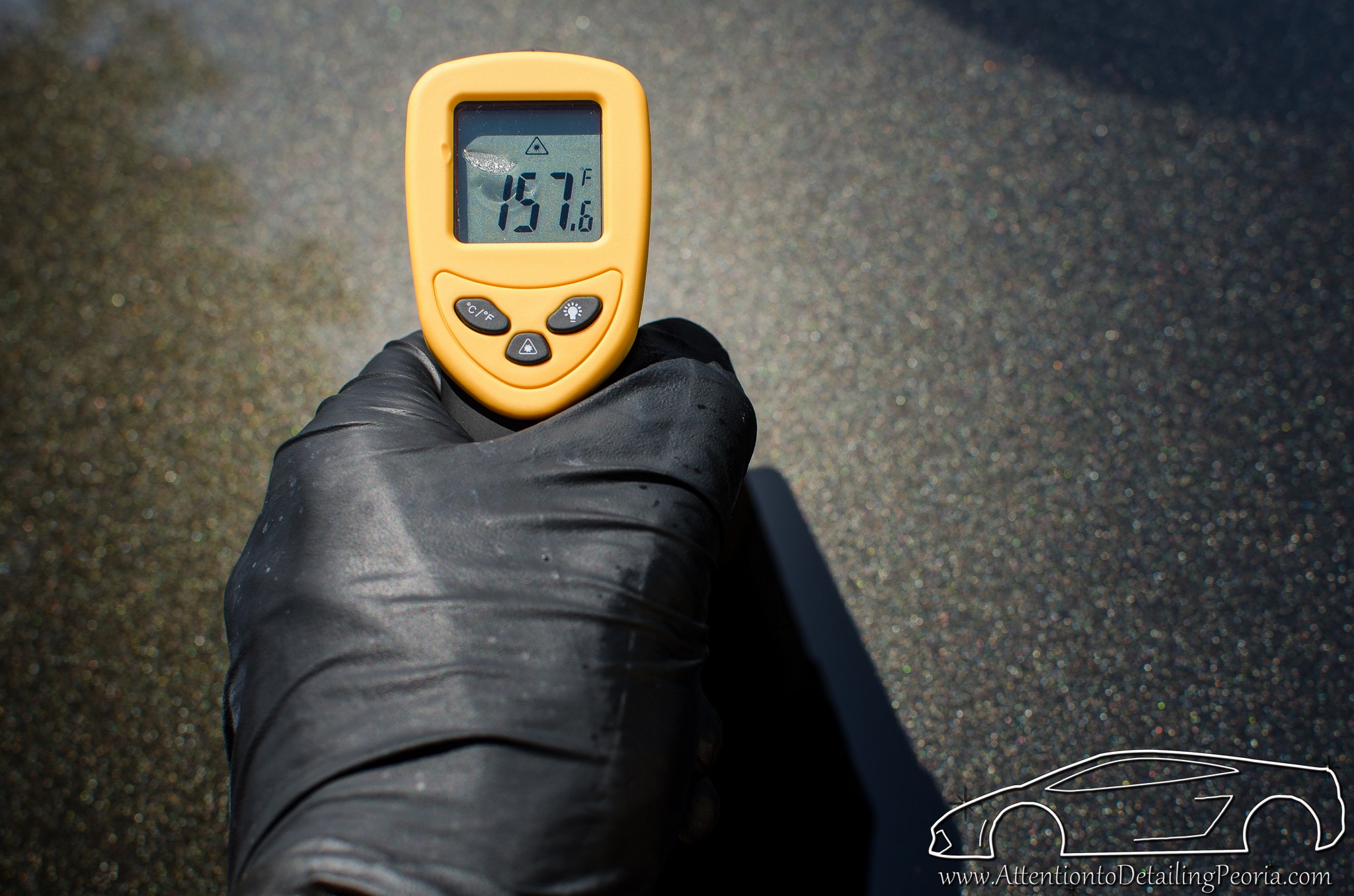

Originally Posted by PanzMan
I was under the impression that you should NEVER use hot water on your car's finish.
Warm/Hot water should not harm your paint. Think about how hot your vehicle gets sitting outside under the hot sun.
