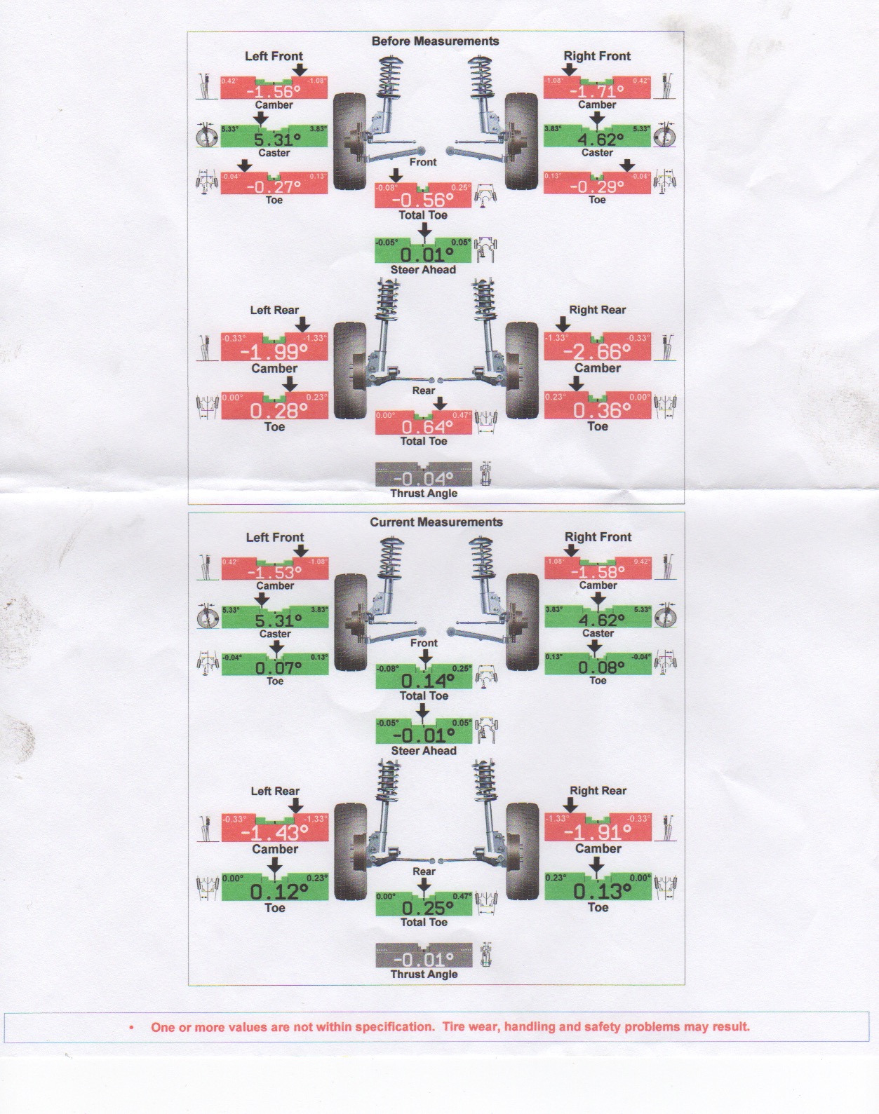

Hi guys,
I recently installed a new set of wheels and tires. My car started vibrating at 65+ mph every since. It's been doing so before and after alignment. I thought it was the wheel balance that was off even though the wheels came pre-balanced. So I took my car to a shop to get a road force balance. It only improved a little bit, or so I thought. The vibration is kind of bugging me. What else could be wrong?
*Please note that I installed the BBK at the same time. My alignment is kind of off too but that was the best the mechanic can do.
One more question: Can someone explain the alignment results to me and tell me if I need a camber kit? Sorry I'm still learning

Your right rear is the only point that's off by much. I'd get a rear camber & toe bolt kit, this consist of four bolts (2 on each side) for the OEM camber arm and a new toe bolt. you have to elongate the slots for all 4 bolts w/ a dremel tool, not hard if you don't mind getting under your car and doing a little grinding.

1) Actually the vendor gave me a set of plastic hub rings when they sold me the wheels. I don't know what size though. Do you think I need a better set to resolve the vibration? If that's not the problem, what do you think could be the cause?
2) Besides uneven tread wear, what elso would happen if I keep the alignment like that?
