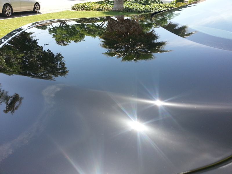

So I bought a CPO '12 Black Obsidian G37S last April and the only thing that I was not happy about were all the fine swirls and scratches left behind from the previous owner.
I was getting ready to find a local detailer until I ran across a few threads of BO paint correction (Black Betty's, G37sEugene's). The results they achieved inspired me to try and do it myself!
I used the following:
PC7424XP
Mother's California Gold Clay Bar
Meguiar's M105 w/ LC Orange Pad
Meguiar's M205 w/ LC White Pad
Poorboy's World Black Hole w/ LC Black Finishing Pad
Meguiar's Ultimate Wax w/ LC Black Finishing Pad
50/50 Shot after M105/M205 test section:
Hood:
Trunk in sunlight:
Rear Shot:
Needless to say, I was very happy with my results! This is my first black car and how easily dust and light swirls show up does annoy me. However, when it is clean, nothing beats it!
