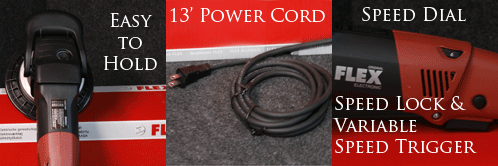

The buffer feels relatively light and very solid as any good buffer should. It’s listed as weighing 5.75lbs which is exactly the same as the PC. I'm extremely pleased with the location of the two grips, primarily the top one. My right hand is placed low, near the trigger and my left hand is above the pad (approximately 3.5 inches) so your hands are at 6 and 12. With the PC (no handle) and rotary buffers I typically have my hands in a similar but slightly different position. My right hand is typically towards the bottom of the buffer and my left hand is typically positioned directly on top of the spindle applying downward force. This leaves my hands at 6 and 12 but I'm far more likely to exert pressure more towards the bottom of the buffer. With the Flex design your hands are more evenly spaced out above and below the spindle so you are more likely to exert even pressure across the pad.

The Flex XC3401 VRG and Porter Cable 7424 have some similarities and differences that are outlined below. Both buffers move in a random orbit or oscillating motion, designed to replicate a hand buffing motion. They are both approximately 5.75lbs and use a six inch Velcro backing plate. The Porter Cable 7424 requires you to purchase an aftermarket backing plate while the Flex buffer comes with a built in 6” Velcro backing plate. Both buffers are typically used with 6.5 inch pads while they can use most Velcro pads over 6 inches. This means that most pads used with the Porter Cable 7424 will be compatible with the Flex buffer. The Porter Cable 7424 has a speed dial that is the only means of adjusting the speed. The Flex buffer has a speed dial which sets the maximum speed you can reach with the variable speed trigger. Hold the trigger down lightly and it will operate at low OPMs and squeeze it tightly to reach the maximum OPMs relative to what speed you have the dial on. If you wan the buffer to operate at the maximum OPMs, relative to what you set the speed dial to, you can lock in the trigger so you don’t have to continuously hold it. The Flex XC 3401 VRG has over 60% more power than the Porter Cable 7424 (9,600 OPMs vs. 6,000 OPMs). This allows the Flex buffer to give you more cutting power to remove deeper imperfections. The additional power will help ensure your buffer will not bog down under moderate to heavy pressure. Both buffers have a detachable handle, but the Flex buffers handle is positioned directly over the buffer as opposed to on the side. The design of the buffer puts your hands at 6 o'clock and 12 o'clock, so your hands are equidistant from the middle of the buffer, which helps you evenly distribute pressure. The even distribution of pressure really helps you work in the polish and get optimal results. Compare the specifications of the Flex, Porter Cable and UDM below:

The Flex buffer also comes with many other technological advancements that make it one of the premier buffers on the market. Flex uses seven-fold microprocessor electronics: with consistent speed control by tachometer generator, soft start, accelerator trigger switch, restart protection after power interruption, overload protection, temperature monitoring, and speed selection. The oscillating motion moves the buffer precisely 8mm during one orbit. The handle is removable and easy to hold so you can detail for hours with no problems. Quality shut-off carbon brushes: if the carbon brushes wear down, the motor will be automatically switched off and thus protected from damage. There is spindle lock to prevent damage as well. It also comes with a 13 foot power cord and the Flex red plug. The Flex buffers come with a one year warranty and service centers across the US and Europe. This helps ensure that you’ll be using this high quality buffer for years to come.
