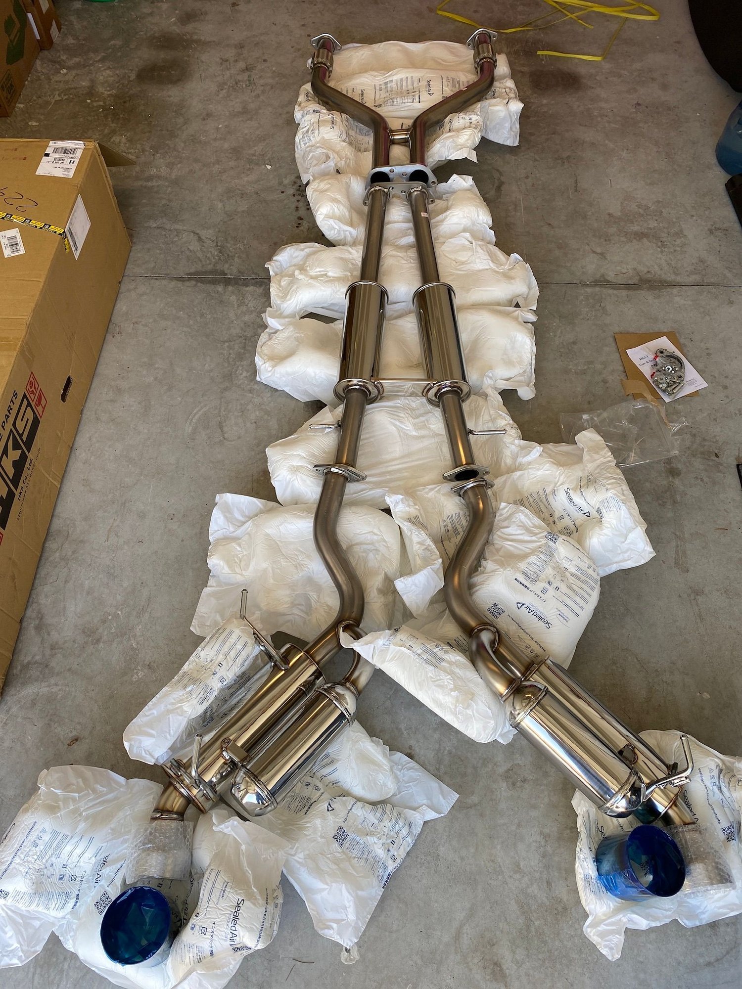

Next was the exhaust. As much as I loved the factory exhaust note of the VQ37, it just wasn’t loud enough, and didn’t sound as clean, crisp, and aggressive as the previous G35 sport coupe exhaust I had. So it had to go. I spent days researching and watching videos, to finally settle on the HKS Hi-Power 60mm cat-back exhaust. It took 8 months to come from Japan, but the wait was worth it. Amazing quality, and I did not have a faulty H-pipe like some have reported (makes me wonder if some were ordering/receiving fakes and thinking they’d gotten a true HKS). I like how little rasp it has throughout the rev range, and how clean it still manages to sound.
HKS Hi-Power + OEM spoiler installed.
