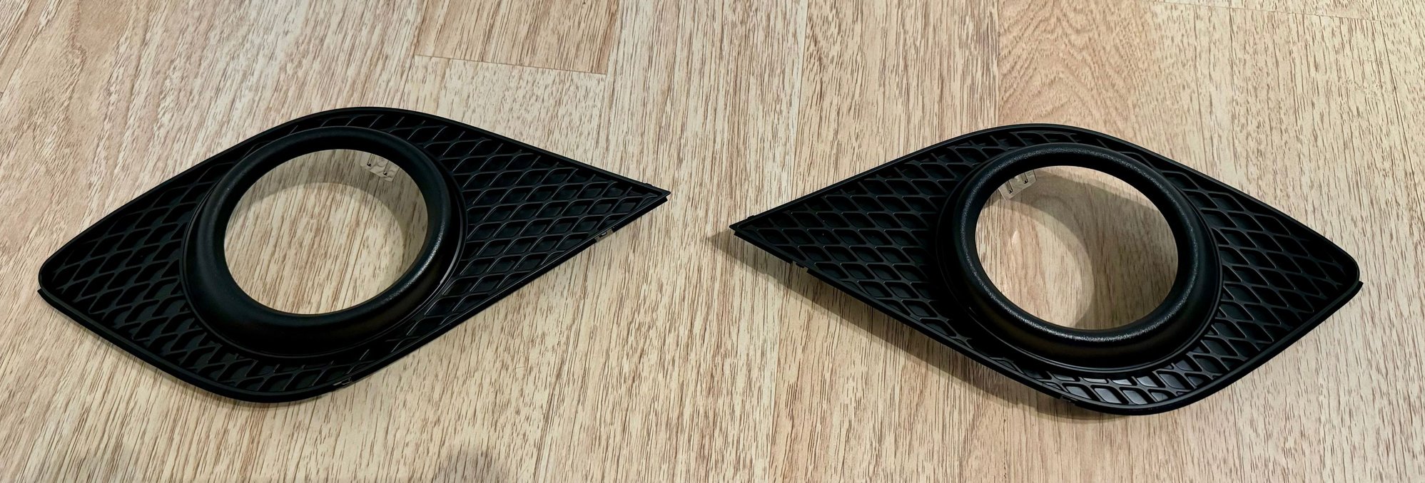

Plasti dipped my new bumper fog light surrounds while the new bumper is waiting to go on. With yellow fog lights it will look 10x better than the chrome, IMO.
Did about 7-8 coats of dip then 3 coats of glossifier. I taped off the clips before painting. I didn’t want them to get gunked up and have a hard time clipping back in.
Edit- had to redo them because of the glossifier coats. PSA do not use plast-dip glossifier unless you want everything imaginable sticking to it- it makes the dip extremely tacky. I thought it was just me, but I've read elsewhere glossifier essentially ruins it because of the tackiness.

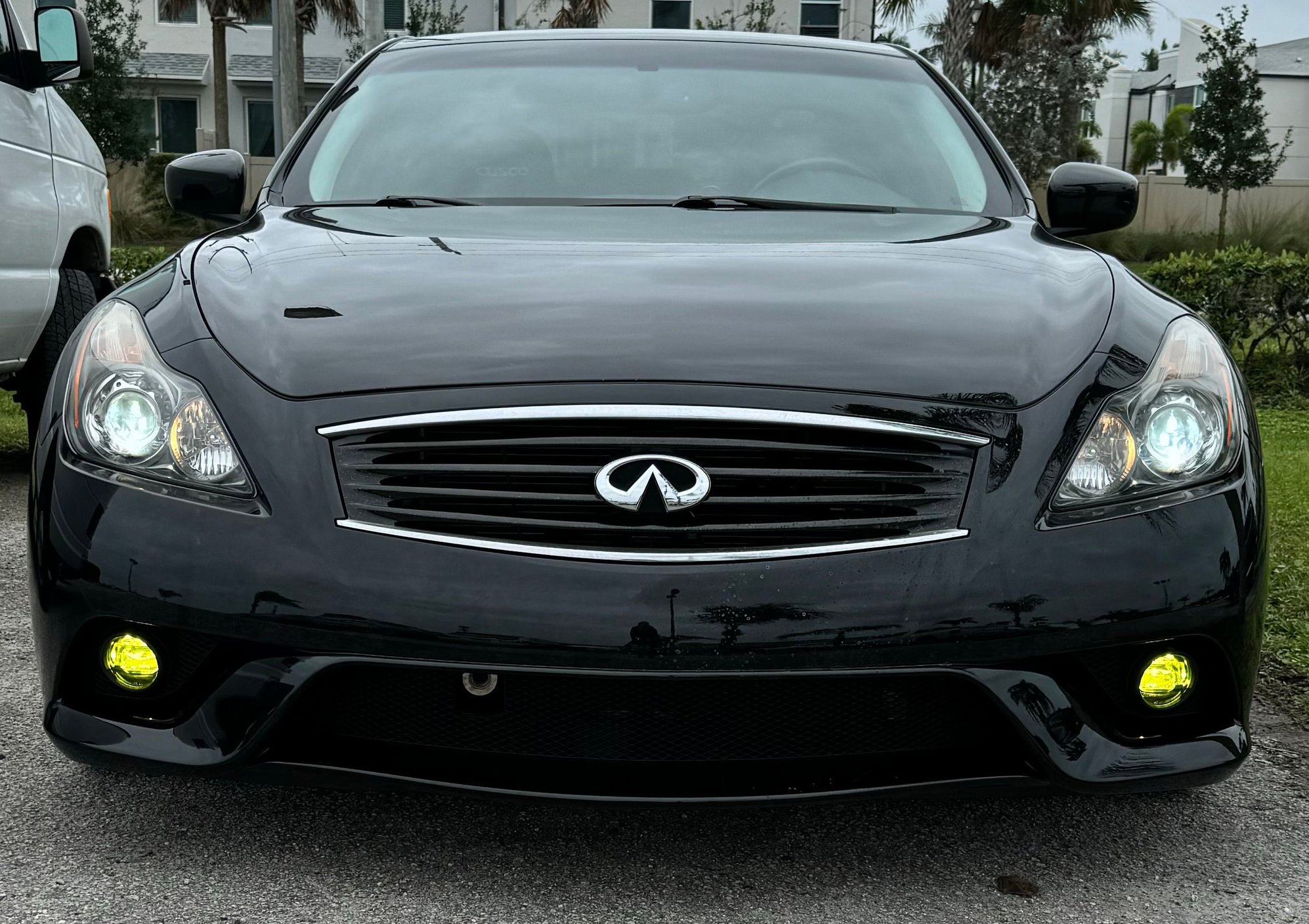

New OEM sport bumper got finished getting painted at my shop and looks great. I'll install it this Friday or Saturday, just waiting on the upper bumper trim seal to arrive in the mail. The seal isn't included with the sport fascia (or the sport fascia conversion kit from Z1) for some dumb reason and has to be purchased separately. I also broke one of the clips on my driver-side bumper fascia bracket after pulling my bumper half a dozen times so I have a new one on the way. Panel gaps kill me.
The OEM coupe upper front bumper/fascia seal part number is 65820-JL01C for anyone else looking for it.
Curious to see how the plasti-dipped fog light covers and Morimoto fog lights covered in yellow Lamin-X film end up looking. Hoping the fogs don't need too much adjustment. If I hate the yellow, I'll just peel the film. Same for the dipped OEM chrome fog light covers. Easy fix.

Forgot to grab one of it actually installed so I’ll grab one later when the weather is better here. But here’s the new painted OEM sport fascia before I popped it in.
For anyone else installing Morimoto fogs you do NOT need to use the additional wire they supply. Plug and play. I still need to adjust/raise mine up a hair but they look a lot better than I was anticipating. Honestly makes the car look younger.

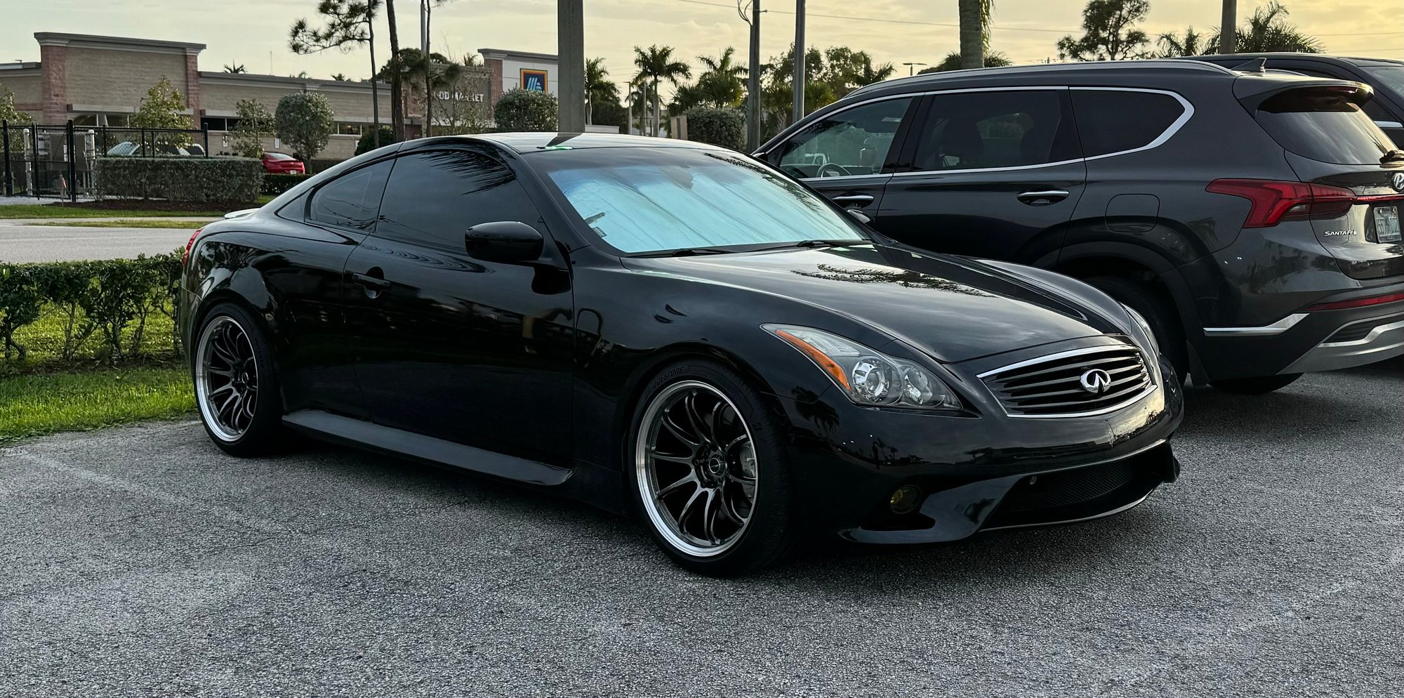

Thanks for the kind words. In the wonderful words of Babs Pewderschmidt, “It was the right thing to do” swapping back to the OEM sport bumper.
I’m sure you saw my aging weather tech shade in that picture- a new sunshade is on my shopping list. I actually tried a covercraft before I bought the weather tech and the covercraft had bad fitment for my coupe so I returned it. I’m not sure if it’s improved or maybe I got sent the wrong model, but it looked like the correct model number to me after checking when I saw it didn’t fit well. I think I’ll grab the Z1 sunshade they just released since it looks to have perfect fitment for the coupe and essentially a copy of the covercraft.
