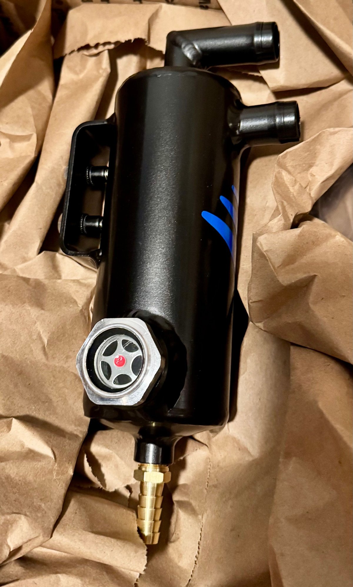

A shot of Mr. Saikou’s new sight glass for his catch cans, for anyone curious. Gorgeous quality, definitely going to get another set for the G37 eventually.
(This is the OCC for my BMW)
