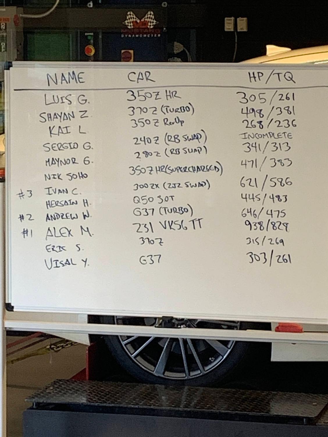

I don’t think it had a passenger seat (full roll bar if not tube frame) and I was just there for the show day.
