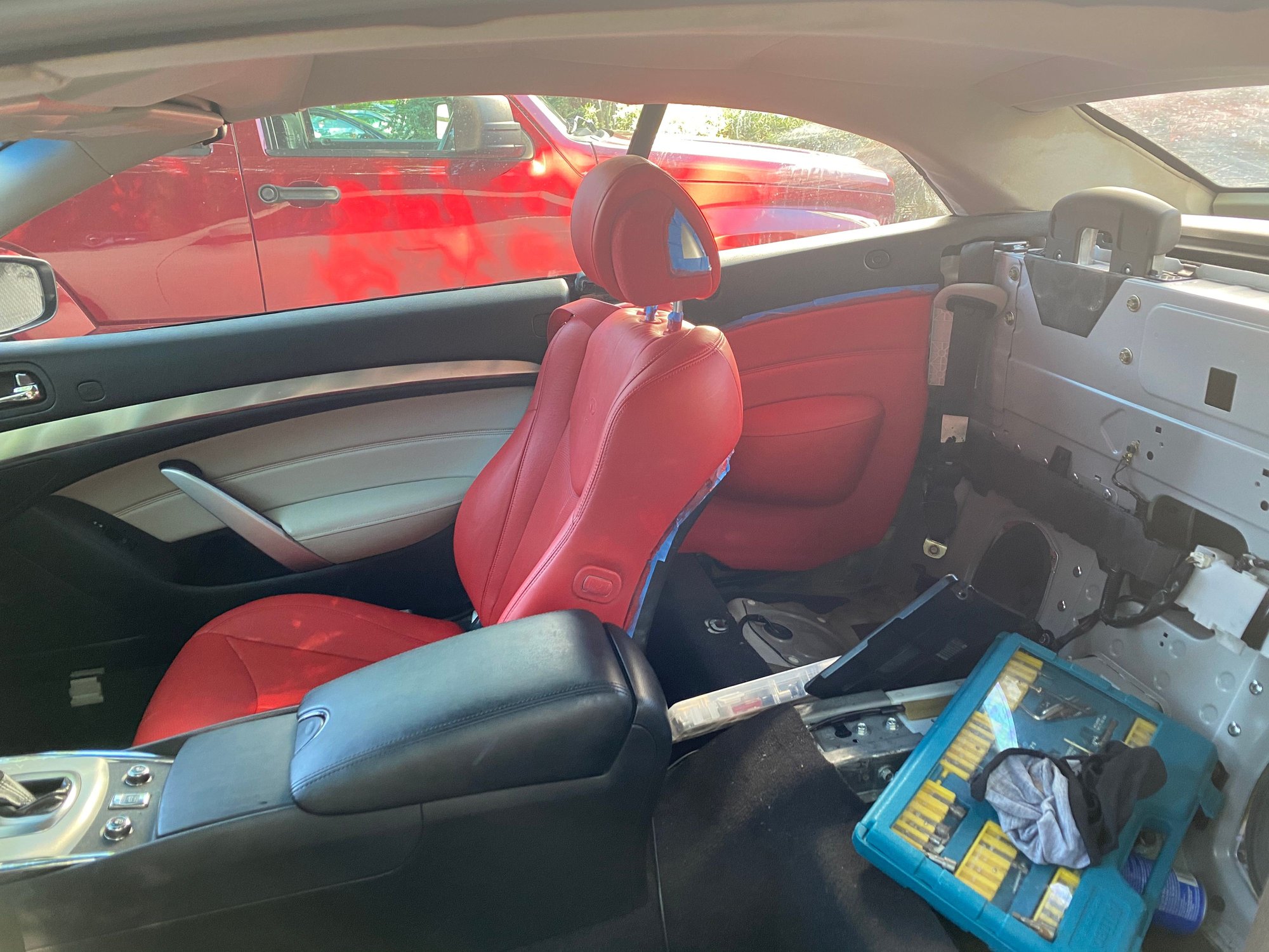

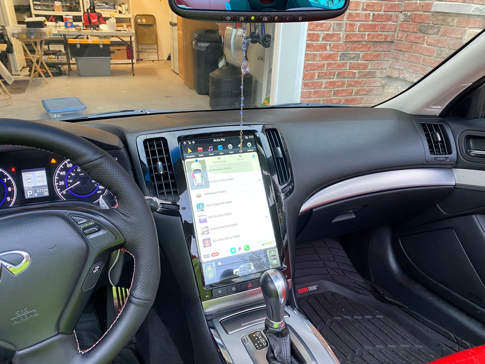

Since I purchased it i changed the seat color put front and side splitters. changed tires and brakes. changed all the trim. magic erased the headliner. got a new stock shifter. took out the outdated radio set up and put in the tesla screen 13 inch one. only one compatible for the convertible apparently.

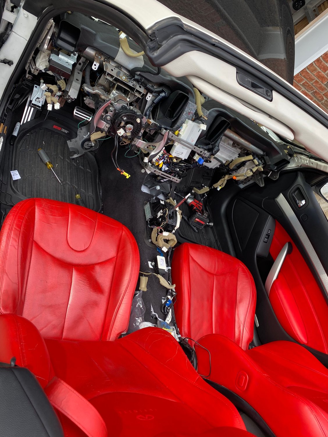

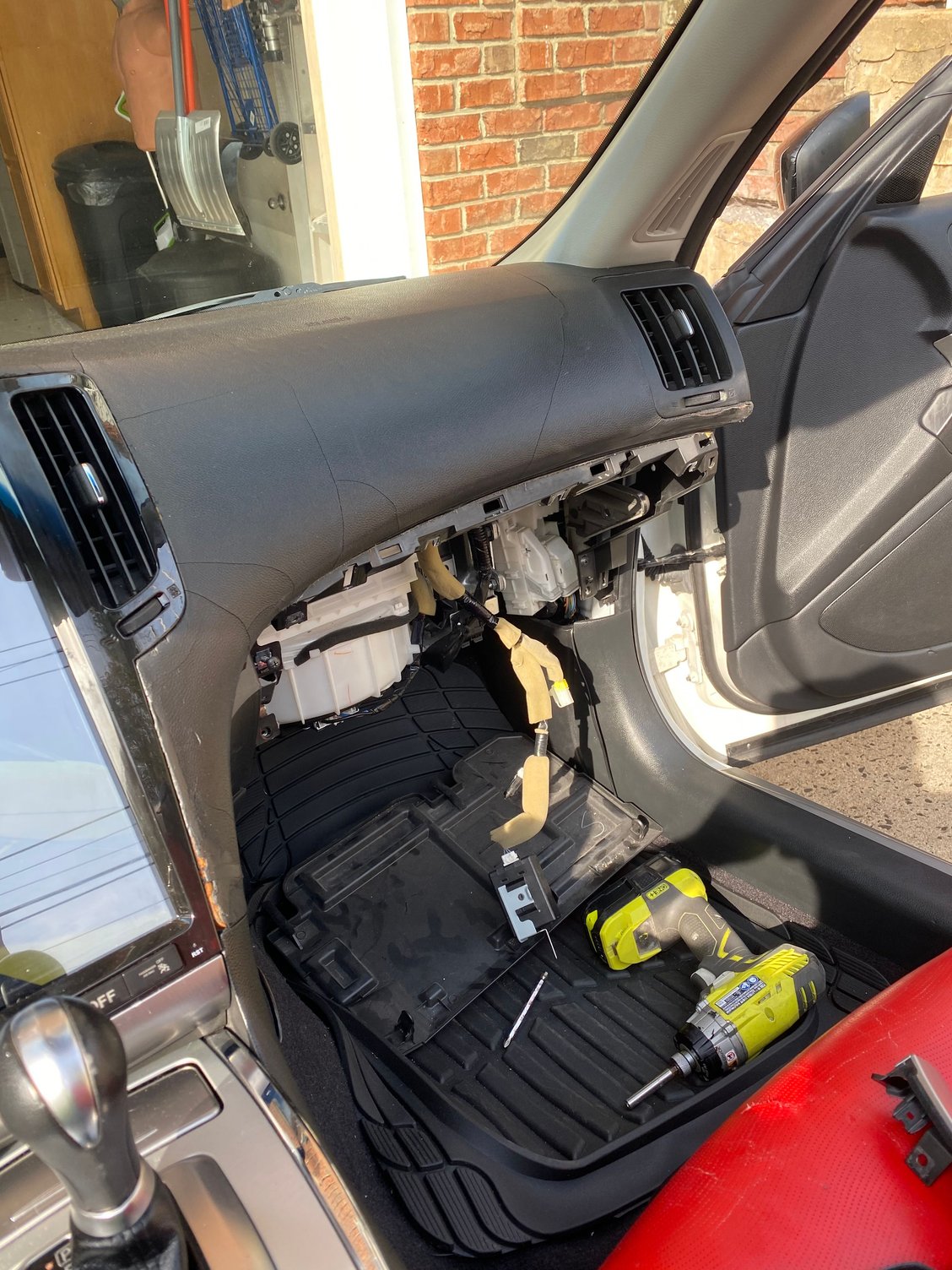

up next is replacing the whole dash board so that the inside is as close to new and stock as possible. ran into an issue with tpms because i bought the wrong model of course my luck so i’m waiting on the correct model to come. i also bought the sport pedals and the paddle shifters just to give it that sport feel even though it’s not. I will update this thread as I keep going but here are a few pics of how everything is so far.

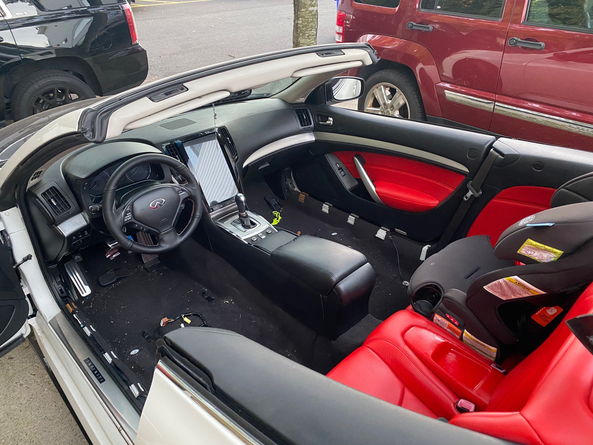

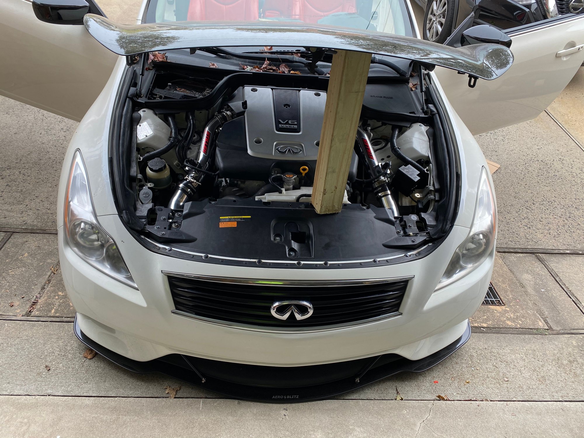

Hey everyone thought I’d post some updates.

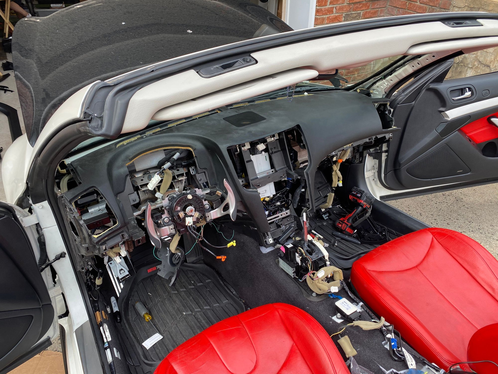

I swapped out the dashboard like I said I would. I finally replaced all trim pieces with some new pieces on the interior.
I also swapped on my injen short rams for the stillen gen 3 long tube intakes.
im looking currently for the stillen 504402 model cat back exhaust to get that on the vert without having to modify anything.
I just ordered the fast intentions test pipes to pair it with the Stillen cat back. Due to covid their lead time is like 3 months but that’ll be the next project once it comes in. Pretty much wrapping the projects up until winter is over.

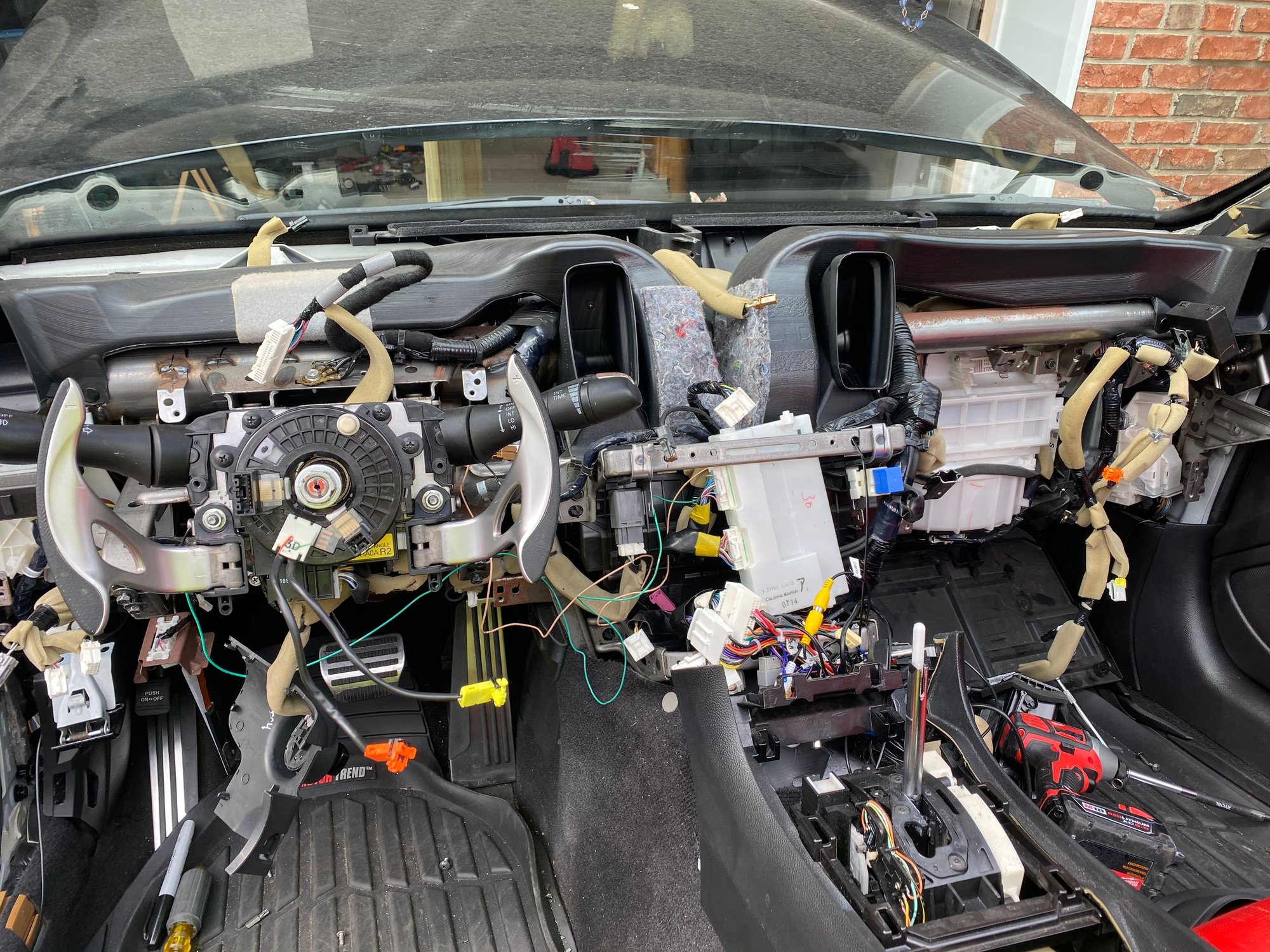

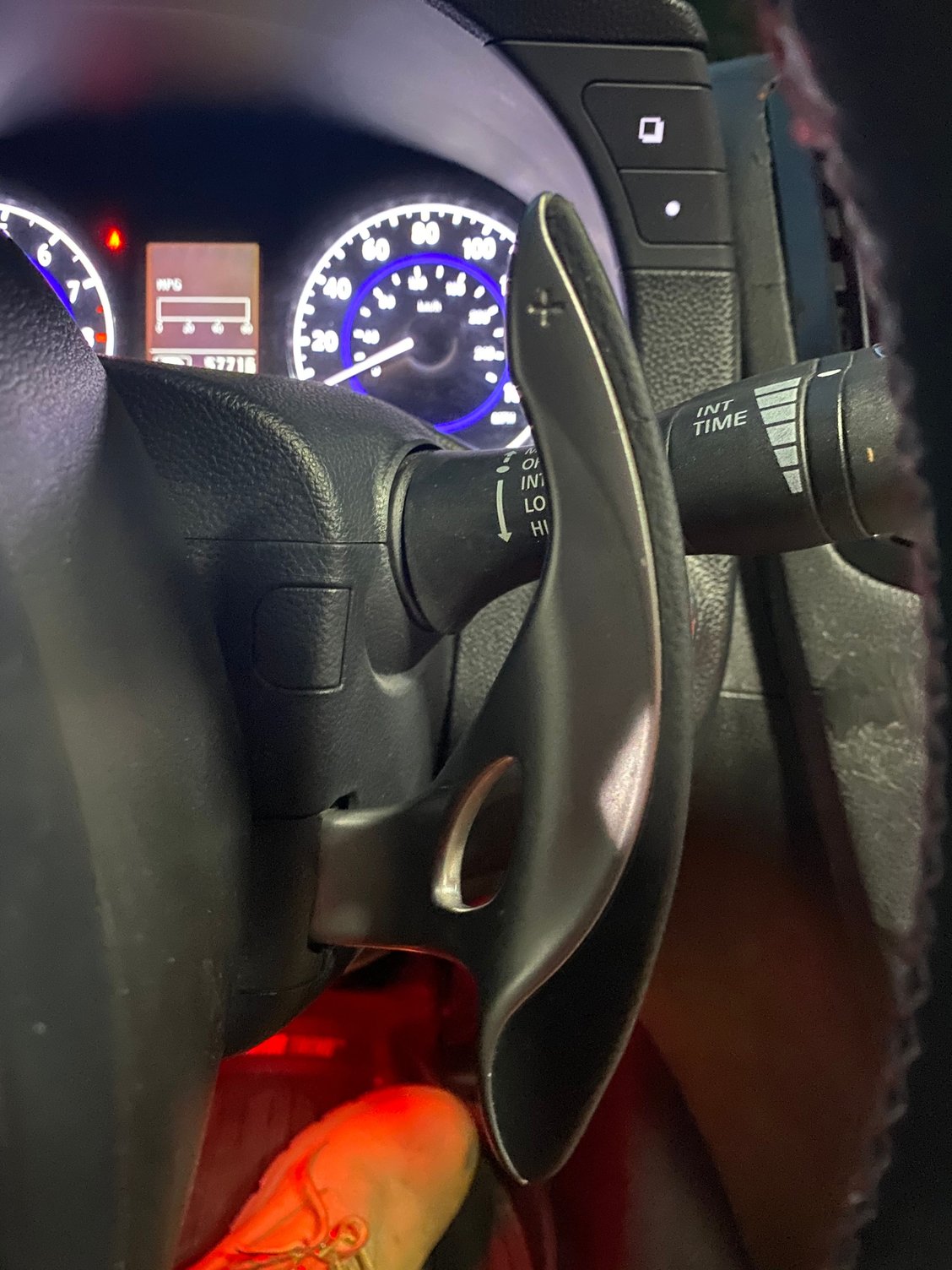

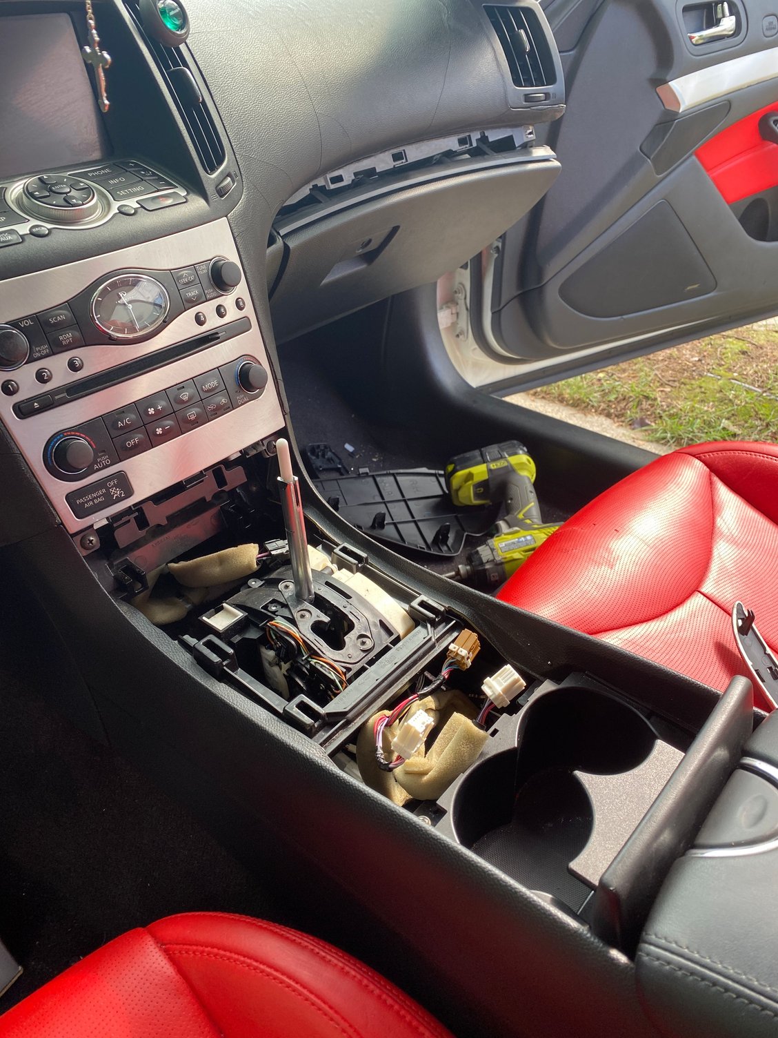

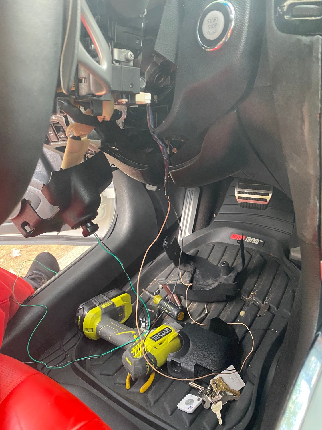

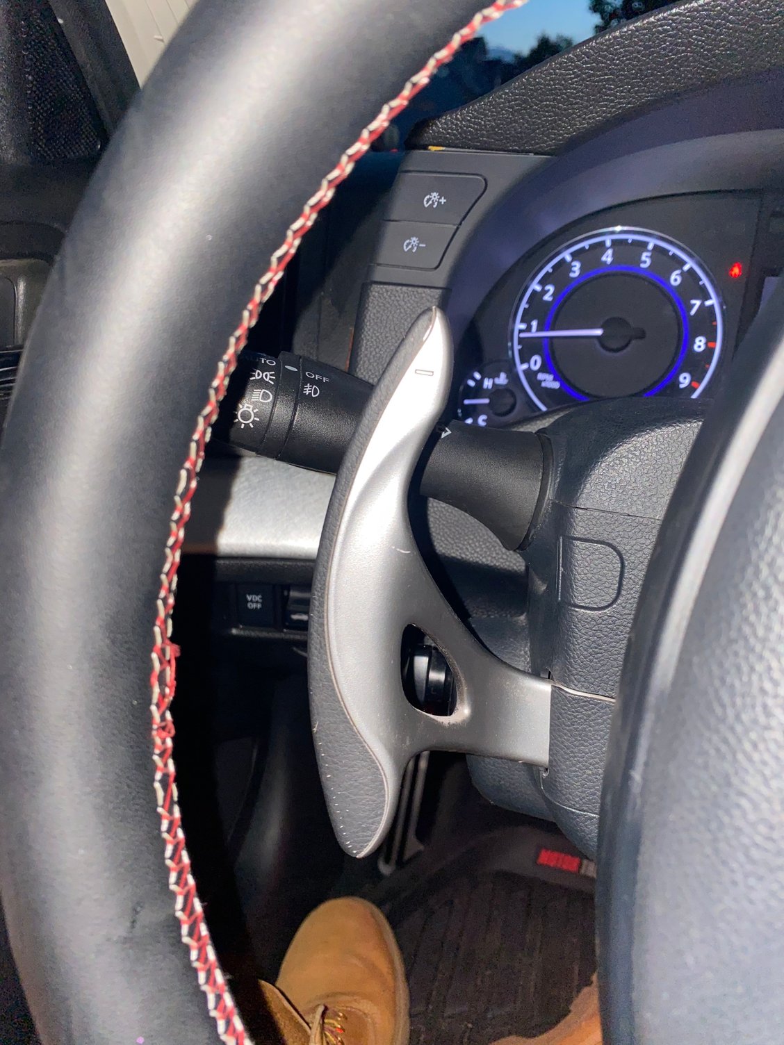

I also did an install of the paddle shifters. A big huge thank you to ILM-NC G37S from this forum to literally walk me through the install and sending me the required wires to wire this car due to the fact that my convertible was not already pre wired.

Glad they worked out. If you're enjoying them as much as I am enjoying my heated wheel... then all is good.

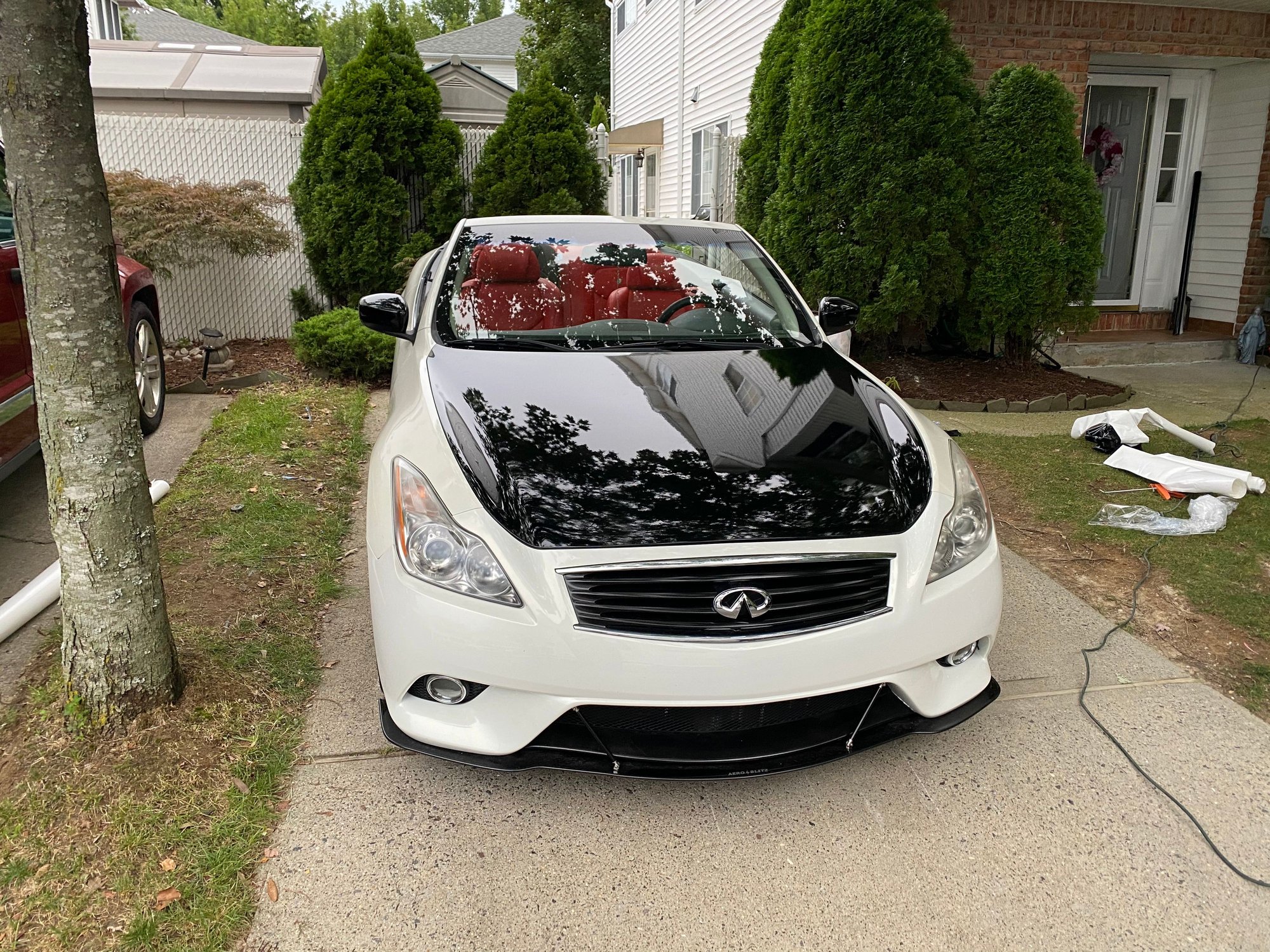

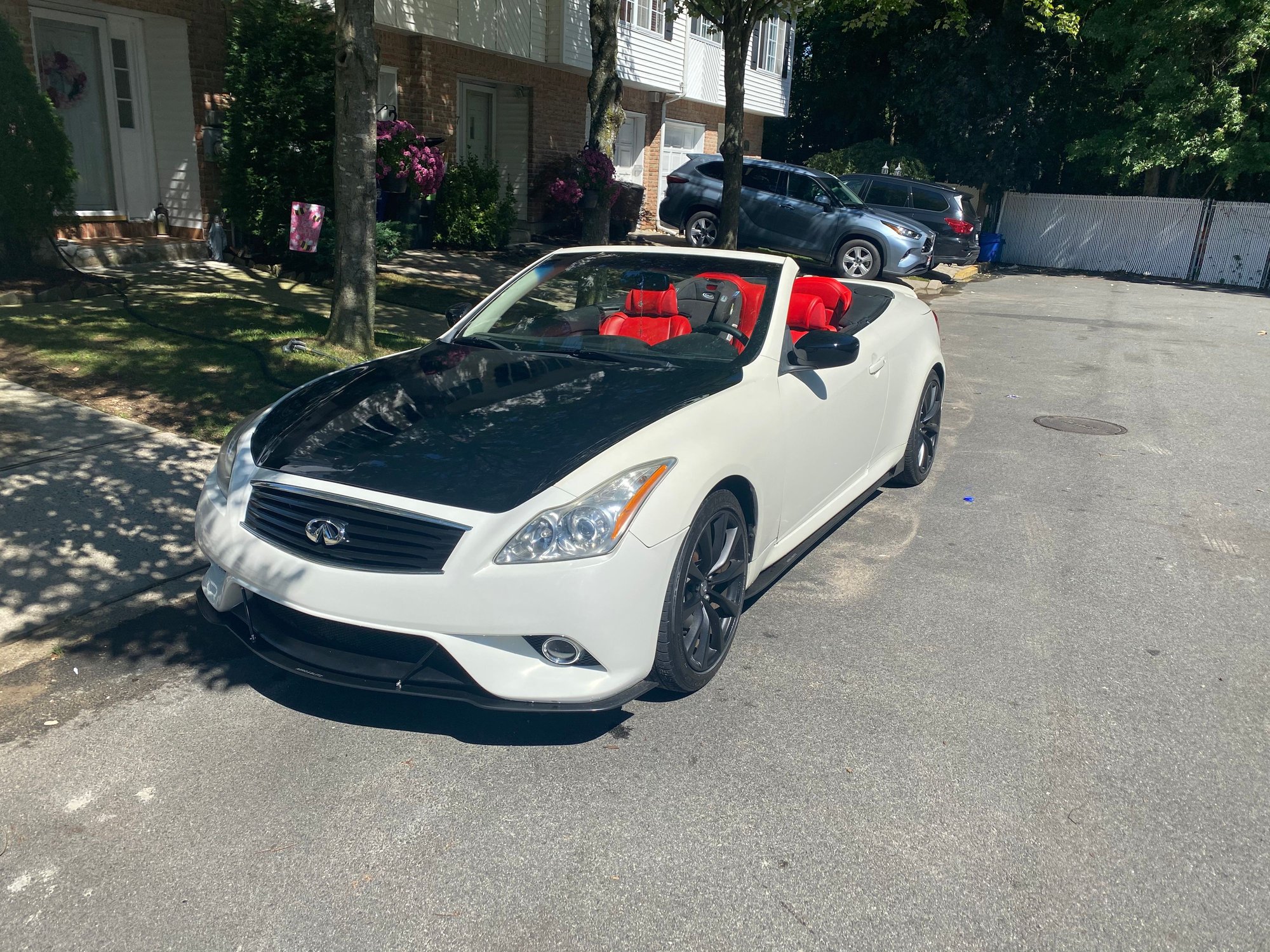

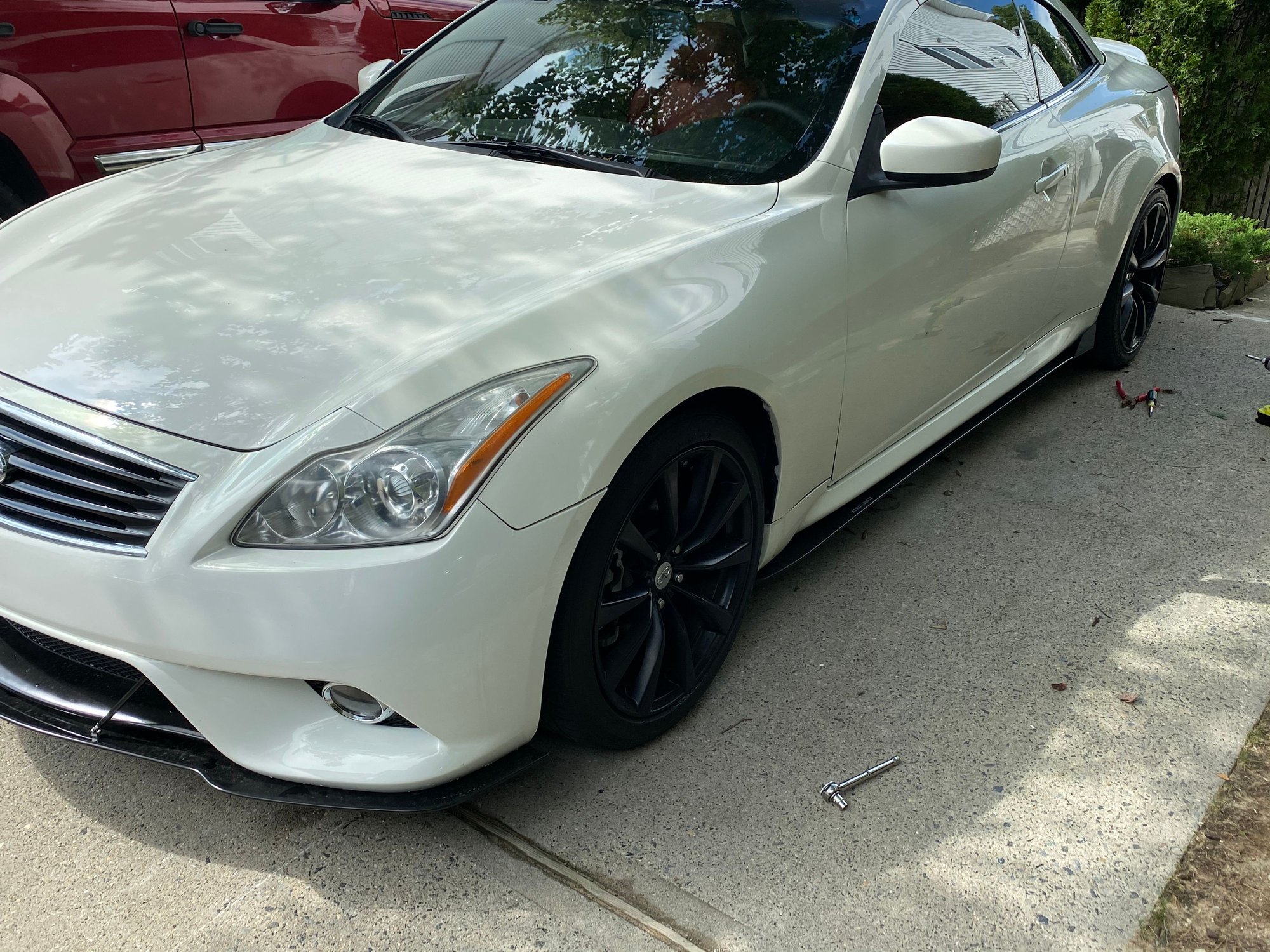

What's with the hood? Is that CF, or did the girls dent the original and you're waiting on paint?
Love the black detail work on the center of the front bumper. Bright red leather, black trim, white car... BAM! That's a pretty combo.

Rochester thank you and to answer your question yes the girls did scuff it a bit but not bad. I test wrapped gloss black to see how I’d like the color and come early next year I’ll be re-spraying the whole car black. Not wrapping I don’t see the sense in a wrap if I’m doing a basic color.

don’t get me started on those seats. One of the most intricate things I’ve ever done in my life.

White to black, huh? That's brave. BTW, sure is cool seeing that tesla-like screen when leaning into a Vert.

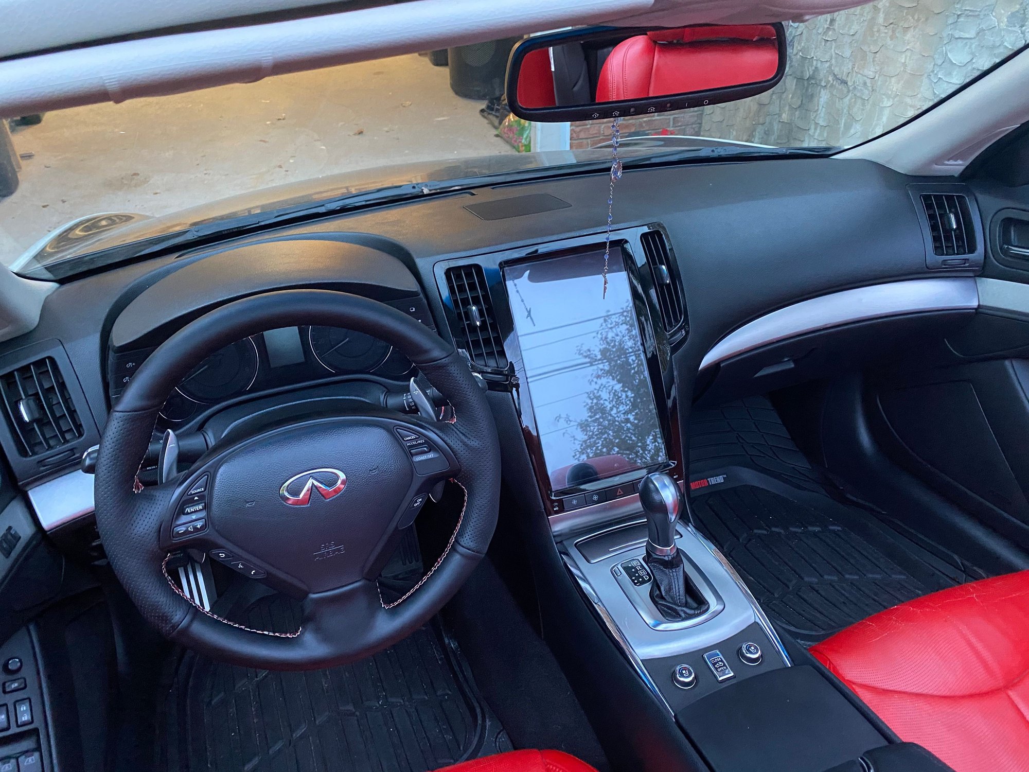

the Tesla screen was definitely worth the buy. My only complaint which is no fault to the makers is that when that top is down and the sun is shining you can not see a thing off that screen. It’s cool though when my daughters friends come around I tell them this is her car and let them play Super Nintendo off the screen 🤣

For the screen you could look into a sunshade screen glass just like the ones they make for phones. As long and the measurements are correct and the screen is flat it should work

not sure if you seen the car seat there but let me tell you it’s so easy taking my 3 year old out and putting her in when that top is down lol easier then my truck.

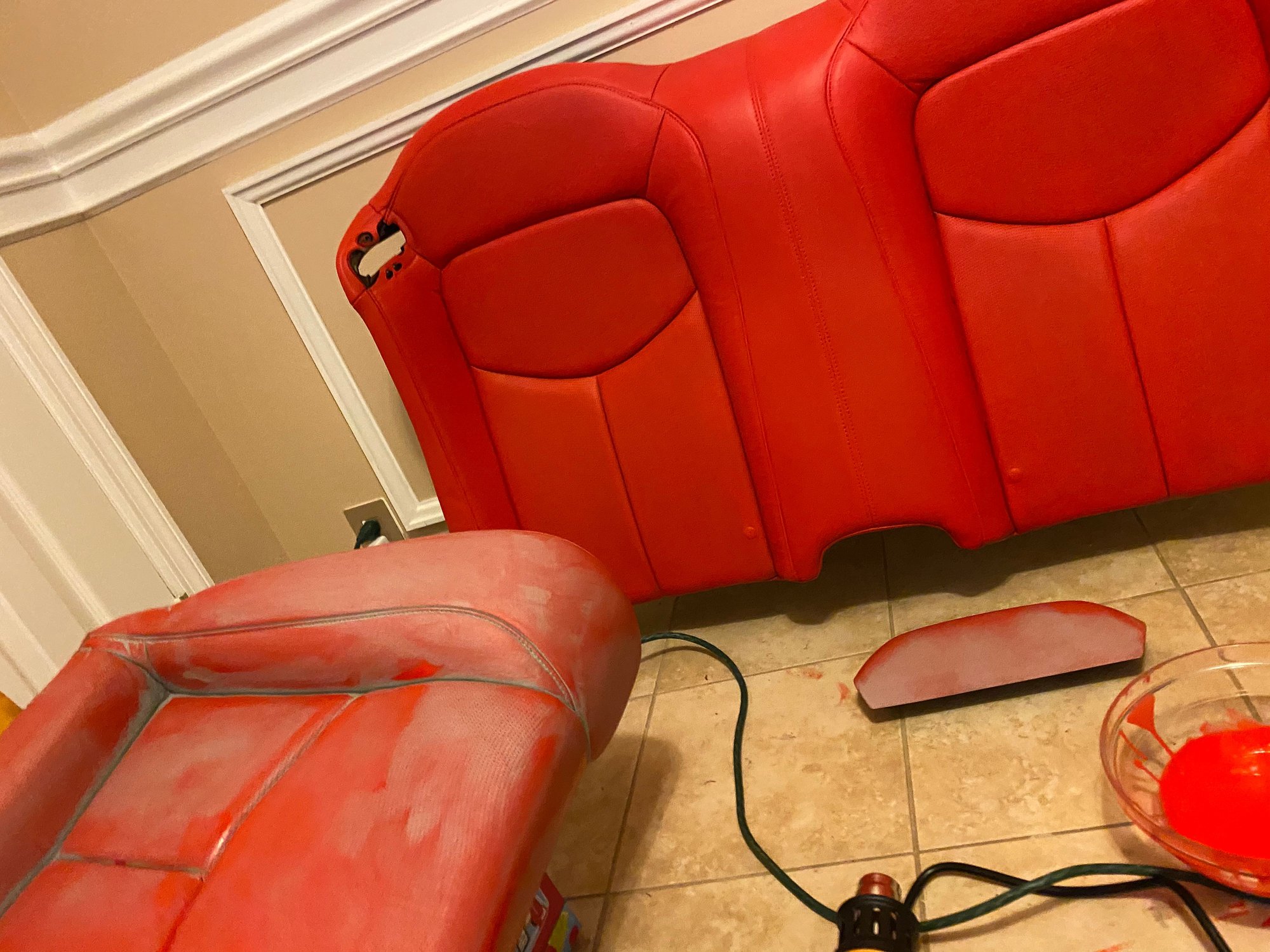

seats are holding up very well which is a pleasant surprise. I did my research before I pulled the trigger on it. Auto leather dye seemed to be the best option rather then spraying it down which would’ve probably rubbed off in a week. It was meticulous sitting there for hours with a small sponge brush and heat gun laying coat after coat. I think I was at around 10 coats before I was happy with the results.
The sunshade glass actually is a great idea didn’t even think of that I am going to look into it and maybe just cut it to size if they sell a big enough sheet.

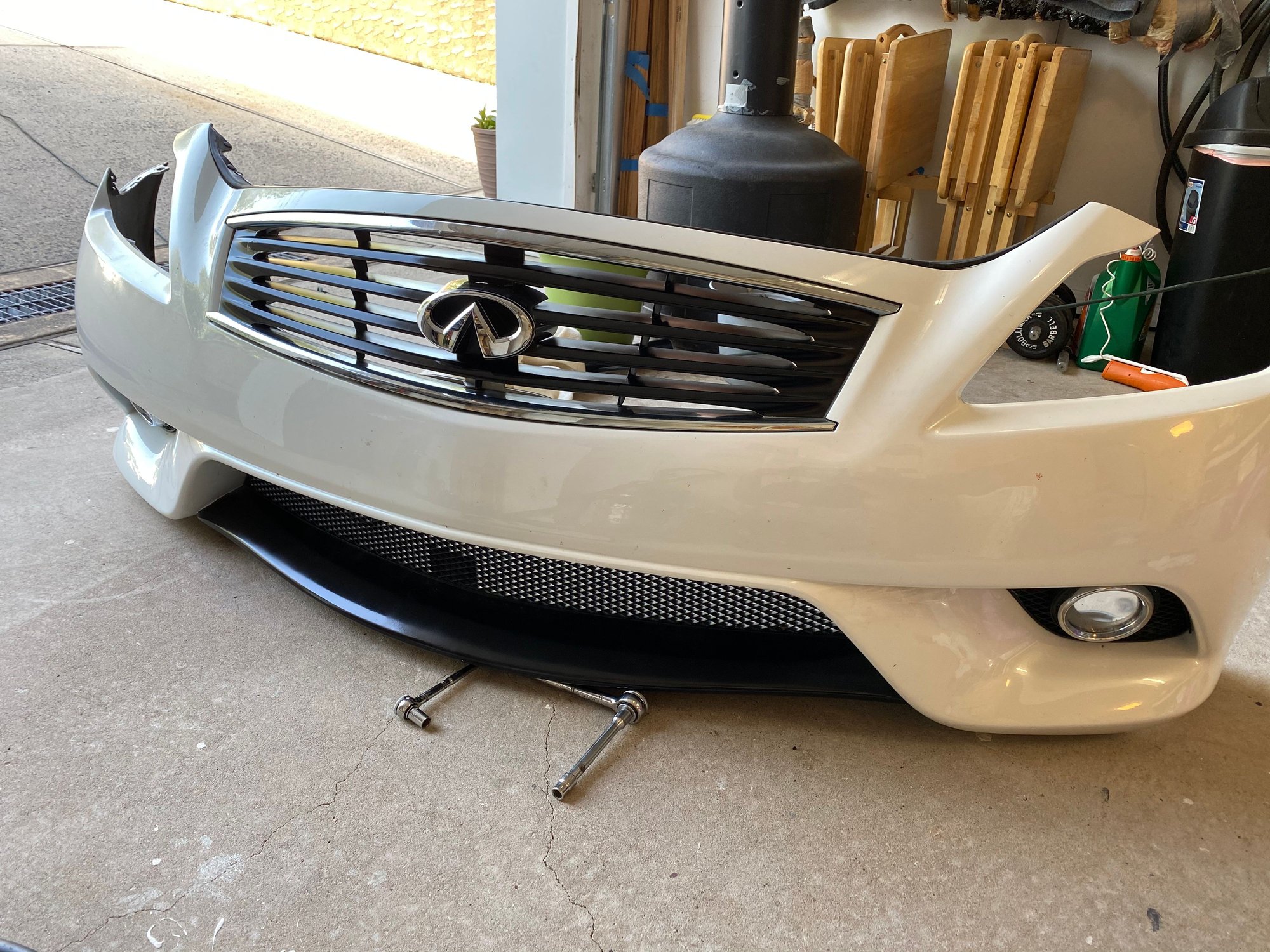

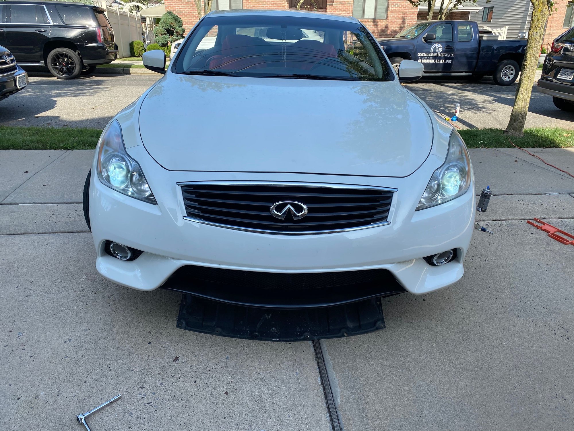

Here's a whole bunch of IMO comments on that...
IPL side skirts... absolutely..
IPL rear bumper... nope. Looks fat and silly.
IPL front bumper... I'd keep your modified sport bumper. Looks better than the IPL.

appreciate the thoughts but few things the ipl side skirts for the vert are impossible to find I been looking for a year now and have called every junk yard across the country and inquired with dealerships even though I rather chop off my arm then give them business.
front bumper is easy to find but are a bit pricey so not only that I’d have to change out my front lip which I did drop 220 on so financially wouldn’t make sense.
correct me if I’m wrong but aren’t the vert rear bumpers the same across the board from ipl all the way to base ? If they’re different they look pretty similar. I even tried to look for a rear splitter but of course none are vert specific and need modification and if it’s one thing I learned through my years modifying an already aftermarket part is rarely a great idea.

I went on auto leather dye .com and bought their Maserati red option. I tried to do the stock Monaco color that the ipl’s came with but that wasn’t an option on that site. Overall I’m definitely happy but to a true g owner you know off the bat that it isn’t the stock Monaco color.
Yes I painted both, I sanded the center tray down then dyed it. That part was giving me issues so I hit it with 10+ coats and then hit it with clear coat to seal everything in. That’s why it looks a little shiny. I will say though it’ll definitely come off if scratched. When the weather starts getting a little warmer I’m going to revisit that just some imperfections that **** me off but you wouldn’t notice at a glance. I will say if you’re going to start this venture dedicate at least 12+ hours to disassemble and lay 10+ coats with a sponge brush. I used a heat gun to speed the process up but still took me a while to do it.
