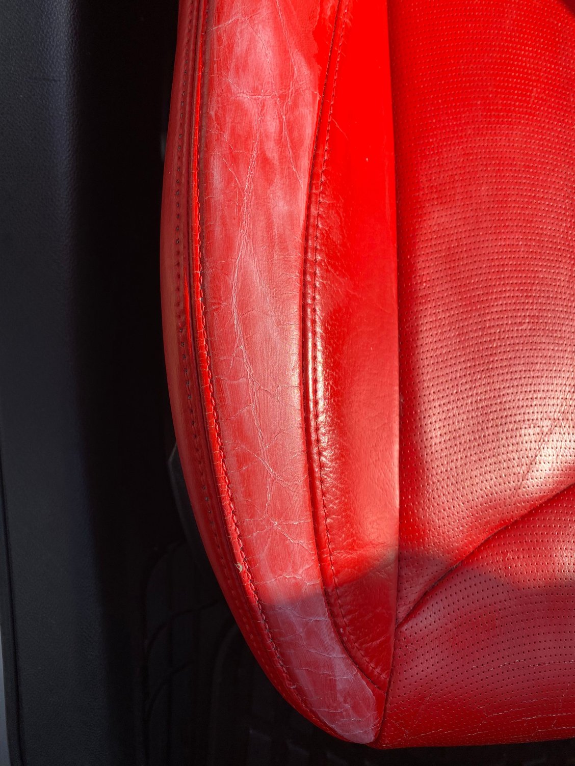

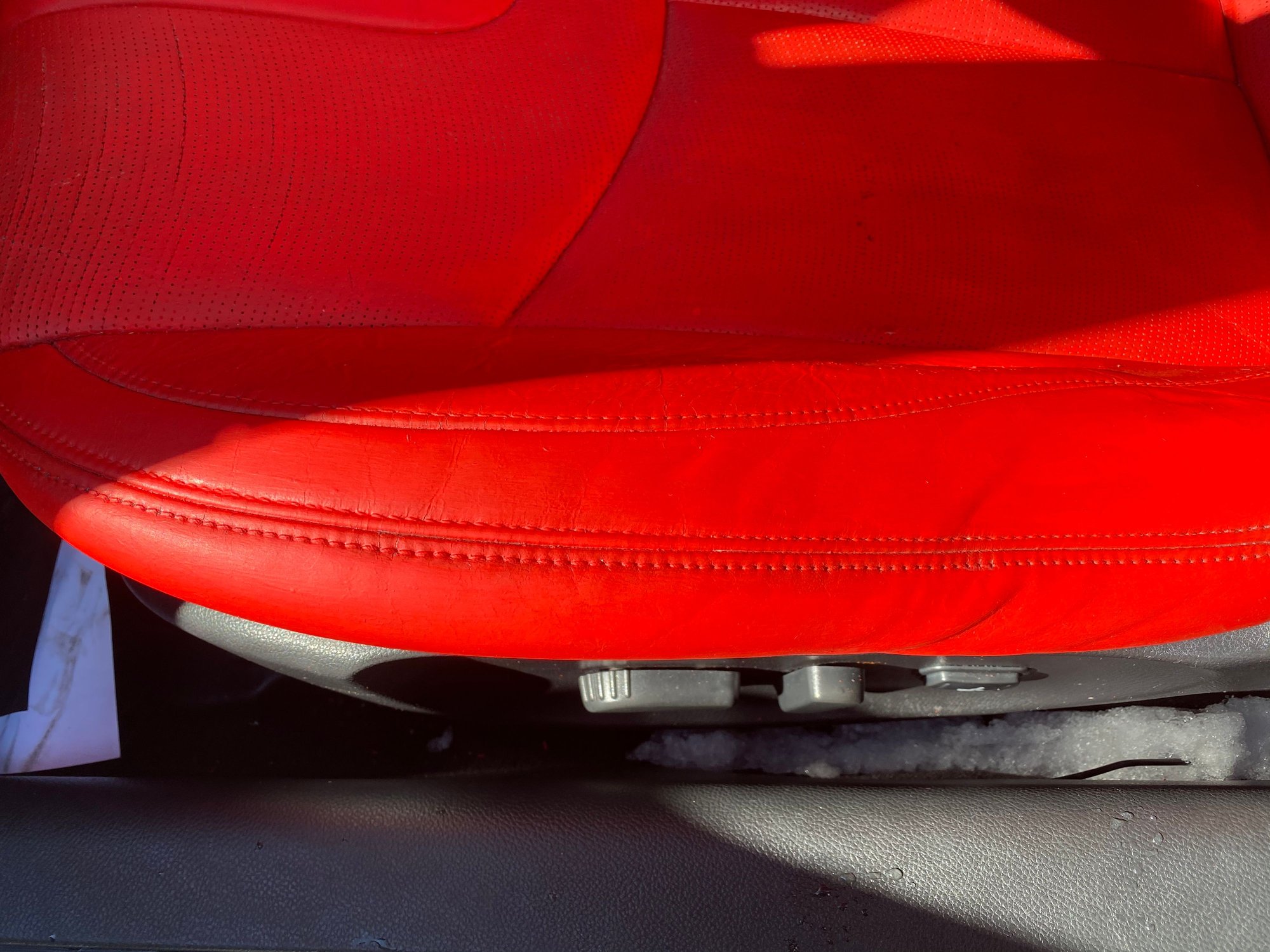

now on to the fun stuff. So as you are all aware I have dyed my seats. Did it I think august of last year. Someone did ask if the dye comes off. Well after about 7 months of light use. Yes the dye started pulling from some problem areas. What I mean by problem areas is the areas that had natural leather cracking or bending. The company advised I use this leather repair solution to repair the cracks and bends then re dye. After doing that I added about 3 layers of top coat with a satin sheen rather then a high gloss. Looks more oem in my opinion. Been in and out of the car to test durability so far so good. I am attaching before and after a of the outcome. I will say though for anyone that is thinking about doing this buy yourself a paint gun and a compressor and do it that way. Sponge brushing a whole interior not only takes longer I’m in this project at least 20+ hours but runs you the risk of not layering properly I’ll show some examples of that as well.

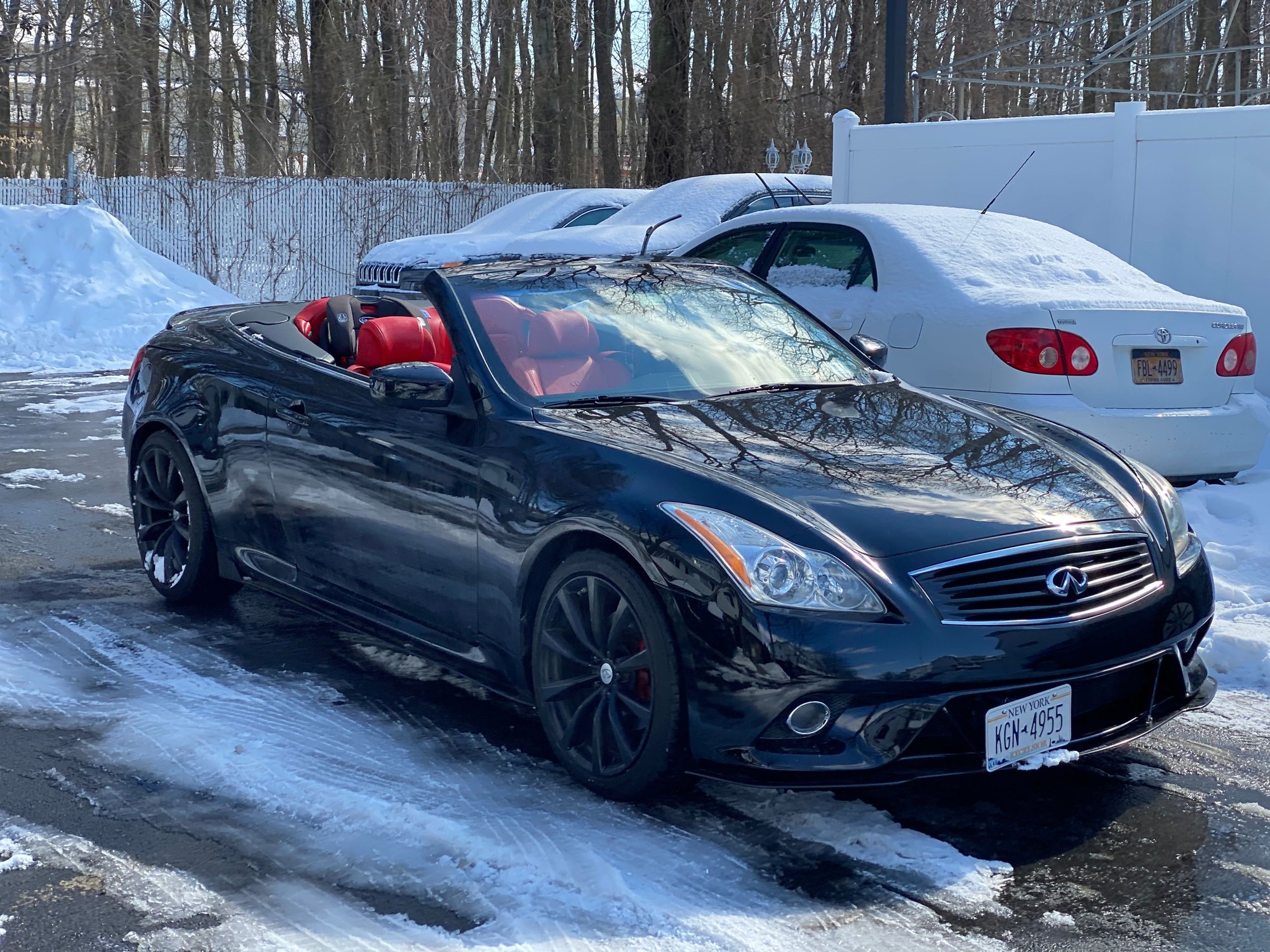

It’s been some time but since the last post I finally got the fast intentions test pipes on the car finally! They sound amazing paired up with the Gemini cat back I have on there and butt dyno approved for sure.
just doing some minor things here and there just to dress her up and bring her back to her former glory. I know it’ll never be back to how it was when it was brand new but I’m getting close.
